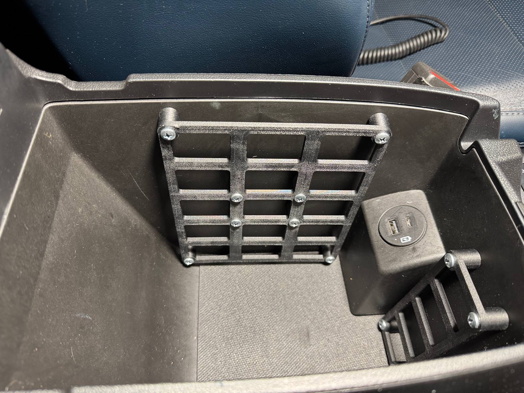

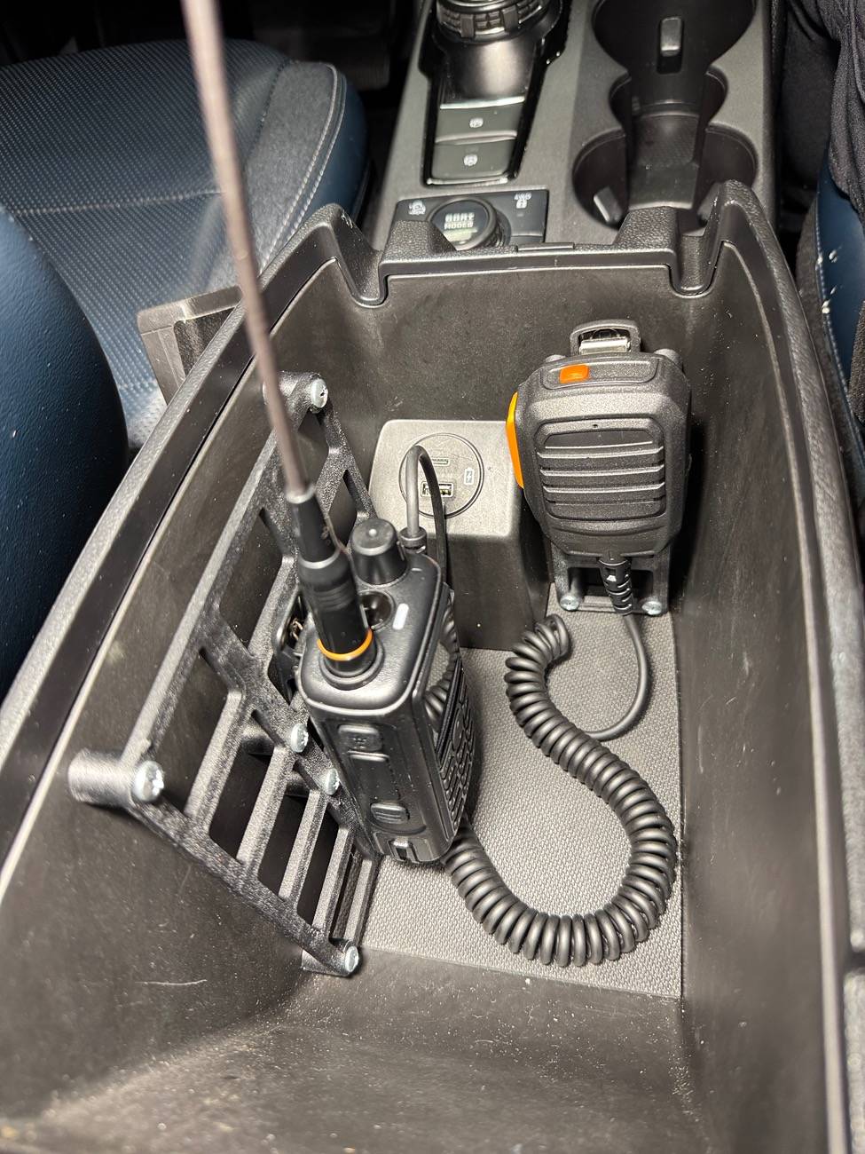

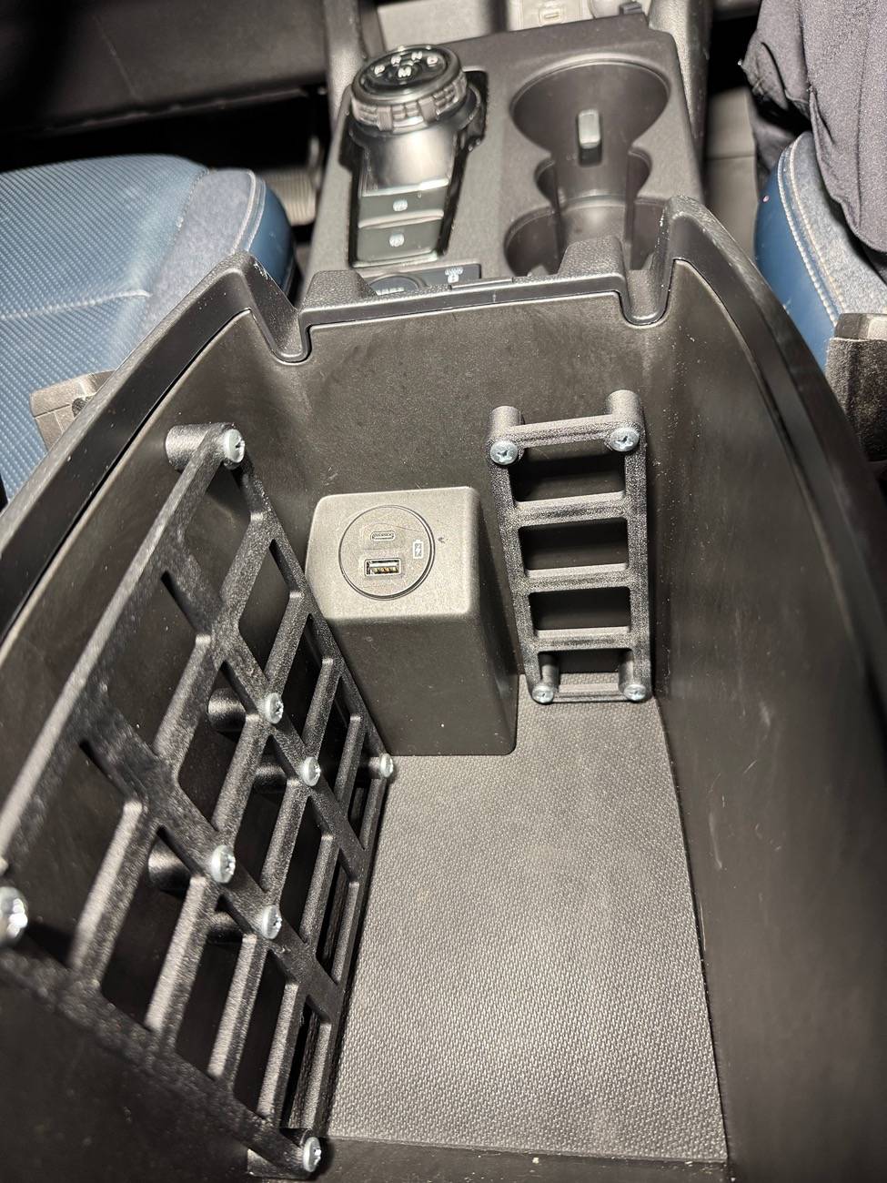

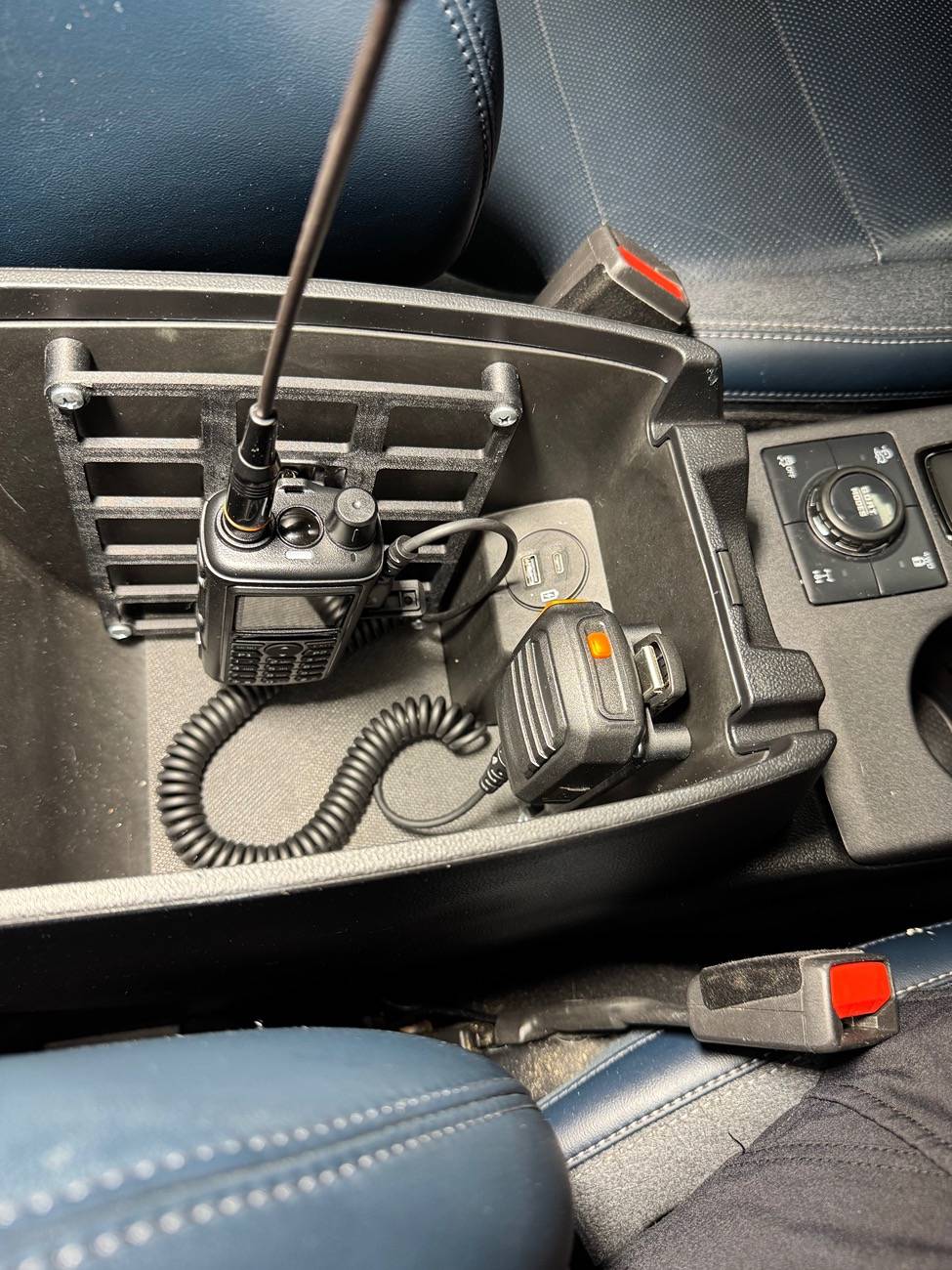

Howdy, it’s me again! This time I wanted a mounting solution for inside the center console. Namely, I wanted a spot to secure my GMRS radio and its handheld in a spot where it can charge, but it’ll be nice for anything MOLLE or belt clip compatible. Grabbed some measurements and got to work.
Could I have just thrown them in there? Obviously, but I like my stuff to be organized smh
Does the radio lose range in there? Probably, but it’s negligible compared to being in the car already. I’m only using it for car to car comms so it’s overkill anyway; plus if I need more range, I’ll just pop it off the MOLLE mount and step out of the car!
Designed in F360, 3D printed in CF Nylon. We’ll see how printed MOLLE panels hold up, they should be pretty damn strong but maybe I’ll have them laser cut if they don’t stay durable
