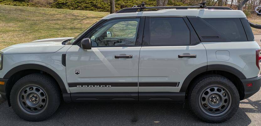

Here is the before picture.
After doing a bit of research I had 18mm tall spacers made and W500761-S439 M14x56mm 10.9 grade bolts ordered for the rear trailing arms to bring the wheel back to center. Most likely not necessary, i just figured it would help with alignment. For reference the RTR 1.3 lift comes with 1" spacers, the Ranger lifts 1.25 comes with 1.25" Trailing arm spacers and a few people with the H&R springs were able to get it into alignment with no spacers.
Currently, my Black Diamond with its usual load (80lbs on the receiver) sits .2" lower in the rear and the gas tank skid has 7.2" of ground clearance without me in the car. I am hoping H & R rear springs will bring this to an acceptable height for fire road driving without scraping the skids without ruining the highway drive.
