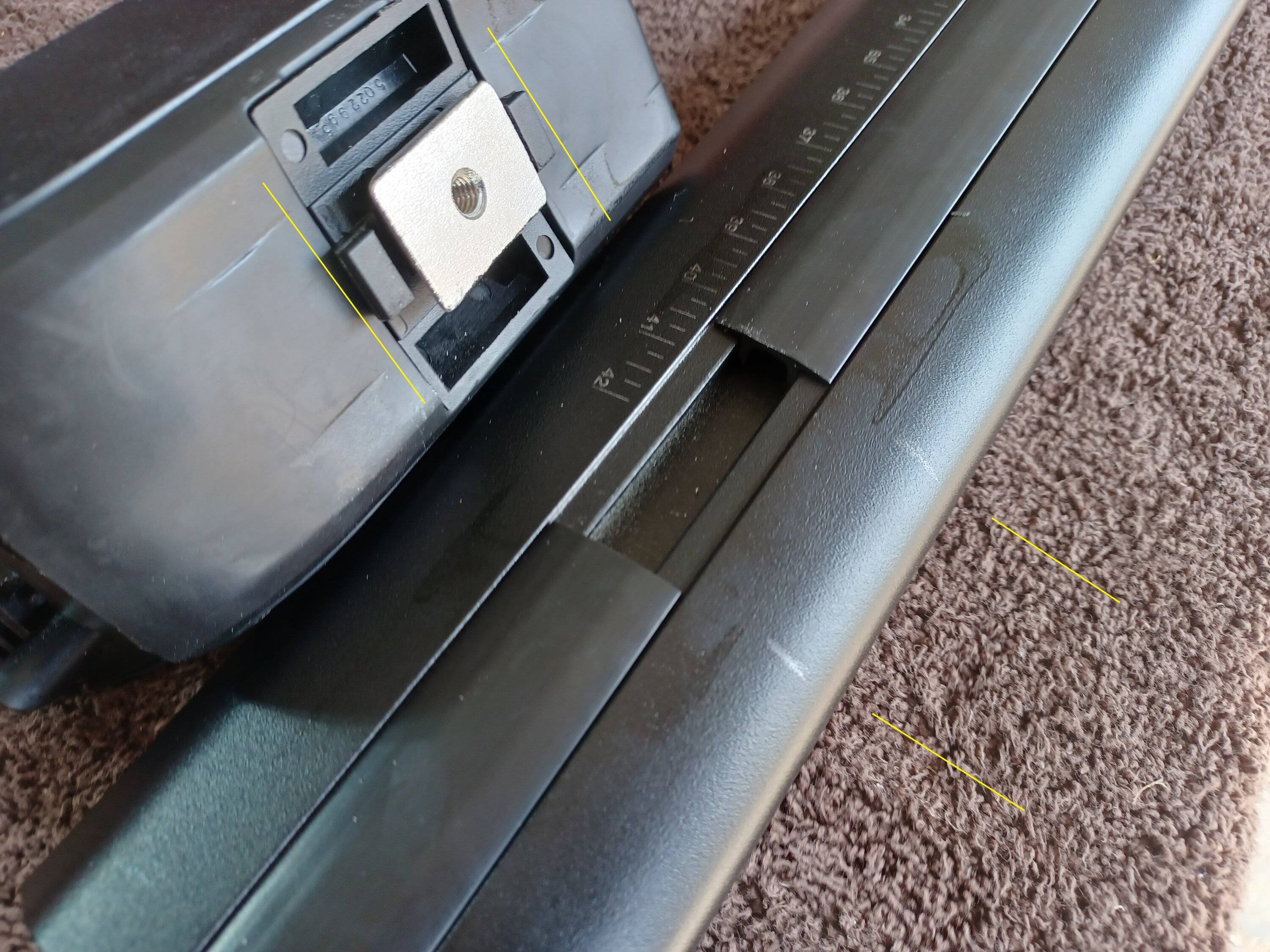

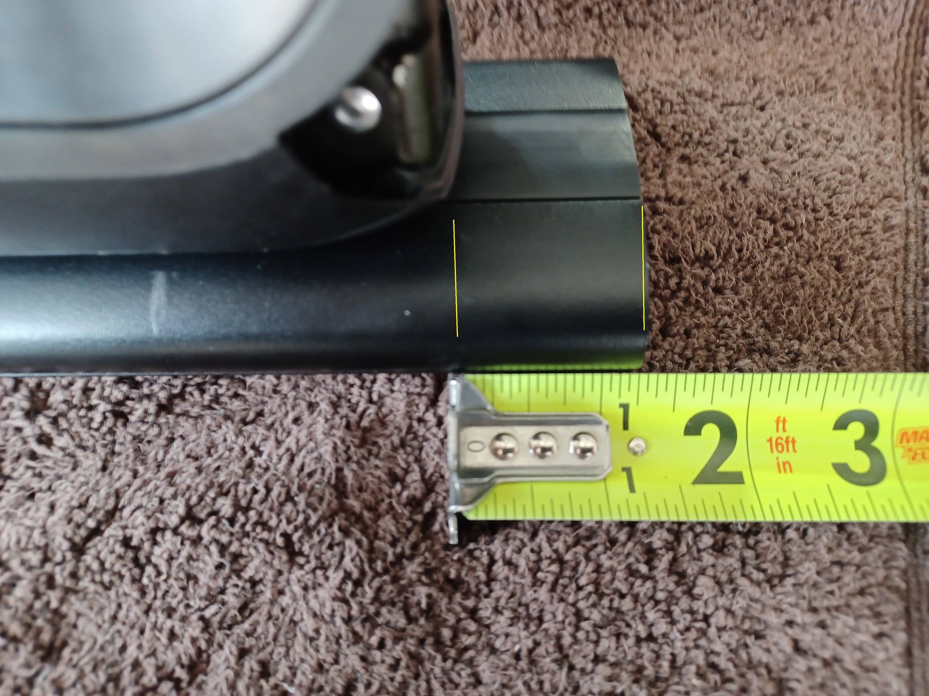

For anyone thinking about getting the Yakima Timberline Towers and the 50" Jetstream bars, here's the measurements I came up with. This is with the Bars mounted directly over the screws on the inside of each of the siderails front and back:
  • The front bars have a 1.25 inch overhang on each side, when measured as shown.
  • The rear bars have a 3.25 inch overhang on each side.
Make some pencil marks where the T-Slot saddle rests, and put the bottom wind-strip in so it's up under the tower. Here's what the 50" Jetstream bars look like mounted, and with the Moonroof open... Hope this helps.
