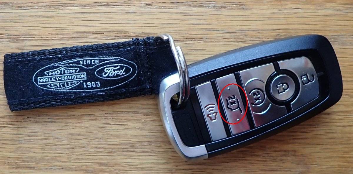

Hi All,
Earlier this week my wife and I bought a BS Badlands with the Premium Package, Co-Pilot360+, and the towing package (surprisingly, that combo was hard to find). However, When looking at the key I noticed that doesn't have the button to pop the back hatch. My daughter has a 2022 Outer Banks and her key does have a trunk button on the key. Do I have the wrong key or did Ford just stop putting the trunk unlock buttons on the keys?

Thank you. Looks like a change from the 22's since my daughters OBX has the button. It's not a big deal at all since it isn't a power tailgate but just seemed weird.

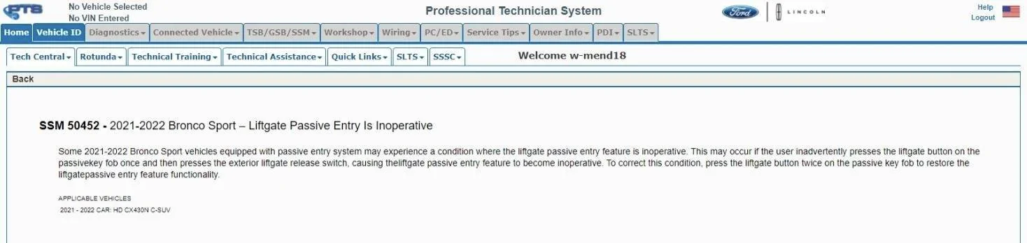

The problem you are likely to encounter is that right side button on the rear hatch which unlocks the hatch may stop working.
Your keyfob which doesn't have the button to pop the back hatch means the following procedure (SSM 50452) will not work to restore the right side button on the rear hatch allowing that button to work.
SSM 50452: Procedure for keyfob with x2 button to unlock back hatch
What might work for keyfobs without the x2 button is stated in Post #40: https://www.broncosportforum.com/forum/threads/liftgate-does-not-open-with-intelligent-access-but-glass-does.3081/

My '21 had it. Ford has been removing features every year since '21.
Ford Bronco Sport Wrong Bronco Key? fob hatch release
