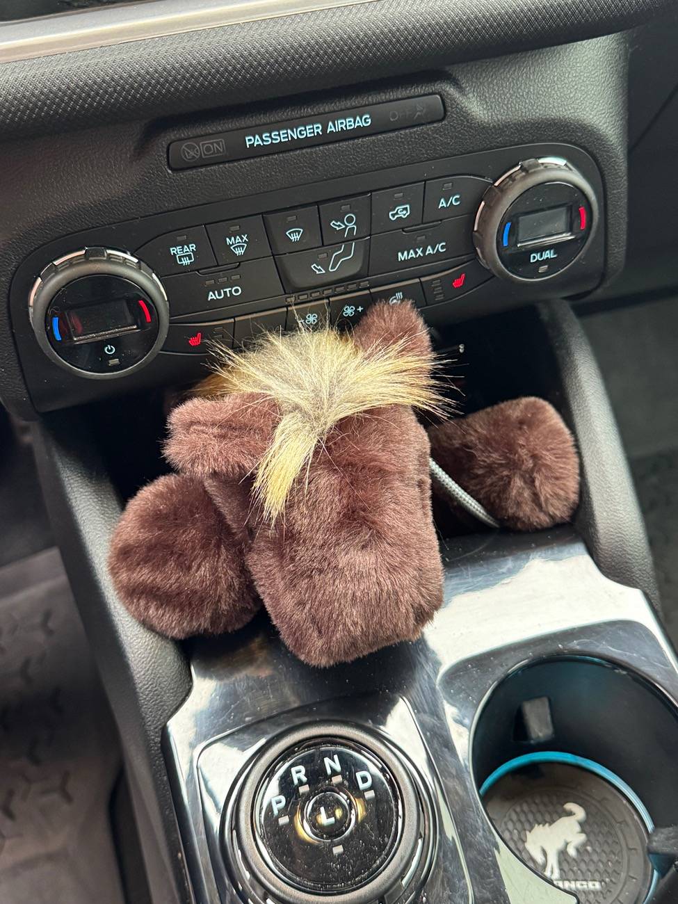

Here’s what I think of the usefulness of the phone charging pad. It’s the stable for a stuffed Bronco! If you look close, you can see the cable I use if the phone needs charging. ?
Ford Bronco Sport Wireless charging IMG_4753
