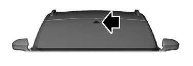

Ford Bronco Sport Windshield replacement 1686175727874
According to my owners manual, in this area it has the camara for adaptative cruice control and my badlands has no adaptative cruice control.
I believe the black spot is just the location where you can further locate the camera/sensor in which it would be behind the spot (behind the windshield at the rear view mirror).
