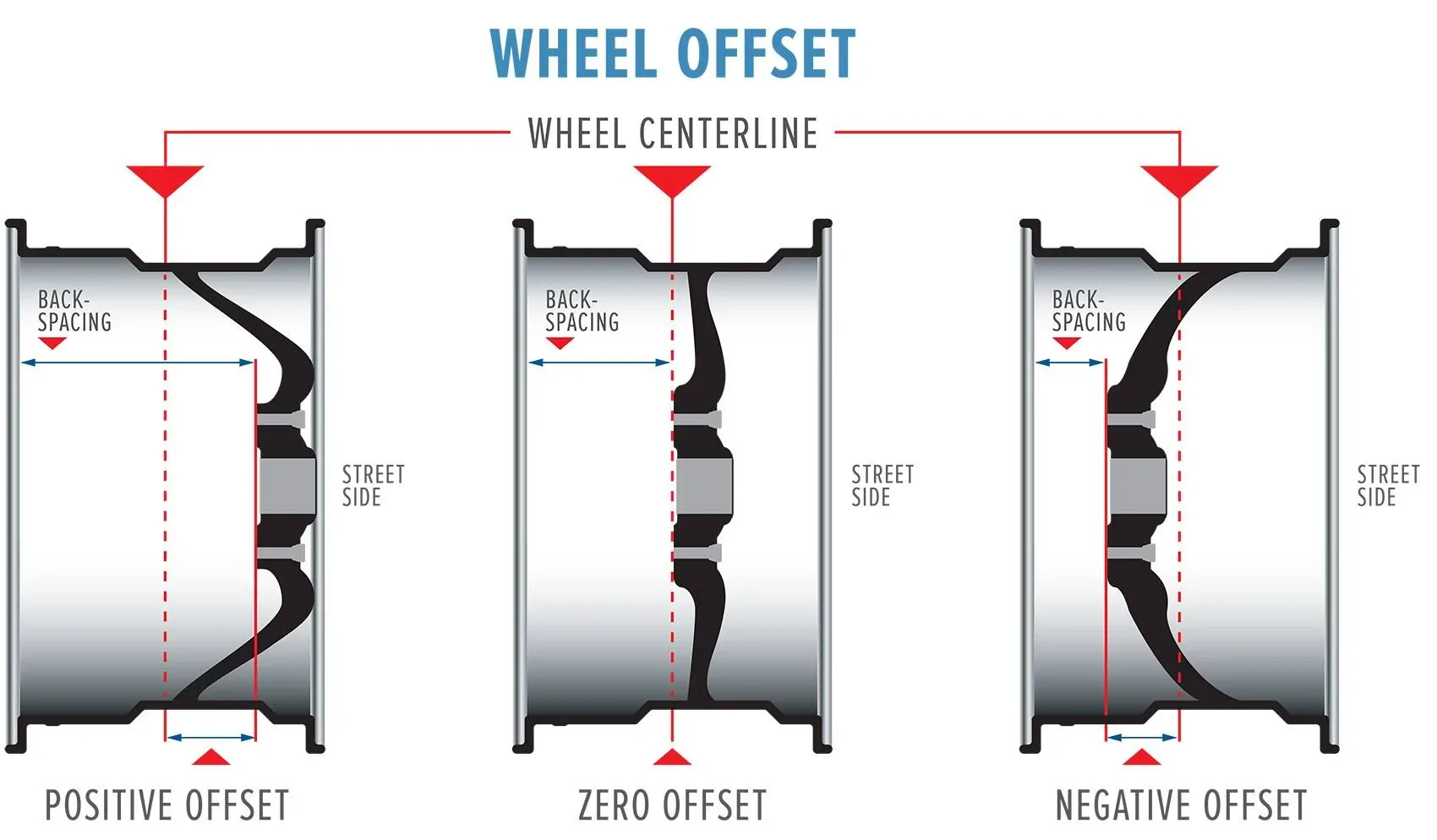

Standard spec is 37.5. if you went 40 I doubt that's significant.
Found this if it helps.
Wheel Offset and Backspacing Explained
Offset refers to how your car’s or truck’s wheels and tires are mounted and sit in the wheel wells.
Zero wheel offset is when the hub mounting surface is in line with the centerline of the wheel.
Positive wheel offset is when the hub mounting surface is in front (more toward the street side) of the centerline of the wheel. Most wheels on front-wheel drive cars and newer rear-drive vehicles have positive offset.
Negative offset is when the hub mounting surface is behind the wheel centerline. “Deep dish” wheels are typically a negative of
Ford Bronco Sport Will a 40mm offset wheel fit with 235/65 /17 wildpeaks? wheel-offset
fset.
