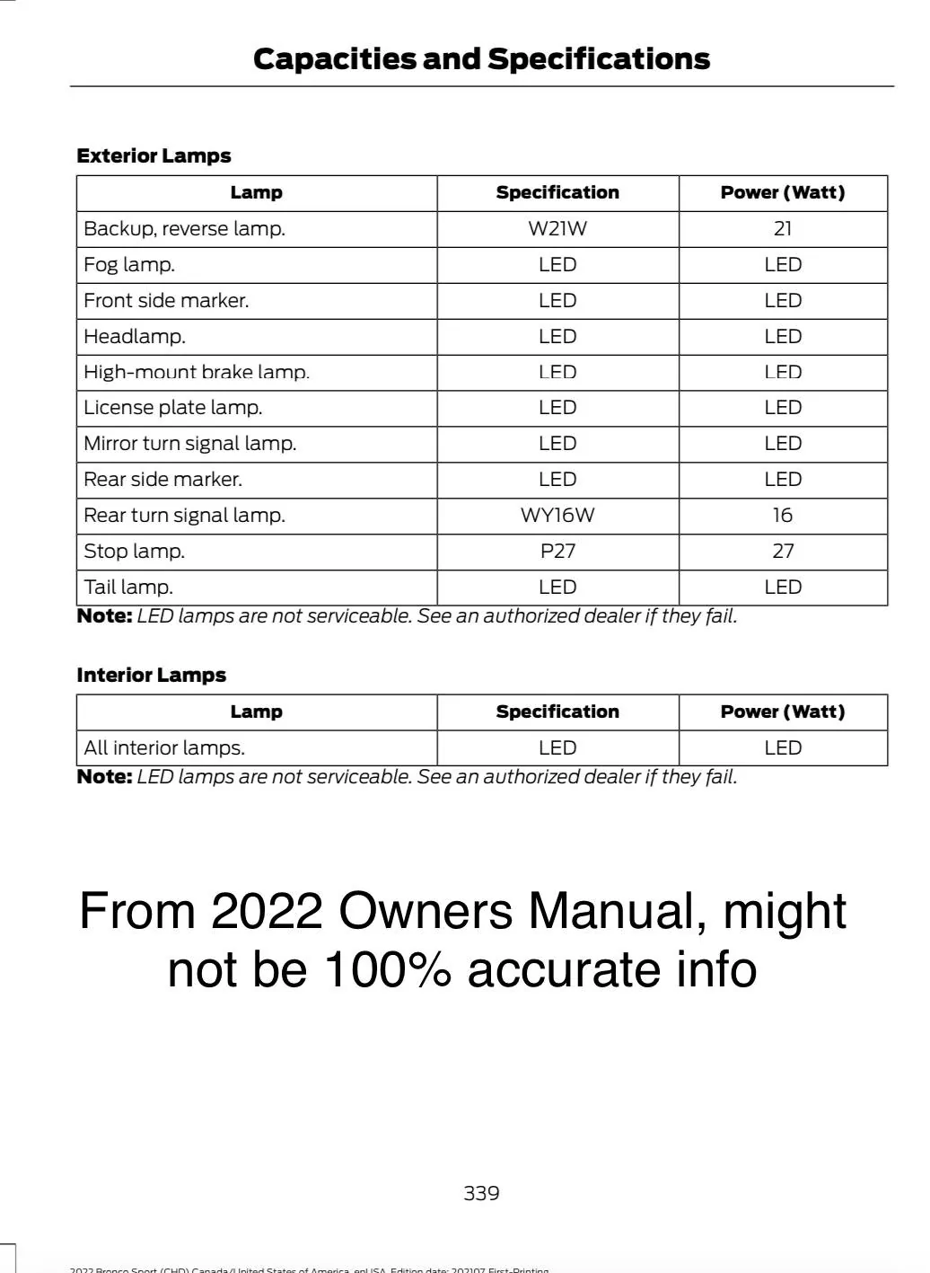

Actually, I believe the stock taillights are already LED. The middle light bulb you listed is actually the stop / brake light bulb not a tailight.

I'll have to look back and check it out, my understanding was the only LED in the rear lights was the wraparound one.
That is correct. The bulb you are replacing is an incandescent, but I believe it just functions as a brake light and not a taillight. Check it out and correct me if I'm wrong.

Nope, you're right. My wording is just off. Diode Dynamics has them listed as tail/backup but in reality they are brake/backup lights. The "tail" mentioned in your post is the surrounding bulb and is indeed LED. You can see in your table the three rear bulbs that need to be replaced if you want All-LED in the BS :)
