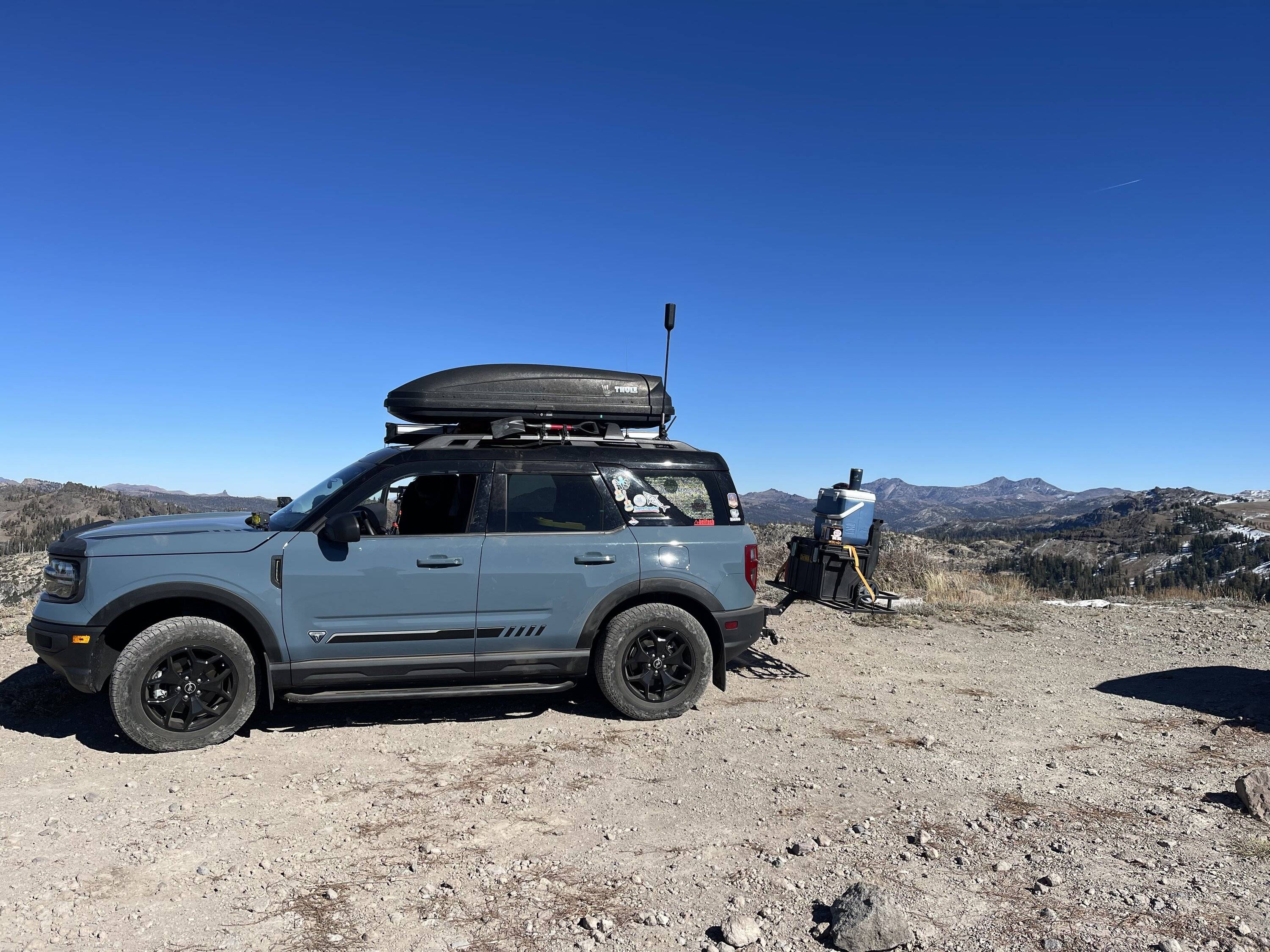

Had an experience this last off road trip on the Round Valley trail in Stanislaus national forest.
Bronco JR started to have a high pitch siren’s call and grinding at low speeds and RPM. This was after “bumping” into some centered rocks on the trail. After checking wheels, breaks, axles we could not find what was causing that noise.
We continue up to top of Mount Reba. No overheating or control issues. Just occasionally Sirens calling. The grinding was like when Trail Assist is on but it was off.
We came down and got back on Hwy4.
We noticed going a higher RPM 3k-4k , there were no sounds and everything was good.

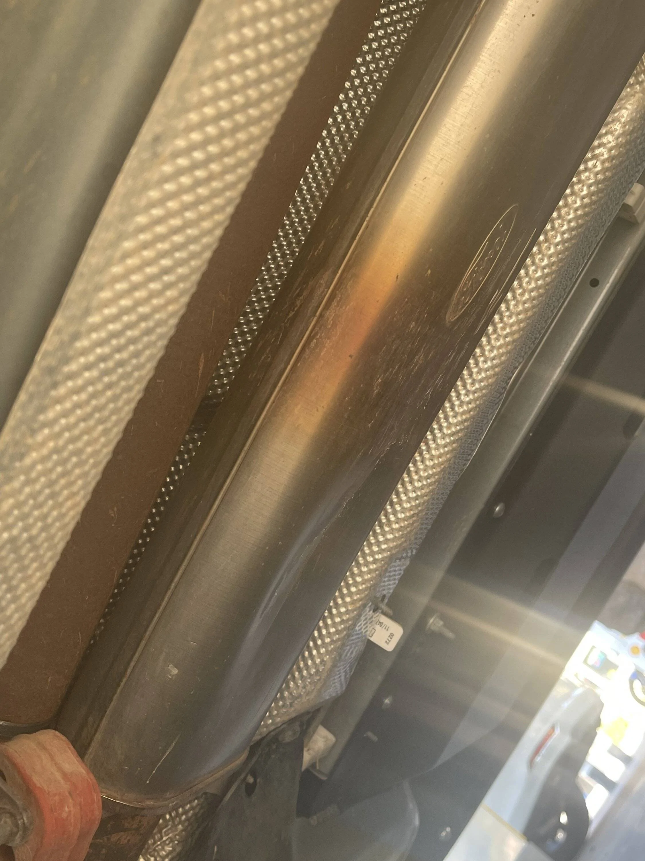

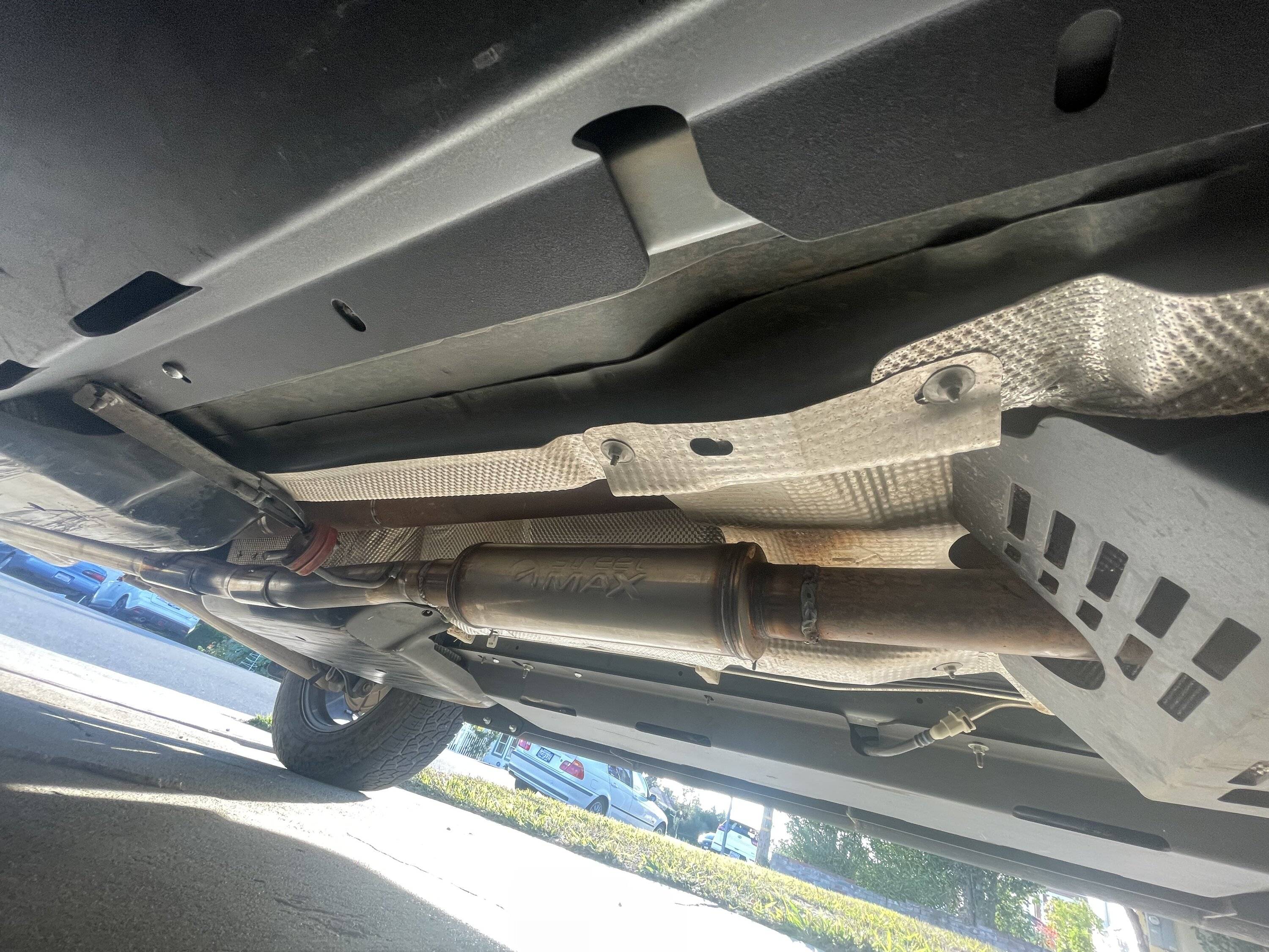

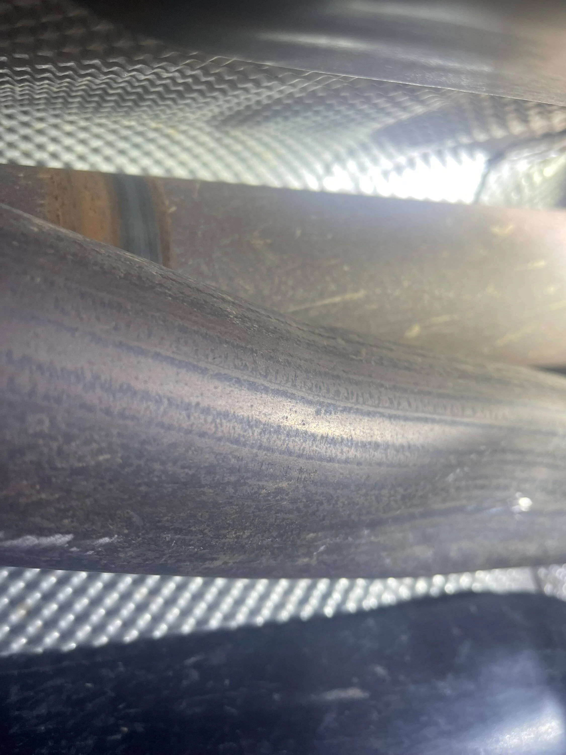

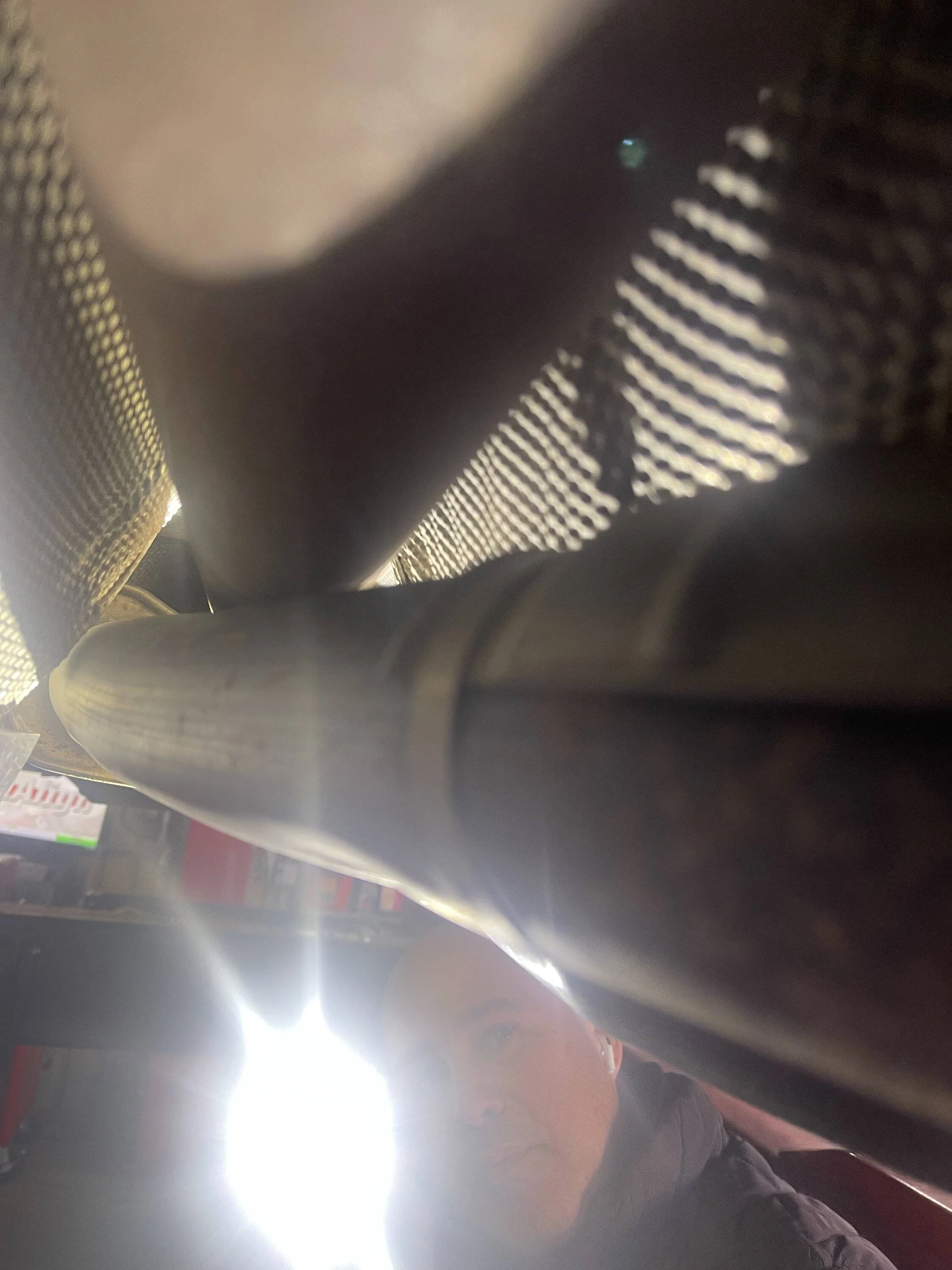

Monday I took my rig to my mechanic and used his lift. By this time the sounds were not so frequent. This is what I found:
Ford Bronco Sport When Sirens Call of the Wild IMG_0632
Ford Bronco Sport When Sirens Call of the Wild IMG_0631
Ford Bronco Sport When Sirens Call of the Wild IMG_0630
Ford Bronco Sport When Sirens Call of the Wild IMG_0629
I couldn’t see that the exhaust and resonator were smashed up against the driveshaft when on the trail. So I went to my favorite local muffler shop and $260 later that day:
