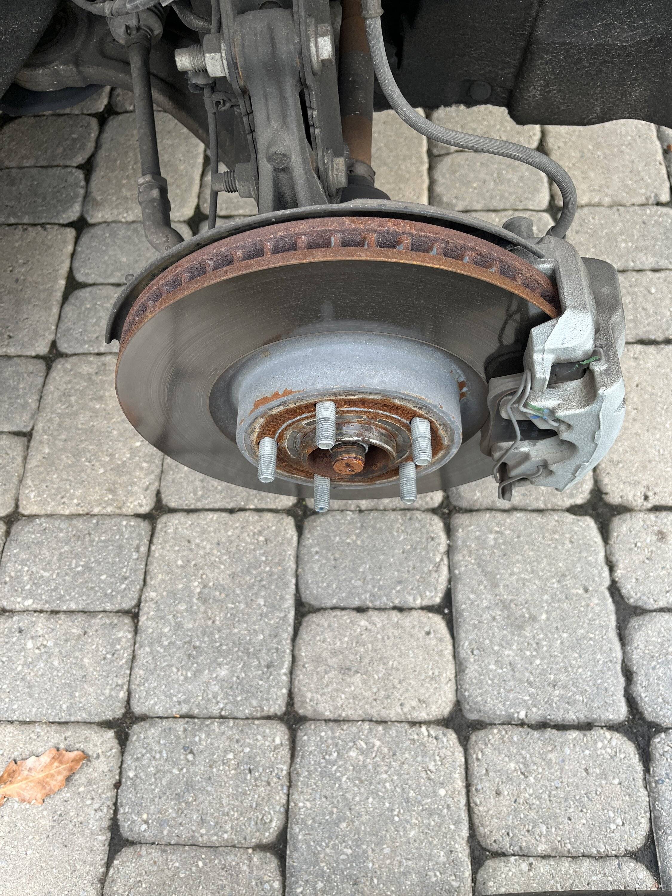

Does anyone have any idea what caps will fit the BS? I put black steelies on and would like to finish off the center with a black cap. I can't find anything online that says it will fit.

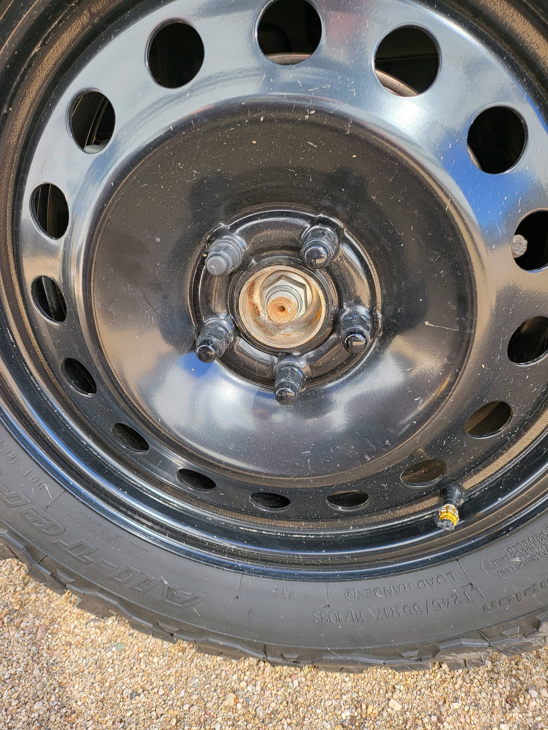

Thanks for posting this. I actually had the same question and couldn't find anything.
Last winter I did not cover the center and there is a nice layer of rust sitting there now.
I measured the interior diameter and it is about 56mm. I ordered these wheel center caps from amazon and they seem to fit securely. Will let you know if they fall out.
If that doesn't work, I recall someone had used vinyl caps which sit between the steel wheel and center mount. I'm also going to spray some fluid film to prevent corrosion this year.
Edit: Here is the vinyl cap solution posted by Maxwellian

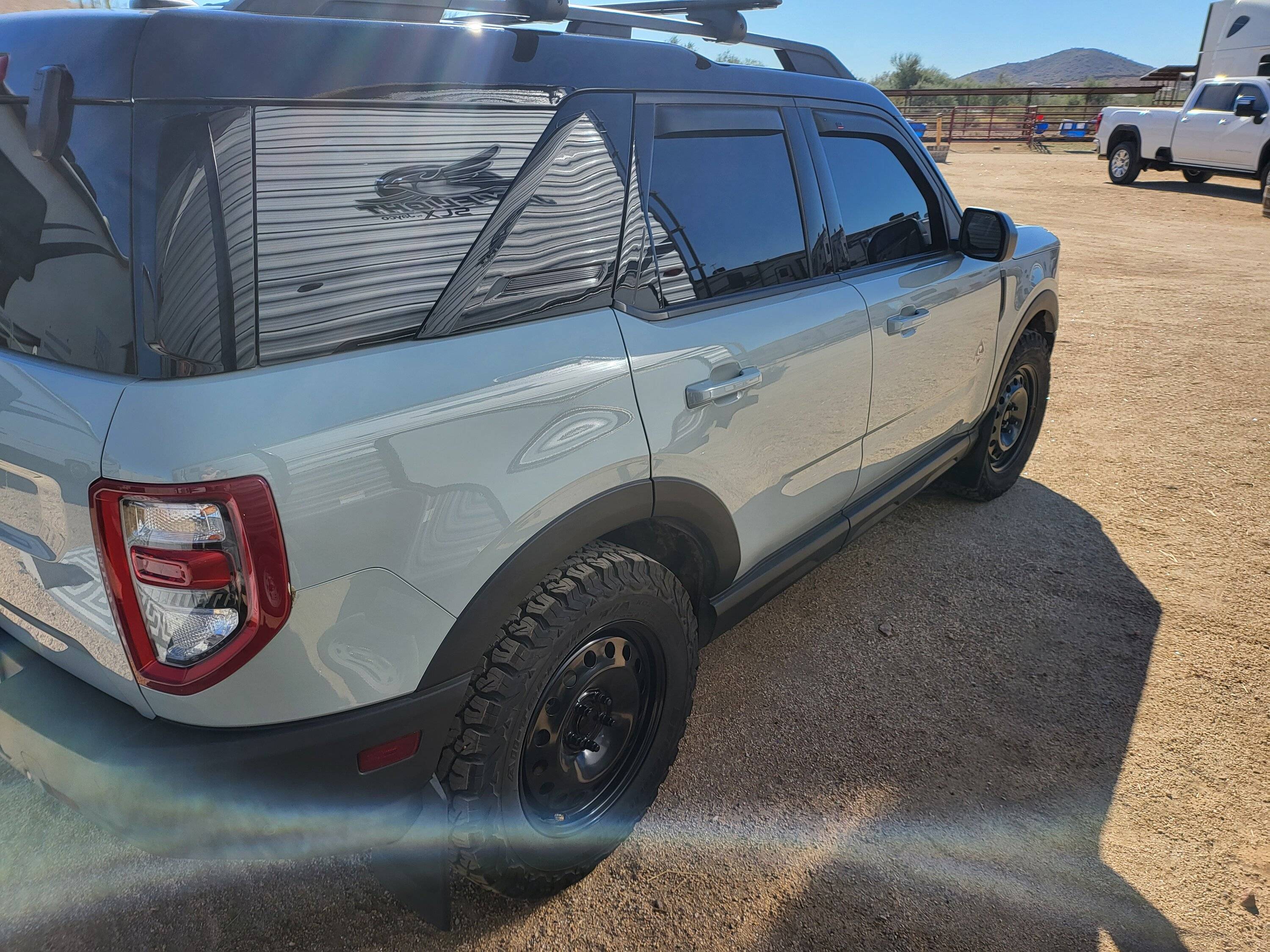

That size cap fit very snug and was exactly what I was looking for. I really don't see it going anywhere. It finished off the blacked out looked I wanted!

Awesome, glad to hear it worked out for you. Going to remove the rust and reinstall mine today.
Love how yours looks. I have a Cactus Grey as well!

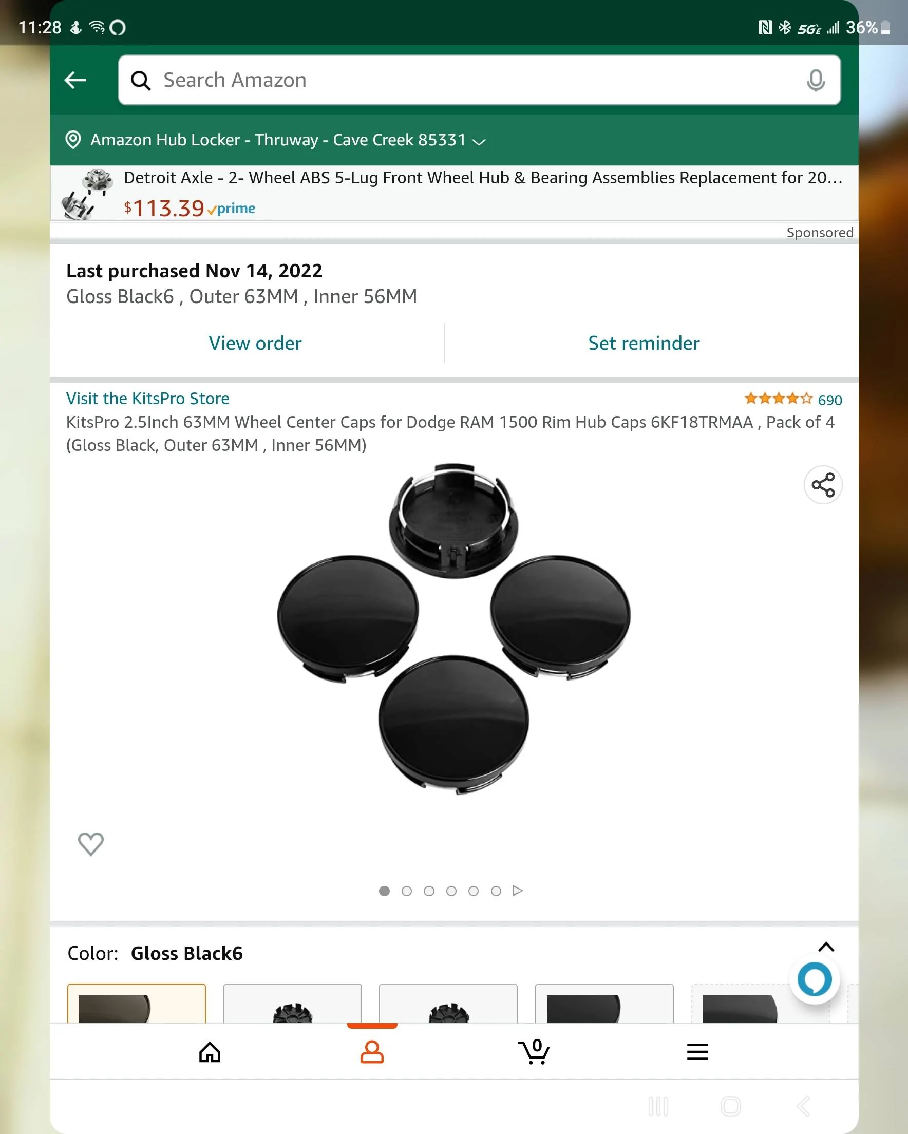

What size did you order? Was it the Outer 54mm, Inner 46mm set from KitsPro?

63mm outer, 56mm inner.
If I may make a suggestion, instead of posting a screenshot of what you purchased why not a link instead? You already went to the trouble of taking a screenshot and uploading it; wouldn't a simple copy/paste of the link be easier? It would also make it easier for readers to find the item.
