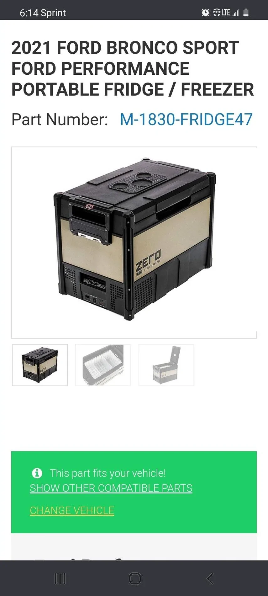

I don’t think you guys are correct. Unless this freezer from ford uses no power but I highly doubt it. I've blown up my air mattress with the rear plug as well. ?‍♂
