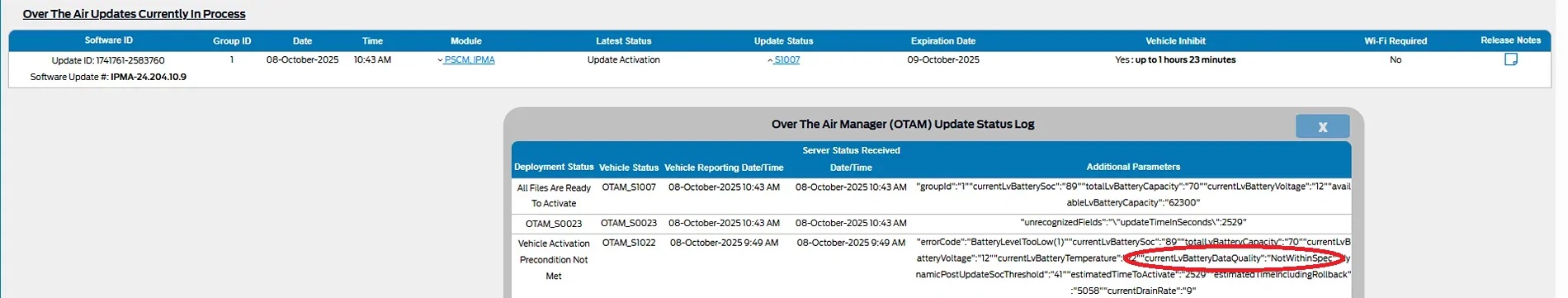

Kinda correct; the BMS will reset itself after 8 hours if certain conditions are met. Vehicle has to be left in total sleep mode and untouched. You cannot pull it up in Fordpass; you cannot unlock it or even get the keys within 25 feet of the vehicle, and you cannot have anything plugged into the vehicle that will draw any juice from the 12v battery. Even then, the purpose of this is to reset the BMS data quality if the data is corrupted. The proper thing to do is to reset the BMS when a new battery is installed. The only way (that I know of) to know if the BMS data quality is corrupted is if an OTA fails to install and you run the VIN if the vehicle in PTS and look at the OTA dashboard to see why it is failing. It will clearly tell you the BMS data quality is off. See screenshot below from the OTA dashboard of a vehicle with a failing OTA update:
Ford Bronco Sport What gives? Bad battery leads to new discovery 160698-1c05bba2ea47fdc22ee511295688542f
There is a guy on the Mach E forum who spent A LOT of time researching the 12v battery issues on Ford vehicles and their effect on the OTA process. He made a thread about which I will link below. Long read, but lots of good info here:
https://www.macheforum.com/site/threads/how-to-get-failed-otas-to-install.29749/
Long story short: If you install a new battery, make sure the battery is at 100% charge and just reset the BMS right then and there.
In terms of making the FORScan change from FLD to AGM: I am not sure how much of an effect it will have in the system to put an AGM battery in a vehicle that is configured for an EFB battery. I can tell you that if it were my vehicle, I would make the FORScan change to reflect that battery type I am using because it is quick and easy to do.

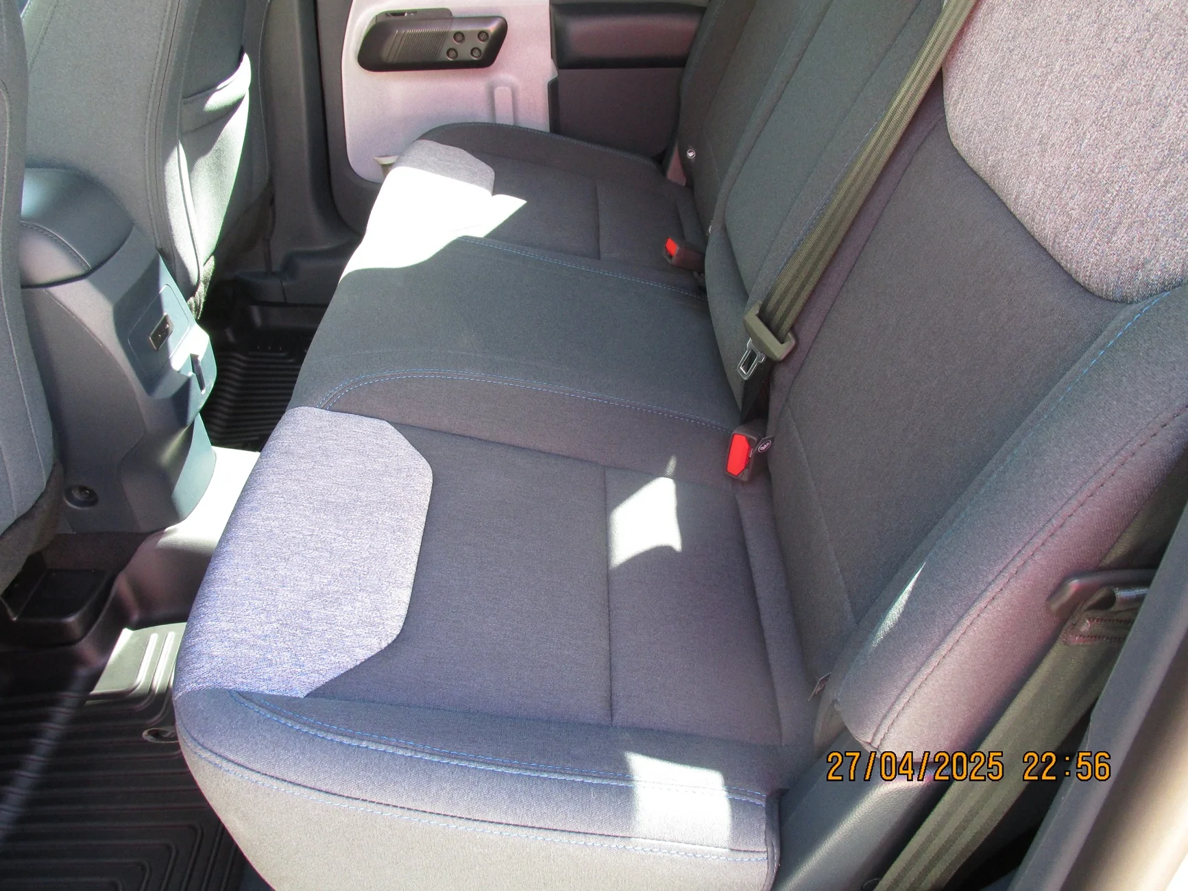

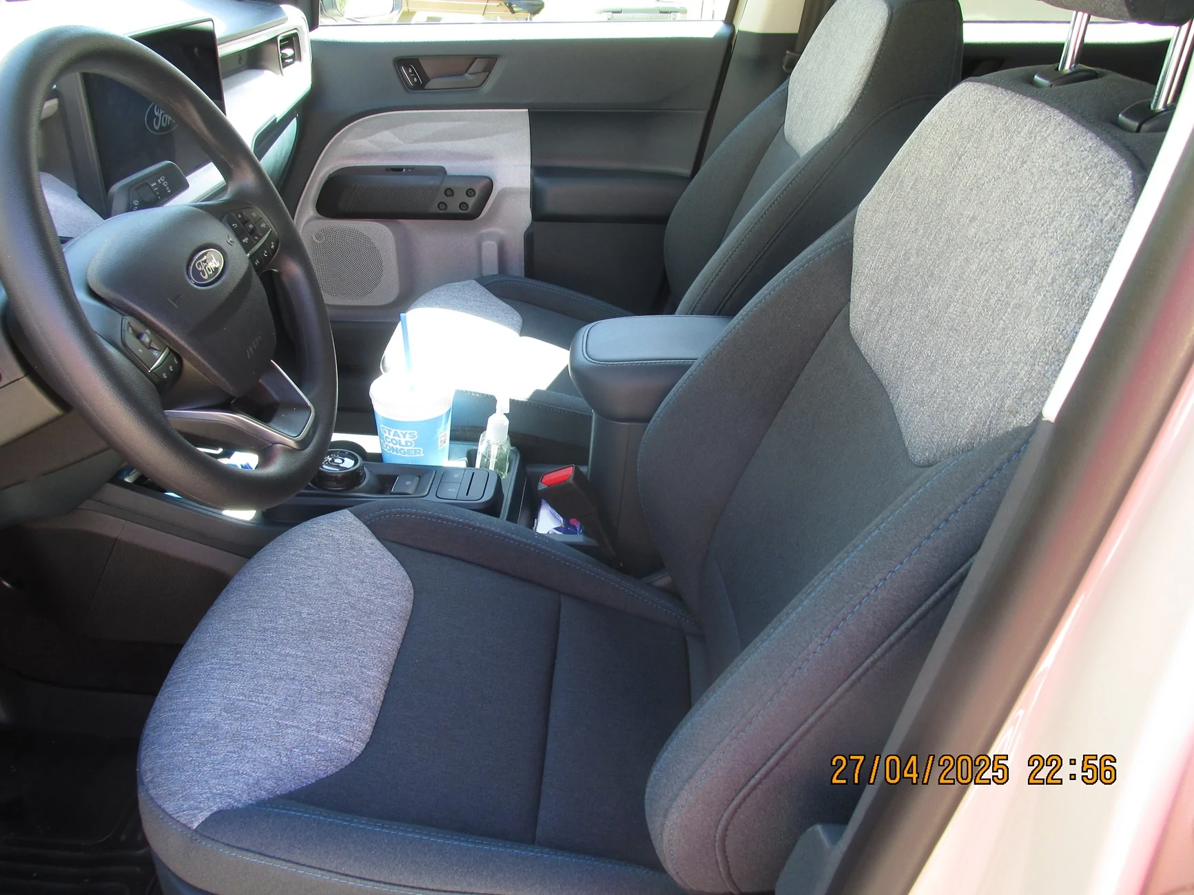

Only thing I dislike about Mavericks are the interiors on a majority of their trims. I dont like the blue hues they use and would love a LOBO, but that lime and turquoise stitching....so I was pretty much set on a Lariat.
I don't mind the blue hues in mine,but I didn't care at all for the interiors with the orange hues!! Most of the blue in Mine in front and behind the shifter are covered with stuff like glasses and bank withdrawl slips [drive thru banking] in front of the shifter and calculator and tissues behind the shifter!!
