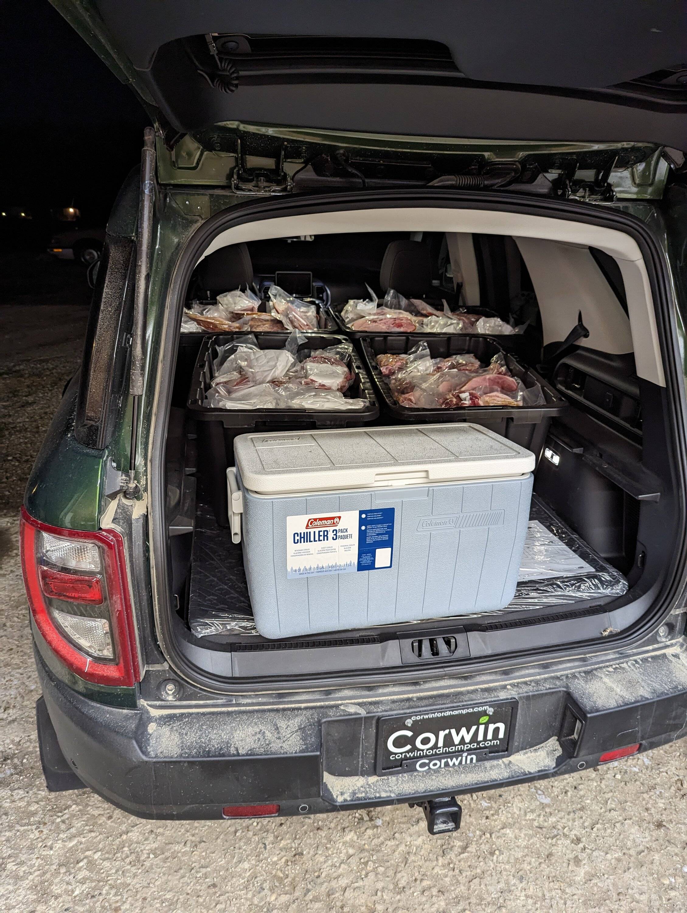

Not really something I did "to" my Bronco, but if anyone is wondering you can fit 3 whole hogs in the back of a Bronco. Forgot to take a pic. before I pulled two milk crates out though. 600 lbs. of pork fits just fine.

Not really something I did "to" my Bronco, but if anyone is wondering you can fit 3 whole BUTCHERED hogs in the back of a Bronco.
One slight correction. Unless you have a photo of three UNBUTCHERED hogs in your Bronco. Now THAT'S something I'd like to see!
If they could jump high enough to get them loaded I might give it a whirl. Hard enough getting those assholes to step up into the stock trailer for their final road trip.
