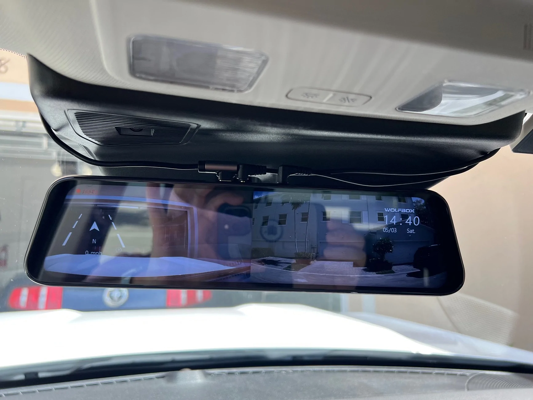

Can I see a pic of your wolfbox mirror setup? Did you use the straps? Or the oem replacement bracket?

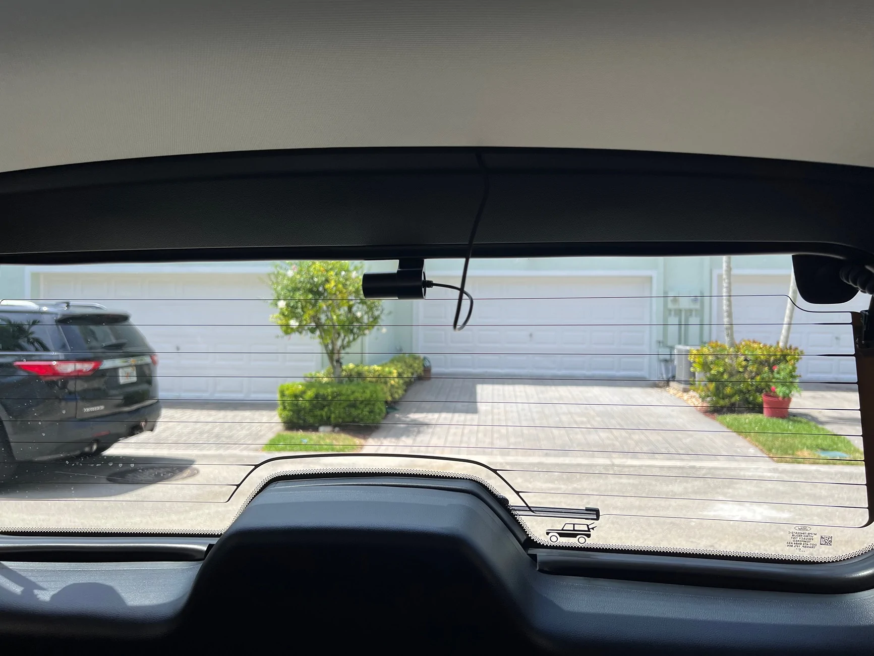

I replaced the OEM mirror using the WolfBox stalk and used a rear camera from another model (didn't want any water intrusion points) stuck to the rear glass. I used fish tape run the rear camera wire through the center of the headliner to avoid interfering with the curtain air bags. I didn't bother tying into the backup light to activate the rear camera since the vehicle already has one.

cool thanks! which wolfbox model? how is it powered? through the oem power already up there from the dimmable mirror? and did it just slide on the existing piece on the glass?
do you have any mirror wobble? i read a lot of people have wobble when using that wolfbox mount.
I had an older 850 they sent me for reporting the compass heading display problem. Powered through the power port in the center console. Carefully routed down the A pillar. I changed the default 45 minute timeout (if I recall correctly) to 5 minutes using FORScan to reduce battery drain.
The WolfBox stalk slid on the OEM mount already on the windshield. No noticeable wobble, but I tightened all the screws.
