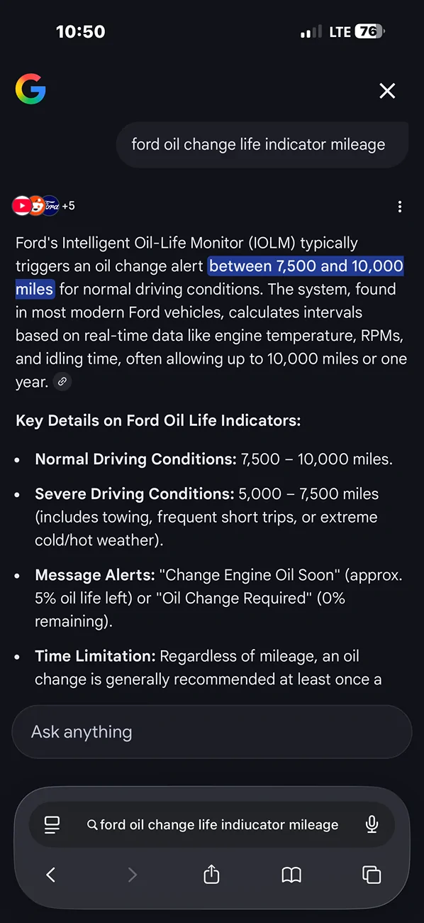

No the oil minder is not designed for 10,000 mile changes. If that was the case then it would be 16,000 km on a Canadian vehicle. My oil minder triggers between 8,000 and 10,000 km. Which is equivalent to 5,000 to 6,000 mi.
Well idk about how Canadian vehicles are, but my oil life indicator starts at 100%, and when it hits 90% I’ve put 1000 miles on it.
my oil change I just did this past Sunday showed 58% left and I had 4200 miles on it.
So, yes. 10,000 miles. Same as my fusion was. 🤷🏻‍♂️
It’s possible, being in Canada the oil life indicator defaults to “severe duty” which would align with your mileage.
