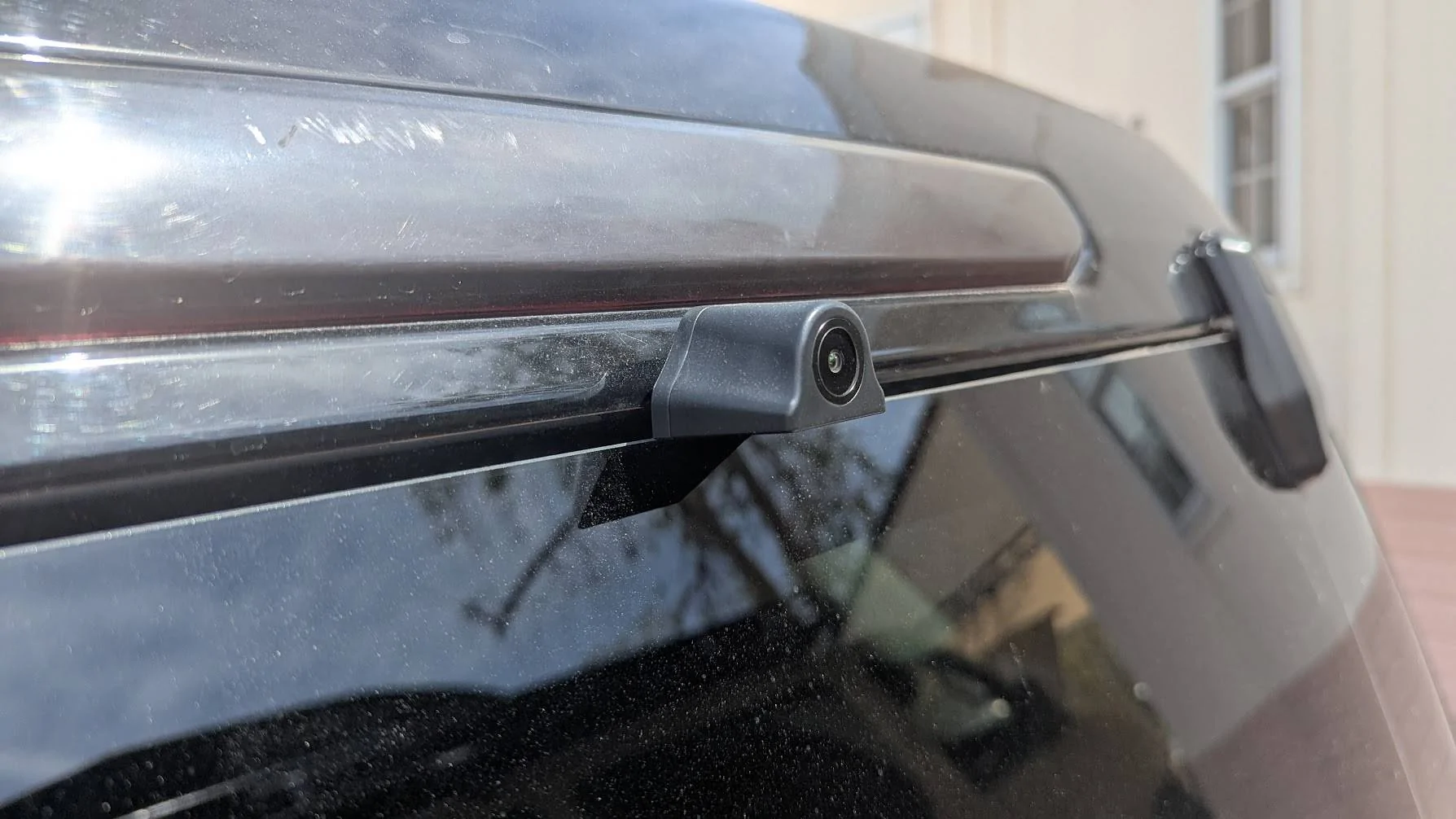

BIG TIP: Definitely mount the camera at the top of the rear glass! It will give you a view of what is directly behind you, as well as what is behind/beyond the vehicle behind you. This mounting works really well for backing up on the trails. Perfect view. So my advice? DO NOT MOUNT the camera next to the OEM reverse camera. Put it up high (RV style) for the maximum view. I will post pics of my install.
CAMERA MOUNTED HIGH IS THE MOST EFFECTIVE WAY TO GET THE MAXIMUM VIEW BEHIND.
I have my 3rd Brake Light tinted, so no light interference with the camera at all.
NICE OEM-LIKE INSTALL. STABLE AND CLEAN.

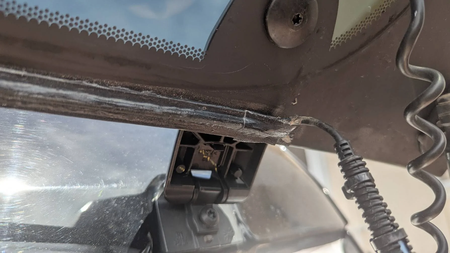

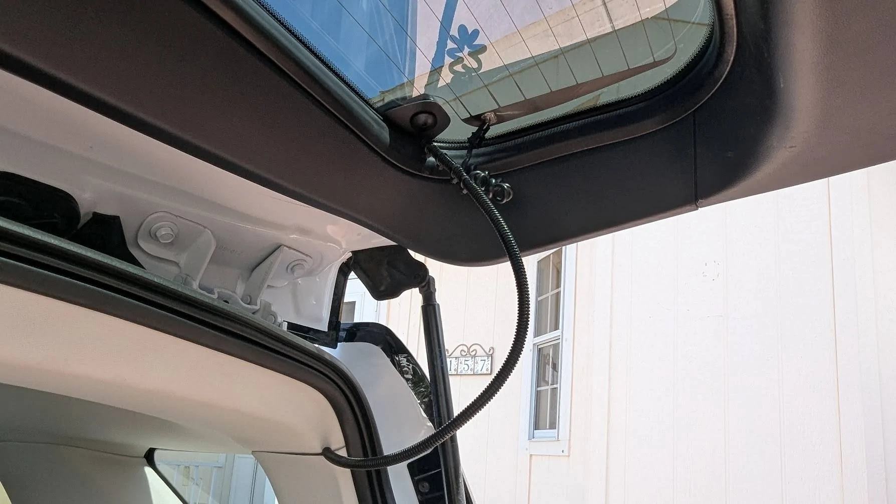

WIRES FROM INSIDE TRIM and OUT TO THE BOTTOM OF WINDOW, WITH PLASTIC WIRE LOOM.
(I really need to shorten it).

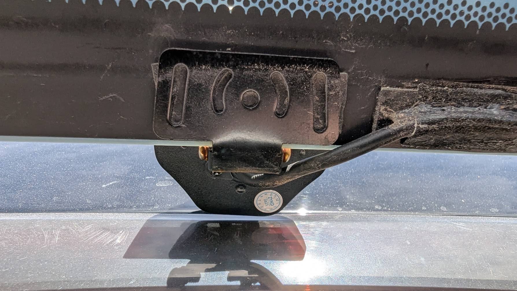

WIRES ATTACHED TO GLASS WITH GAFFERS TAPE, THEN A COAT OF RTV OVER THE TAPE. THIS HAS SURVIVED 100+ DEGREES IN ARIZONA TEMPERATURES WITH NO ADVERSE EFFECTS AT ALL
CAMERA BRACKET MOUNTED TO INSIDE OF GLASS WITH 3M TRIM TAPE. THIS IS VERY STABLE

The rear camera bracket you used. Is that from someplace else, or is it the bracket that comes with the camera? I wanted to mount up high. Was thinking of mounting on the roof, and route the cable in that grove and would only have maybe 3 inches exposed. But I’m intrigued by how yours is mounted outside the window with the bracket inside.
