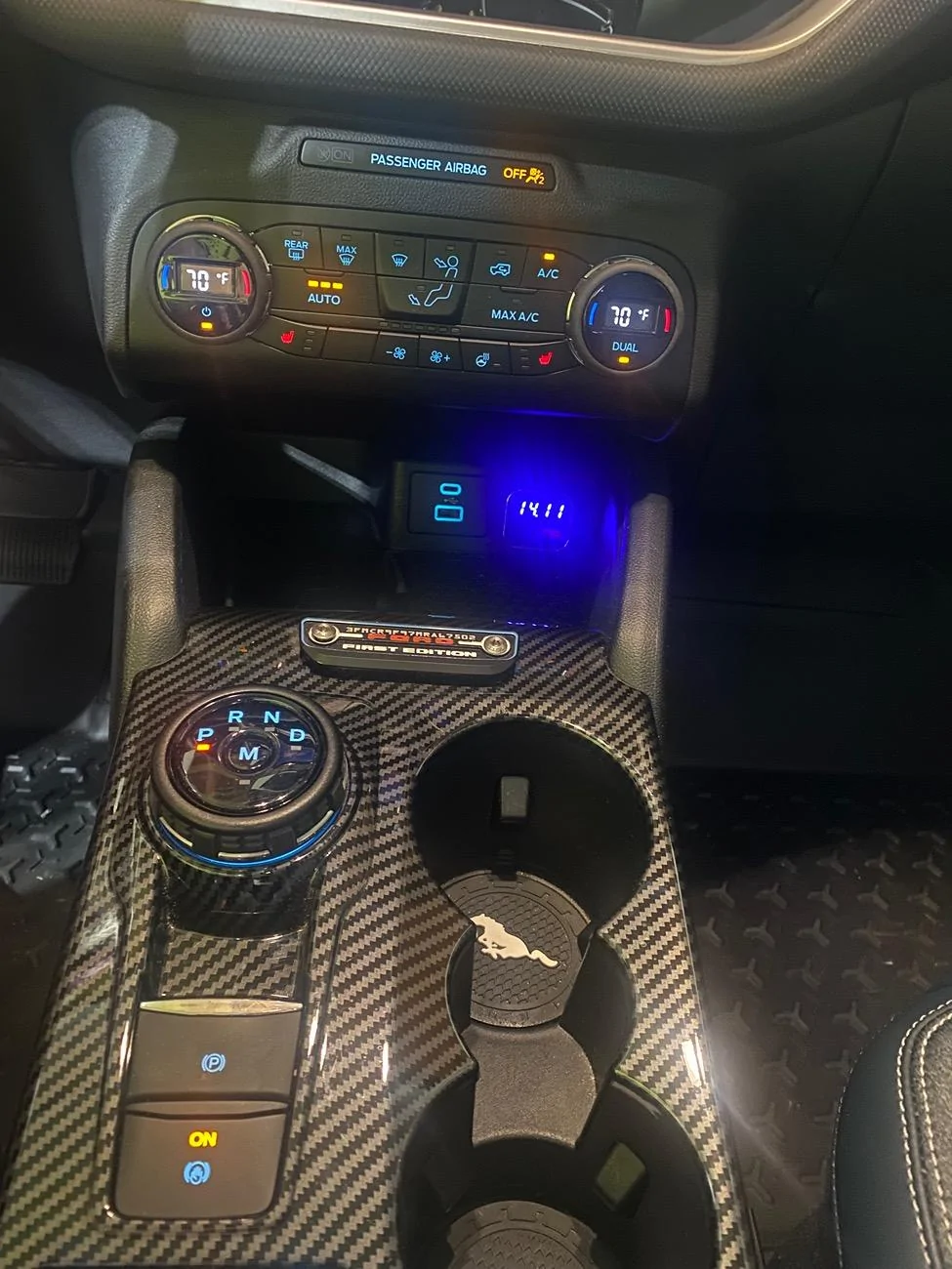

Put in the little cigarette lighter volt monitor in the cubby to keep an eye on things.

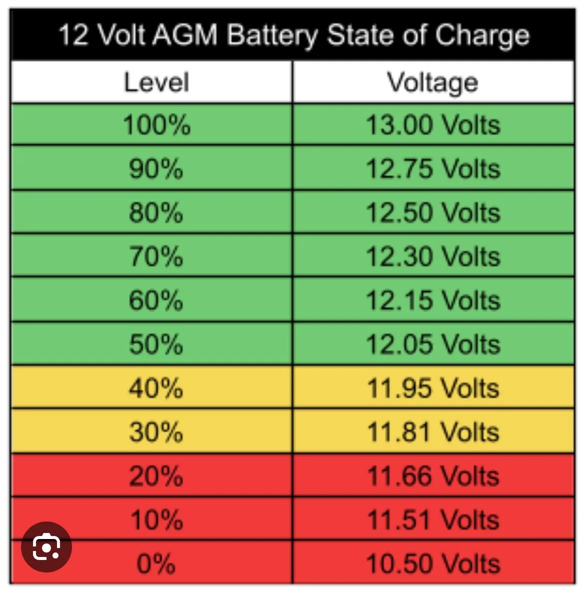

12.3 volts is a 70% charge according to this chart. Be aware that voltage right after a drive will be higher than voltage that shows after a few hours. The voltage in the morning is the one you should monitor. If showing less than about 13 volts while driving, then your alternator is probably faulty.
Here’s the chart for AGM
