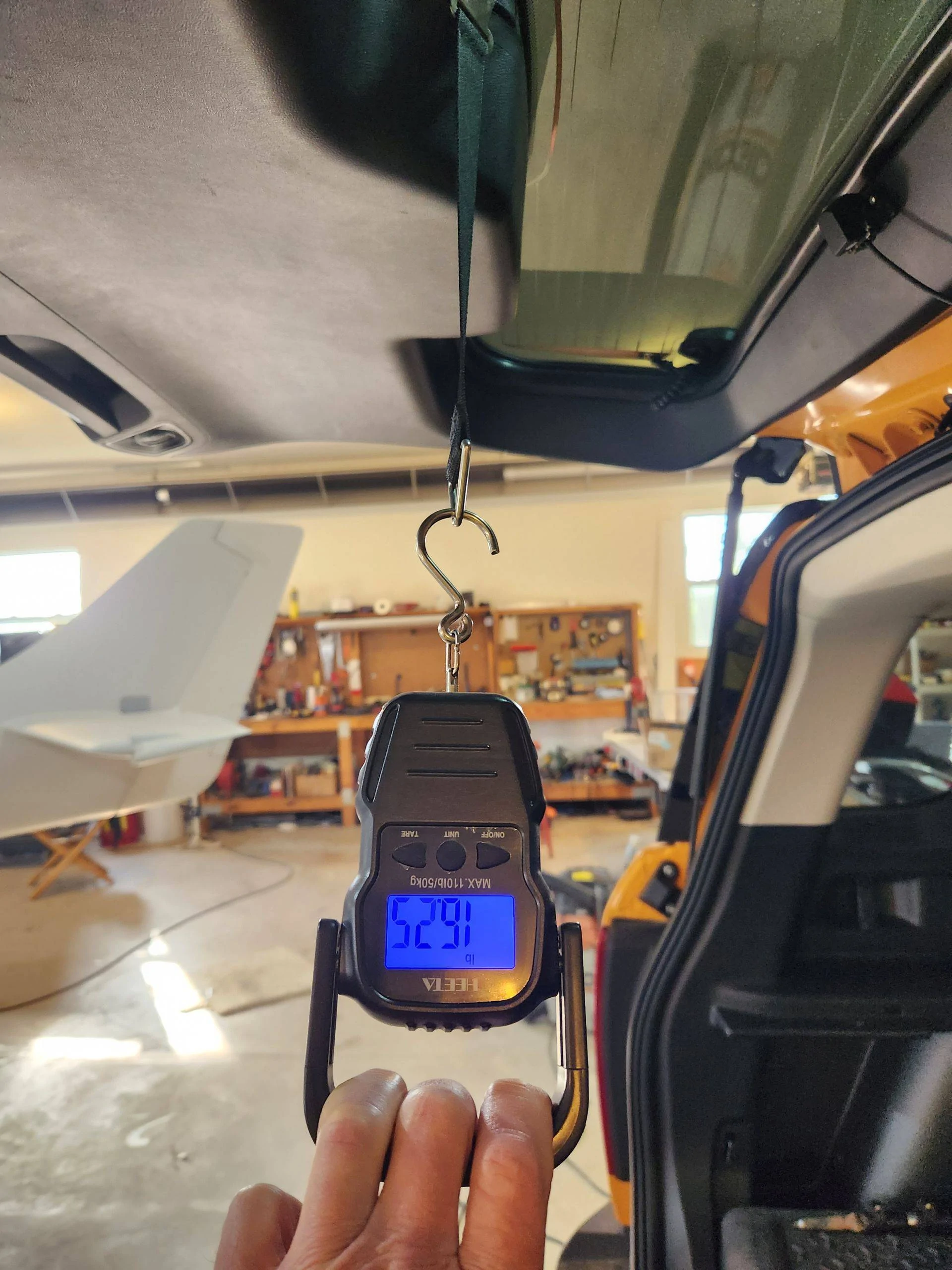

I would like to hook up and mount a 3.8 gallon water shower system to this to use with the glass being open as well as the door being up. Full it weights 42lbs. Woudl the door be able to support this weight without closing back down???
I don't think so. I just attached a fish scale to the trim piece near the glass and pulled. The liftgate started closing at around 17 lbs. It starts closing at around 7 lbs with the scale attached to the handle at the bottom.
Ford Bronco Sport Weight capacity on back door before it's unable to remain open? 20230330_085704
HAHA thanks for this Mark you're the man. That definitively answers it then. Appreciated !
