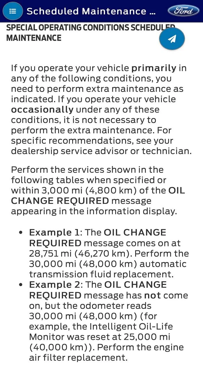

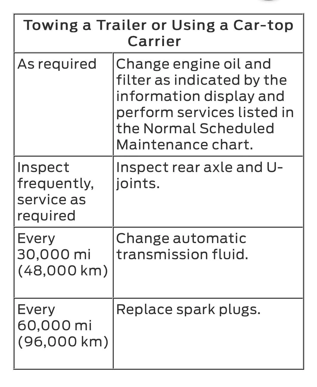

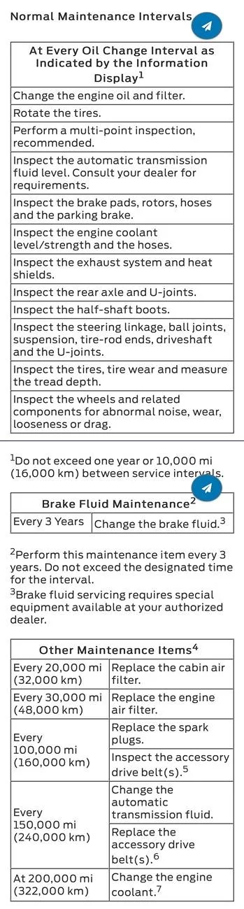

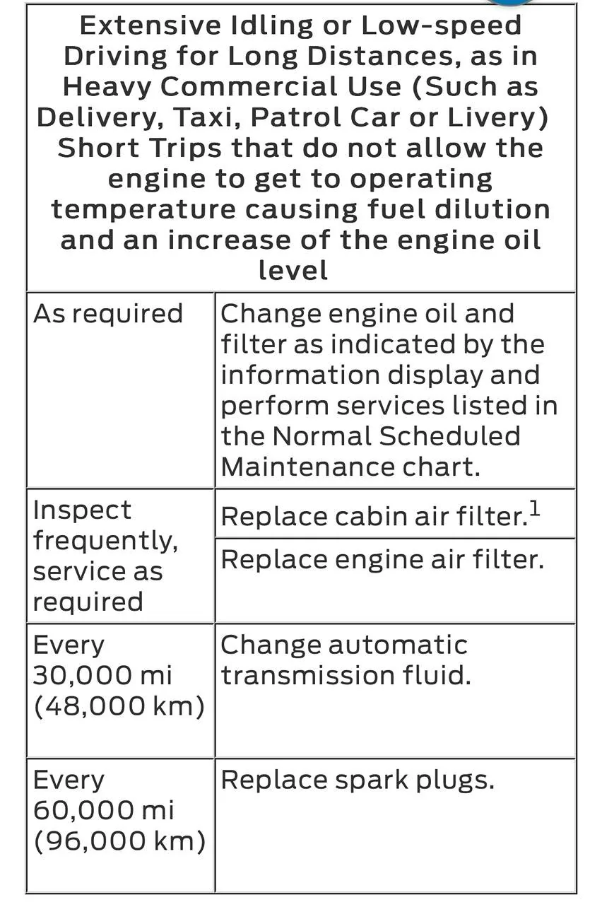

Transmission fluid change intervals for various scenarios is in the owners manual and fluid “could” be inspected without a dipstick (at every oil change) although it’s not that easy so I can see why the dealership chooses to just change the transmission fluid at 30k intervals.
The “Normal Maintenance Intervals” states “Change the automatic transmission fluid Every 150,000 mi (240,000 km)”
The “SPECIAL OPERATING CONDITIONS SCHEDULED MAINTENANCE” section, in both the “Towing a Trailer or Using a Car-top Carrier” Table and the “Extensive Idling or Low-speed Driving for Long Distances” Table state “Change automatic transmission fluid” “Every 30,000 mi (48,000 km)”.
