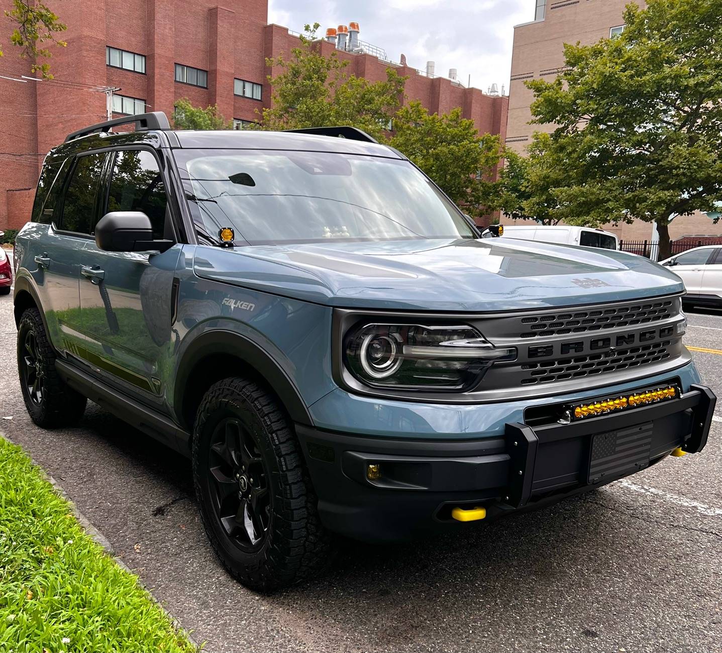

My lil 4 cyl BS is losing my attention. I’d like closer to 300hp and a better exhaust sound, but absolutely want any mods to be OEM warranty friendly. Do warranty friend tunes or intakes exist? Share suggestions, brands, results, photos, and things to watch out for; oh and costs help too. Pic of my First Edition
