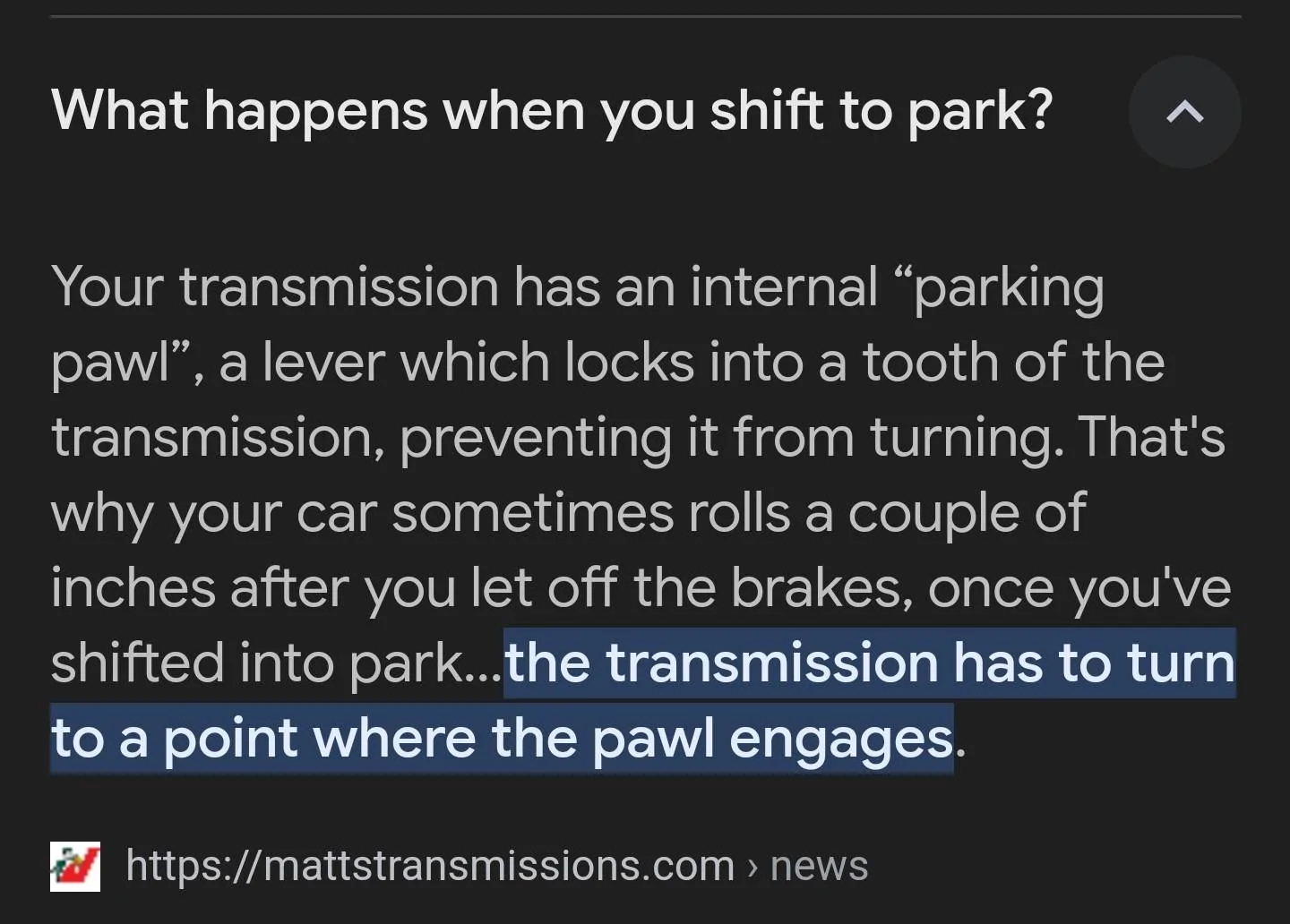

Just like the comment mentioned above, it is totally normal and engages on every automatic transmission vehicle. The parking pawl has to engage when putting into park so that the car is securely parked and doesn't roll away.

Do this espcially when parked on hills (also know the correct way to park on hills -- ask San Francisco residents). That way your not putting the weight of the vehicle on the parking pawl. The parking brake takes the weight and the pawl is the backup. Not the other way around.
If you saw the parking pawl, you'd instantly understand.
