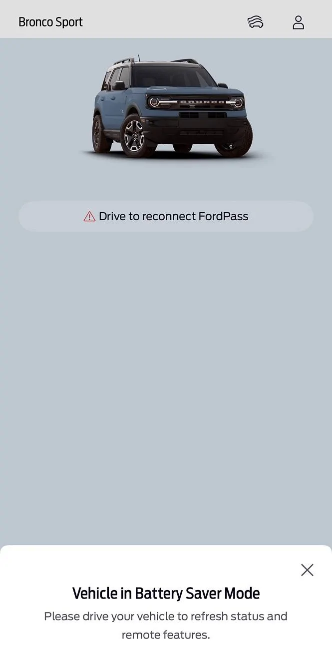

Hi all,
I had 23 OBX today my vehicle battery is dead due to cool weather. In the app it is showing vehicle is in battery saver mode. How to start it do I need to jump start or any other way I can?
please suggest me what should I do.

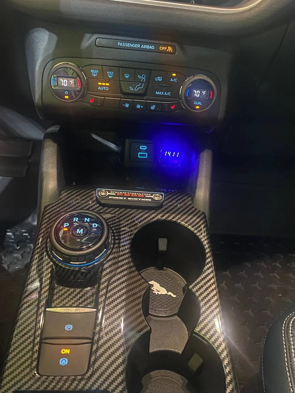

Make sure you are driving enough to keep the battery charged, about 30 mph or more for 20 minutes every few days should be sufficient
Or purchase a battery tender and keep the battery charged that way
You may want to purchase a lost cost voltage readout device that plugs into your cigarette lighter to keep an eye on battery voltage to see when the battery is unable to hold its voltage more than a few days
here is a product I use

What are my options now do I need jump start?

Your alternative depending on battery location would be to hook it up to a battery charger, if you are in range of an electrical outlet, have a long enough extension cord, and a battery tender/charger. Otherwise yes, you will need a jump.
You don't specify the year of your BS, but if you have a 21, there is a pretty good possibility the battery is dead.
If you have AAA, probably easiest to call them. Otherwise, may be worth asking a neighbor for a jumpstart.

Mine is 2023 outerbanks thanks for the suggestion. Does it counts under warranty can I call my dealer?

The battery dying (lack of charge, but healthy) from the car not being driven enough may not be covered as a warranty item. If the battery is actually bad (poor state of health on a battery tester), the battery is covered under the bumper-to-bumper 3 year/36,000 mile warranty.
I would call your dealer and perhaps see if they can come out to jump your vehicle/test the battery. More and more Ford dealers have mobile service now.
Another option may be that the dealer's mobile service may be able to come out to give you a jump, then with the car running, you drive it straight to the dealer for them to charge/test it.
But I would call the dealer and see what they can do to help.

Call the dealer mine did the same thing. The dealer sent up a mobile truck and put in a new upgraded AGM battery and I haven’t had any problems with it cents.

Hello! Send us a private message with your VIN and current mileage. Allow me to see what I can do to assist. Thanks!

Hi thanks for your message, My dealer suggested me to use roadside assistance, they helped me with jump start. Now am good. Thank you.
