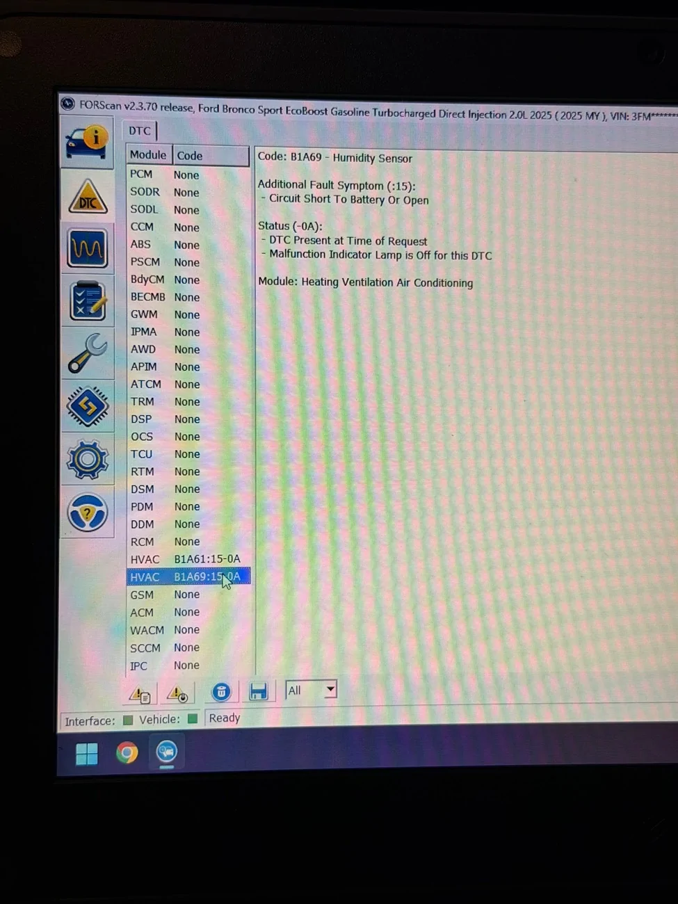

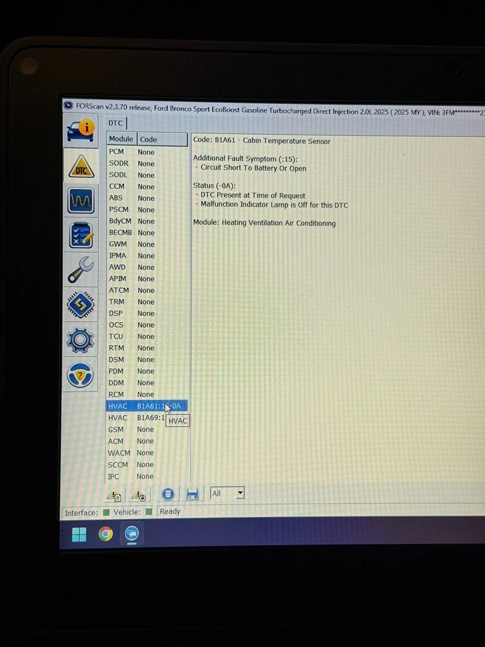

Have these two faults showing in ForScan right now. Both related to the HVAC system. Can’t imagine it’s not related.
Ford Bronco Sport Vehicle always starts with Defog/Defrost on medium fan at max temp. IMG_6760
Ford Bronco Sport Vehicle always starts with Defog/Defrost on medium fan at max temp. IMG_6761

Couldn’t get rid of the codes with just clearing them. Did an HVAC module reboot, and they went away after rebooting the module. Hopefully this is the fix for hopping into a vehicle that’s already 95° and further adding more heat to it. 🤣

Sorry, I just noticed you replied to me. I just posted on your Facebook. Mine went away with ForScan, but then at the same time I realized I had left the connector that goes to it unhooked.
So I hooked that up at the same time and then realized why my codes went away. 🤦🏻‍♂️

And. I just ordered that part sitting in church. Thanks, dude!

Part came in today. Told the wife I was gonna wait till the wolfbox arrived "to preserve the fragile array cover". But she left to go shopping and no sooner was she out of view did I pop that array off, connect the sensor, peel the backing off the gel pad, and clip in all back in.
Reconnected the battery, cleared the codes, and me and the dog are driving around for a while to check to make sure ai didn't break anything peeling that pad cover off.
The cold air came on immediately though, so that's a good sign.
Thanks for the help!
If anyone else finds this thread...
Part no. ML3Z-19E906-B is what you want to look for.
