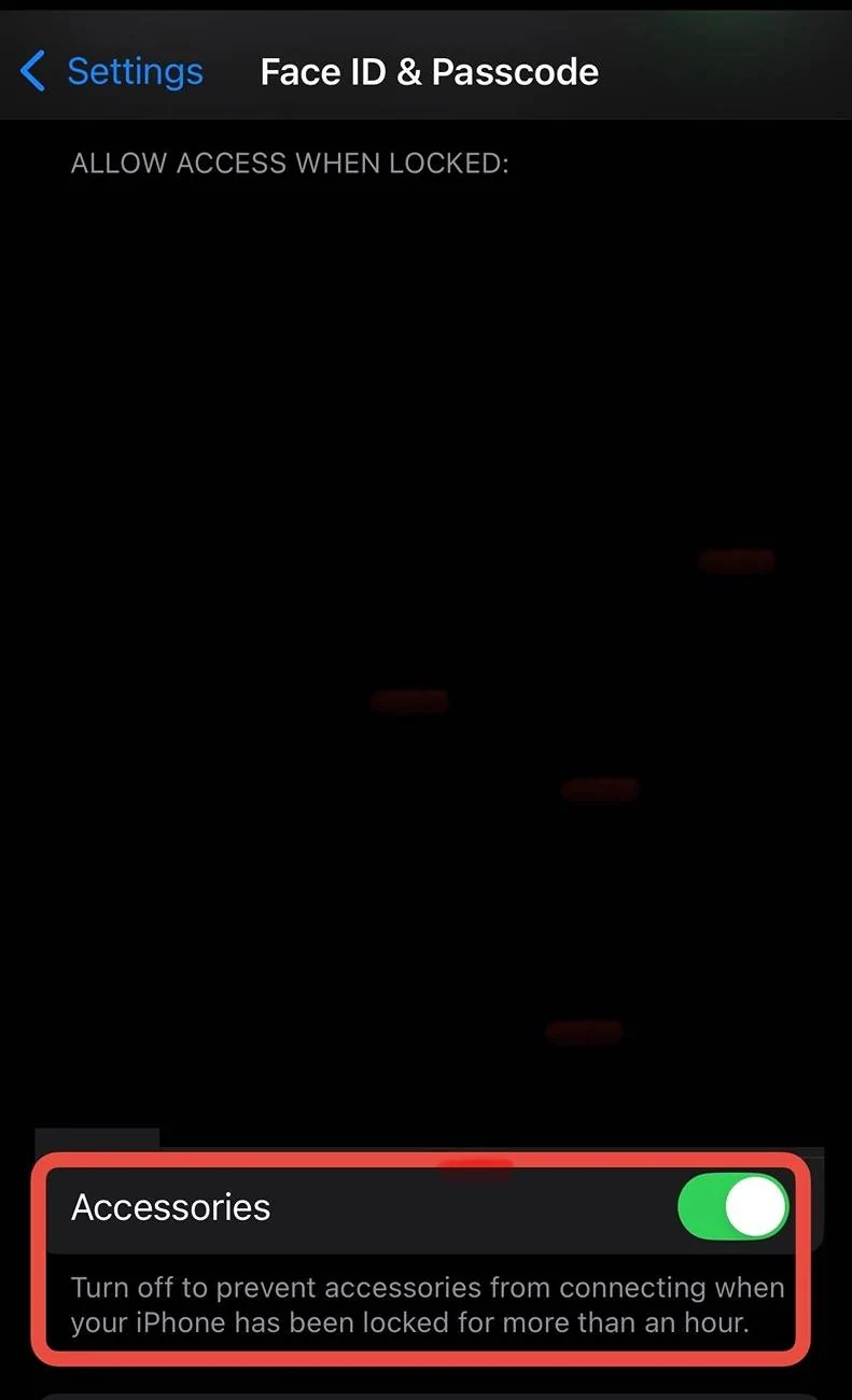

Odd this question should come up! I was driving yesterday and my Waze wouldn't come up! I tried the usual stuff and finally said "Siri, open Carplay." It told me I couldn't do that with the phone locked. My wife unlocked the phone and it started working! I never had that happen before... but fairly new to my BS and using the Carplay apps in general.
Settings > General > CarPlay, select your car, and enable "Allow CarPlay While Locked"
However …
The "Allow CarPlay While Locked" setting on your iPhone might not work as expected due to security features that require the phone to be unlocked after a period of inactivity when connected via USB. This security measure is in place to prevent unauthorized access to your phone's data.
Here's a more detailed explanation:
Security Feature:
Your iPhone's security features, like Touch ID, Face ID, or passcode, require unlocking after a certain time (usually after an hour) to allow data transfer via USB.
USB Restricted Mode:
This feature, which can be found in Settings > Face ID & Passcode (or Touch ID & Passcode) > Accessories, can interfere with CarPlay's ability to connect while locked.
Disabling USB Restricted Mode:
To allow CarPlay to work while locked, ensure that "Allow Access When Locked" is toggled on for USB Accessories in the same settings menu.
Alternative for Wireless CarPlay:
If you're using wireless CarPlay, the "Allow CarPlay While Locked" setting may not be necessary as wireless connections are typically less subject to security restrictions.

@Dude : Thanks for the detailed info. I did check and it is set to allow carplay when locked. Not sure what the issue may have been - it's only happened once... and my wife was there to save the day!

Yes but it’s the 2nd item which is under the detailed explanation that also would need to be enabled - but my advice is to not enable this 2nd item: (meaning you will continue to see the iPhone is locked message come up after an hour of having the iPhone last unlocked)
This is the cause and is why you don’t see the iPhone is locked message every time:
