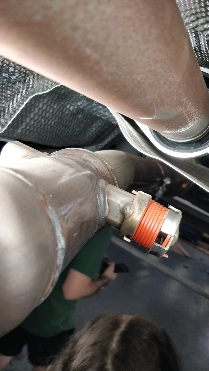

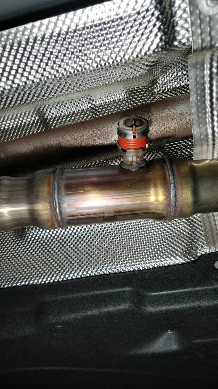

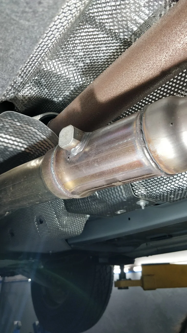

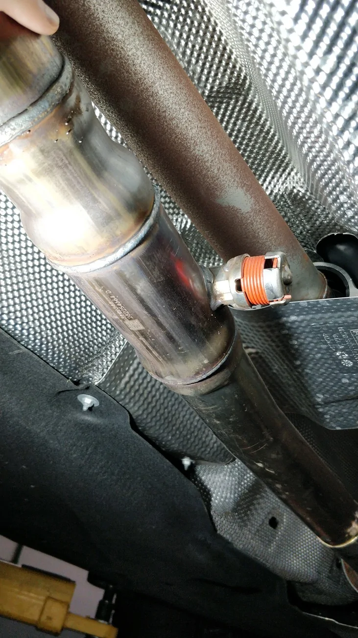

Hi everyone,
I was searching through previous posts but couldn’t find anything about this, apologies if this has already been discussed.
I recently had my Bronco Sport (2.0) up on a lift at a shop and took the chance to really inspect the underbody, there are a lot of interesting design details.
I came across this device on the exhaust that I’ve never seen before. It’s not electrical, and it appears to be a mechanical rotating mechanism with a spring that provides preload. The tip rotates about 90°, and you can feel something moving internally when turning it.
Ford Bronco Sport Unknown spring-loaded rotating device on exhaust (2.0 EcoBoost). What is this? IMG_20260321_124013
Ford Bronco Sport Unknown spring-loaded rotating device on exhaust (2.0 EcoBoost). What is this? IMG_20260321_124006
Ford Bronco Sport Unknown spring-loaded rotating device on exhaust (2.0 EcoBoost). What is this? IMG_20260321_124001
Ford Bronco Sport Unknown spring-loaded rotating device on exhaust (2.0 EcoBoost). What is this? IMG_20260321_123939
I haven’t been able to figure out its function.
Has anyone seen this before or knows what it does?
Thanks in advance.

Saw your Facebook post.
It’s just a valve that allows the exhaust to be calmer at idle, and opens under throttle.
I removed mine when I redid the exhaust.
There’s also a non reporting catalytic converter on these which, to me is odd…

I remember those heat risers back in the day when I worked on lots of cars. As I remember, those worked for about 6 months before freezing up completely - at least on the Chevys. They restricted exhaust on on side of a v8 to force hot exhaust across the intake manifold under the carb to the other side.

I removed it when installed cat back 3” pipe and and muffler because where I live the salty sea air and driving on the beach will eventually rust the spring on that and it will fail.
