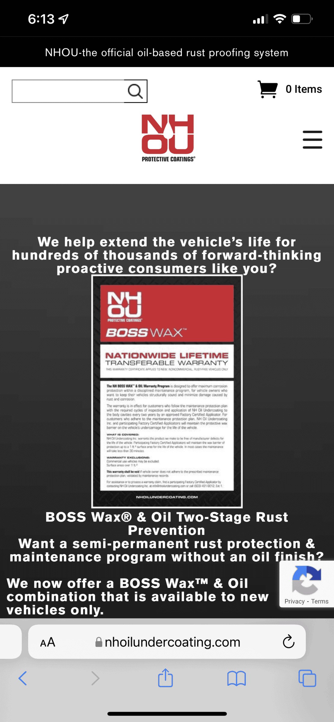

Nhou oil coating it’s the best and diy friendly
