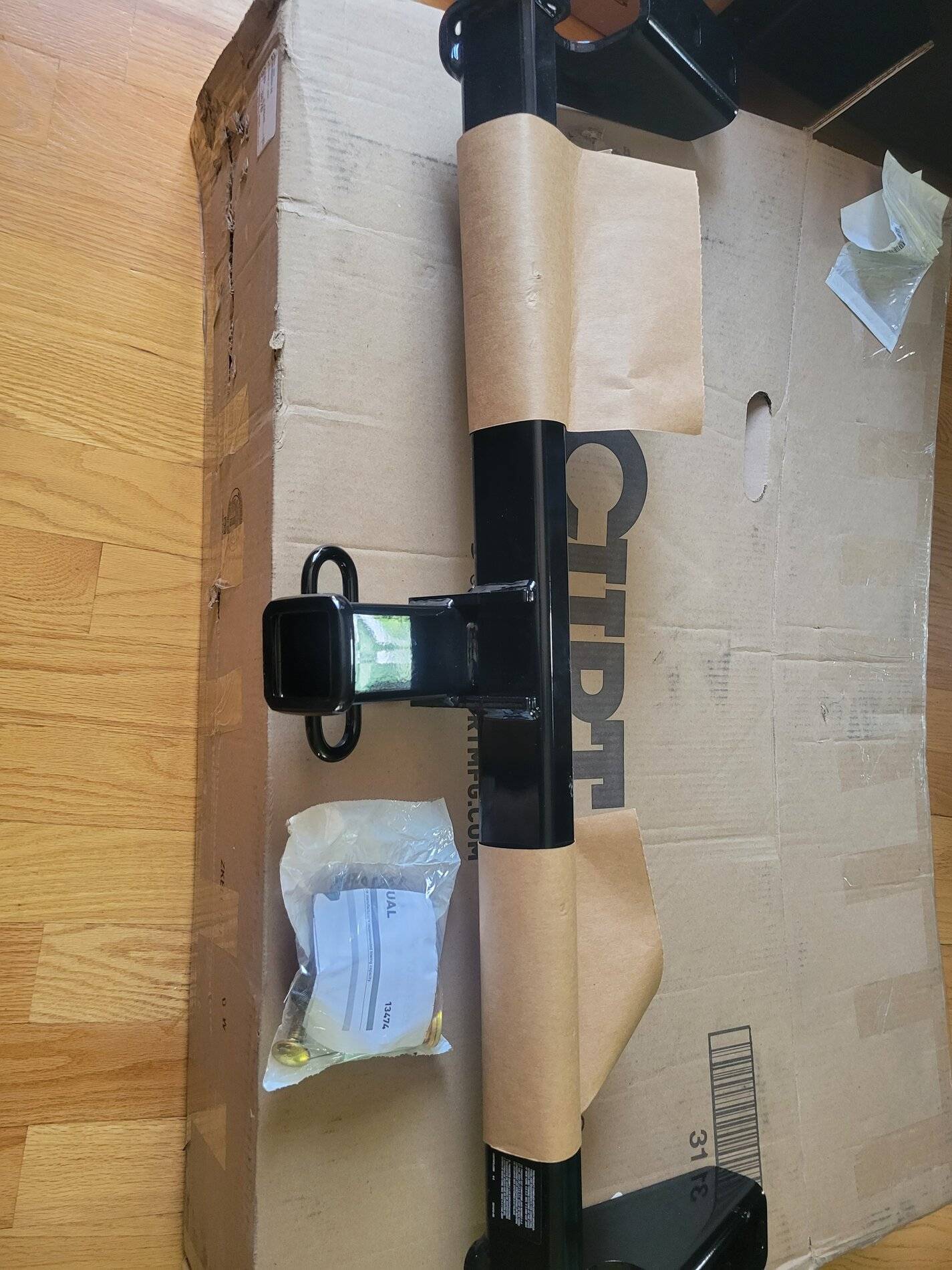

So I finally received my hitch and can't wait to install it this weekend. In anticipation I watched the uhaul video since they are installing the same hitch as I purchased. ? in the video before "fishing" the carriage bolt and spacer they use a step bit to open up the hole on the frame to make it easier. But then they don't use POR15 or some kind of treatment on the raw exposed metal on the frame. As you can see in the instructions they don't ask for that step. I really think this will cause corrosion or some other kind of issues down the road. If you got your hitch done at Uhaul I would take a look.

POR15 cures in a day or two I believe. I have a can at home; I used on the frame of my 7.3powerstroke. I'm going to put the hitch on tomorrow without drilling out the holes bigger on the frame and will post pics.

When he egged out the hole metal bits dropped into frame rail. So now metal bits gonna lay on bottom of frame rail and rust.
