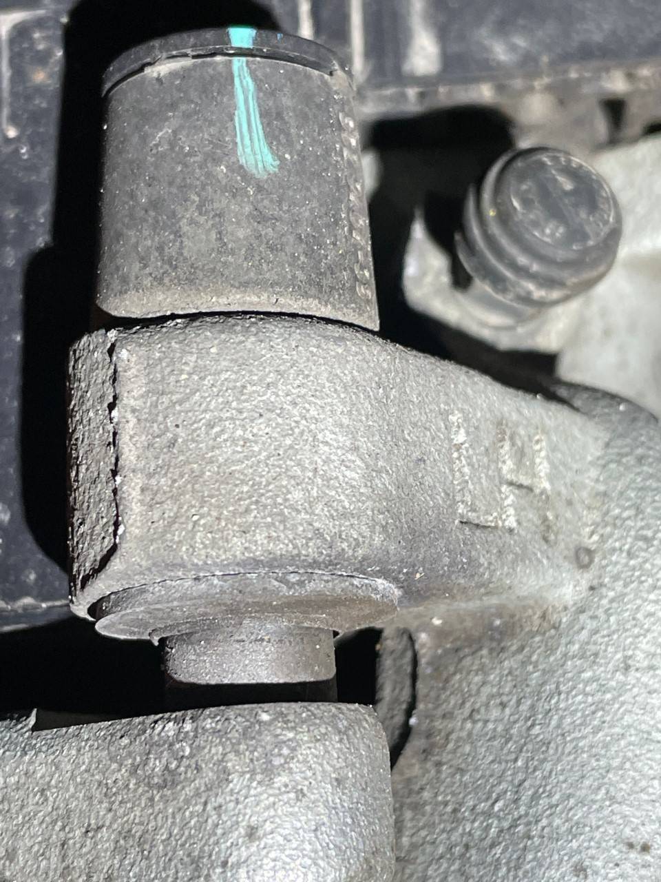

I feel your pain. And agreed, Ford doesn't seem to have a fix for this. I've been back twice to my dealer for this. The first time, they said they applied the TSB (replacing the four rear caliper pin bushings, two on each rear caliper, top and bottom). But I have a habit of looking close at my car after repairs - and saw the job was actually only half done by them. They replaced the BOTTOM rear bushings, and greased there... but not the TOP ones. (If you look into the details - the replacement *bottom* bushings are much stiffer than the originals; but the compound/stiffness of the old/new *top* ones - well I don't know).
I went back to the dealer, saying I was disappointed. The TSB clearly requires TWO kits to be utilized, for a total of FOUR rear bushings. Also important - if the top ones aren't removed and replaced, obviously that means they got no grease during the TSB repair. The service rep said his tech said the top bushings are the same old/new. Long back n forth ensued and dealer finally re-installed all four bushings, and greased them (naturally I checked again to confirm). But the rep had told me the first time - this TSB repair has been having limited effectiveness in solving the moaning noise in our cars. And he repeated it again.
I tested it out again in ensuing (cold) days - especially when car was cold and wet. BTW also - I'd gotten a product "Rustopper" for reducing rust on rotors, and was trying it too, especially after I wash the car in cold Wx, a distinct problem scenario for this car. No dice. Still moaning like a tugboat!
I have changed my procedures (esp, on backing into the garage), to help me live with this. That does help; but it still haunts me, having this problem - even though it in no way effects the overall braking effectiveness. Whenever I really get on the brakes, forward or reverse, hot or cold, they grab like a pit bull. But doggone it! The moaning still vexes me.
I'd like to clear the air about this whole thing, and Ford, and their dealers. I'm a Ford fan. I love my BS BL - and have no intention of letting something like this turn me into a whiner about it. EVERY car has foibles and issues. (I posted the similar, numerous, other makes and models which also exhibit this problem, in the 'Brakes after TSB' thread herein). I don't have the vinegar, nor the time, for a 'Holy War' against Ford/Ford dealers. (Anyone who does, I have no issue with). So instead, I'm plotting a way to still throttle or at least diminish this issue for my car. I'm going to try PowerStop Ceramic-Carbon pads next. BTW attaching pix of my caliper bushings, after the *first* repair try, herein for reference. If anyone here needs to inspect theirs after the TSB work - - look for "similar graying" on suspension parts, to see what's actually been swapped out. The pix here show a darker (newer) bushing, and, an older (grayer) bushing.
Ford Bronco Sport TSB 22-2326 : "Moan Noise in the Rear Brakes When Driven in Reverse in Cold Weather or High Humidity" thumbnail_IMG_1069
