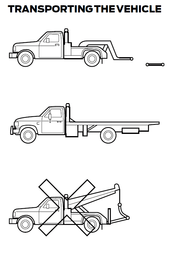

As @jkeaton says, the manual has your answer. It says there is a manual available to professional towing companies with guidance on towing these vehicles.
For the owner, in the section on Roadside Emergencies:
Ford Bronco Sport Towing Bronco Sport on a dolly Towi
Towing an all-wheel or four-wheel drive vehicle requires that all wheels be off the ground, such as using a wheel lift and dollies or flatbed equipment. This prevents damage to the transmission, all-wheel or four-wheel drive system and vehicle.
Do not let anyone tow your car. It must be transported on a flatbed or with dollies under all four wheels.
