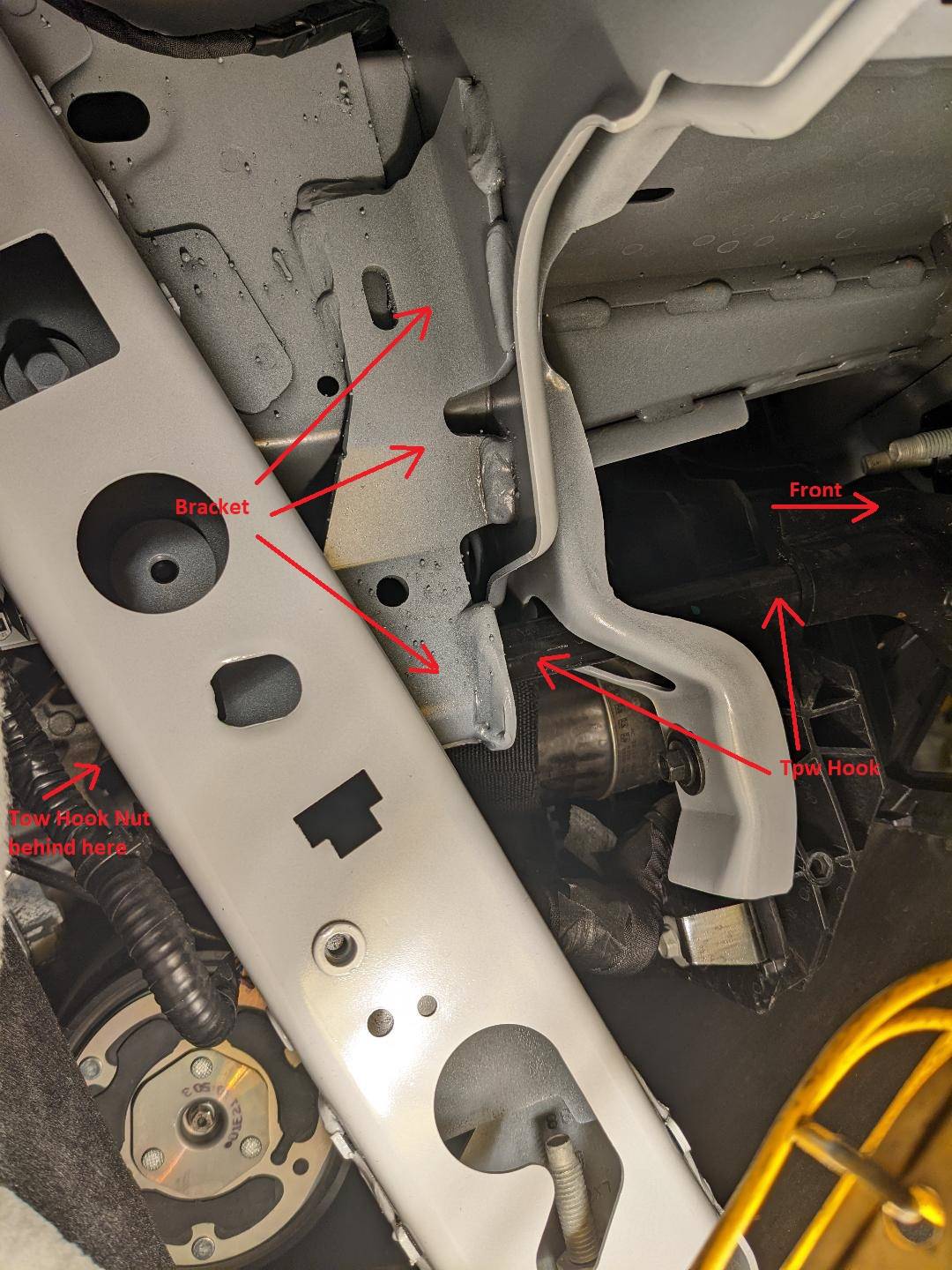

Pretty sure you can get to those nuts through wheelhouse fabric liners. No need to remove bumper.
That is probably true. I think it would be best to remove all the fasteners for the tow hook after removing the felt wheel well liner. Just more visibility and accessibility.
2,328
3,262
This picture was taken with the passenger's front tire off and the felt liner pulled back. Should be able to get that rear nut off the tow hook with tire off and felt liner pulled back.
Ford Bronco Sport Tow hooks Tow Hook Bracket Annotated
