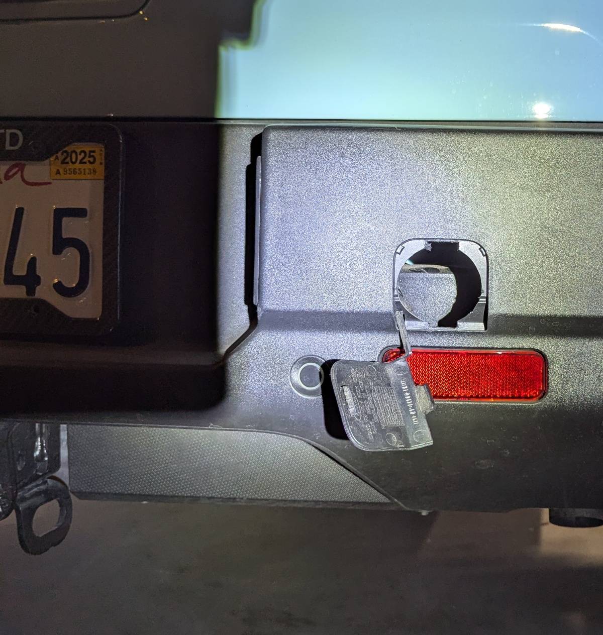

FWIW: I have a Heritage Limited, which is supposed to be basically a Badlands with the Heritage color scheme...2L, suspension, etc. And the Badlands (and not other models) has the provision for the screw-in hook behind that little cover in the rear bumper fascia.
Guess what: They did NOT include that provision in the Heritage Ltd! So I'm screwed...or not screwed, since there's no place to screw it!

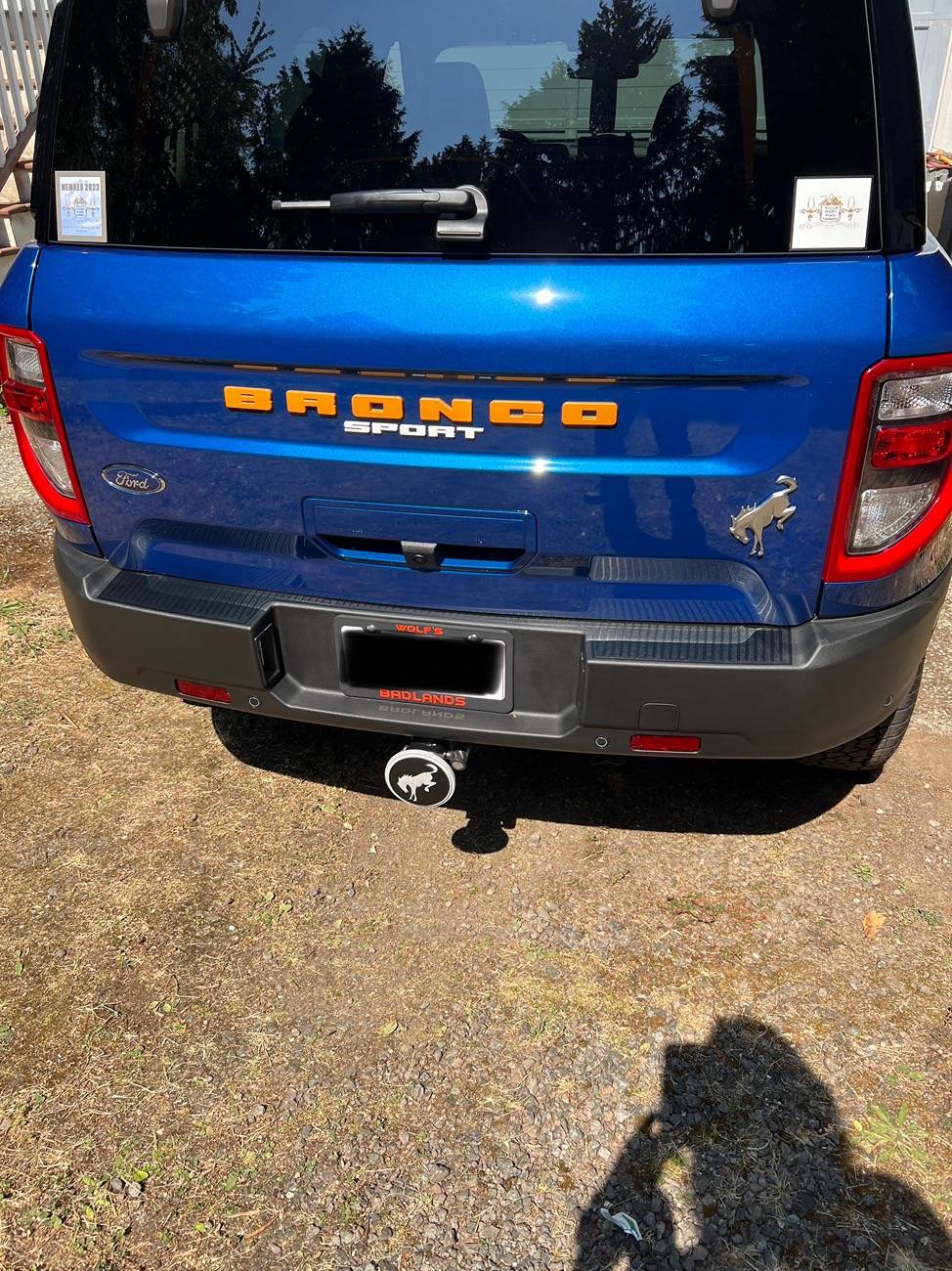

Should still be the same bumper. The access should be a pop out piece of black plastic just above the right red reflector/light. If you zoom my picture you can just make it out. Mine does me no good since I have the factory tow package that covers/blocks the underside of it, but I located when I had a 2022 without the tow package.

Pop open the little cover, and nuthin but blank steel. Is this part of the factory hitch?
