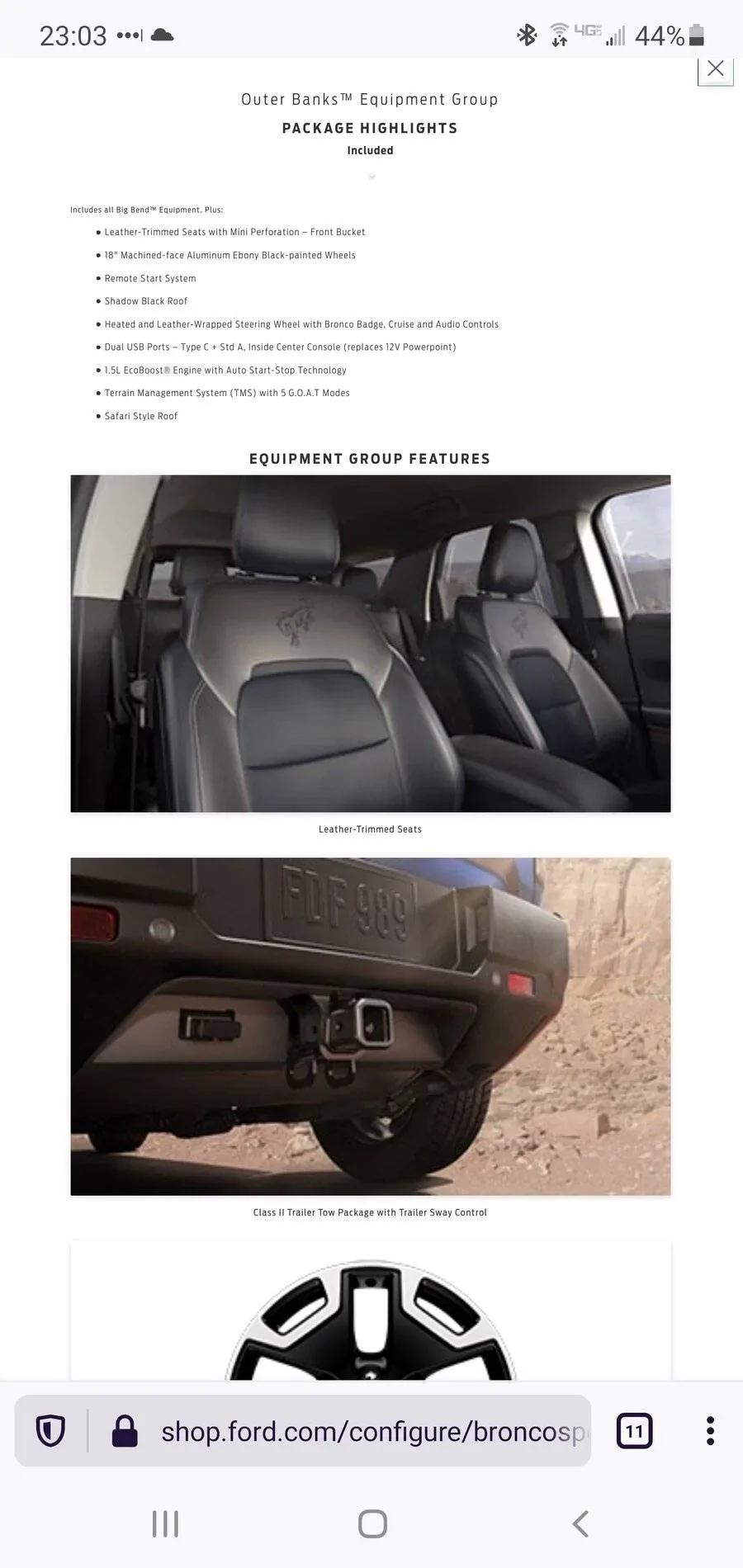

So. Online (build and price) it shows ob+ob for $1595 has a tow hitch. Unless I read that wrong. I just gave $500 for a deposit and they added tow on top of ob+ob+copilot 360

I'm pretty sure the tow package is separate but it is confusing. They show the hitch in the picture but it is not in the description you show, or when you add the package on the builder:
Ford Bronco Sport Tow Hitch Dealer Install? 1617307790305
FWIW on our OB without the OB package it was extra, but well worth it given what the harness, hitch, and installation costs 3rd party.
