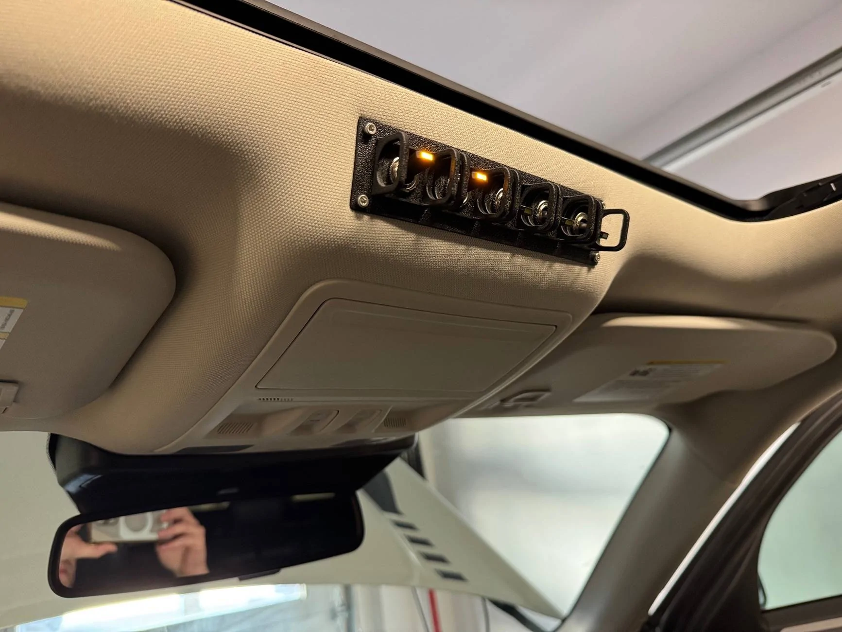

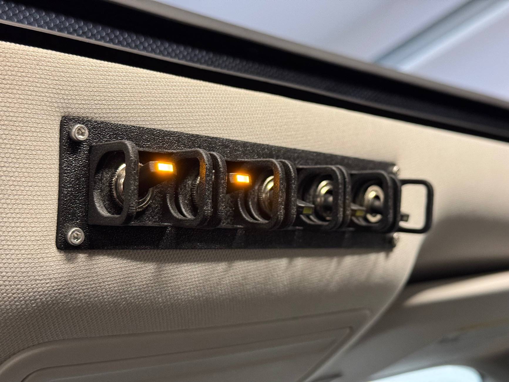

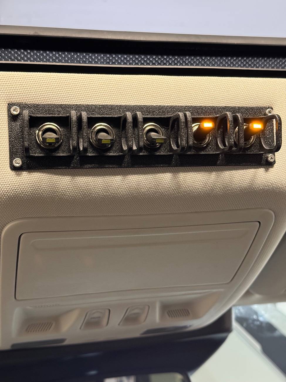

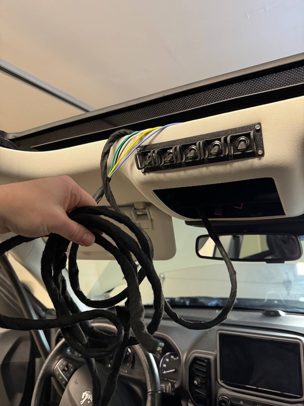

No need to wait for a 2025! Continuing on my customization spree; I designed and printed this toggle switch plate with NASA style switch guards. The switches control relays in the engine bay; two will control diffused floodlights on the sides of the car. The rest are open for future expansion. Super stoked on how this came out, listen to that THUNK on the switches! I’m also glad that the switch lights are basically dead on to the yellow-orange color the OEM buttons around the cabin show when toggled.
Designed in F360, printed in Carbon Fiber Nylon (both because it’s strong and it looks really cool)

Very nice if ours had a sunroof I would use that spot for switches also. Different roof panel thought
Yea without a sunroof it would have been much more difficult to put together; still doable, but you’d probably have to drop the headliner to access that area

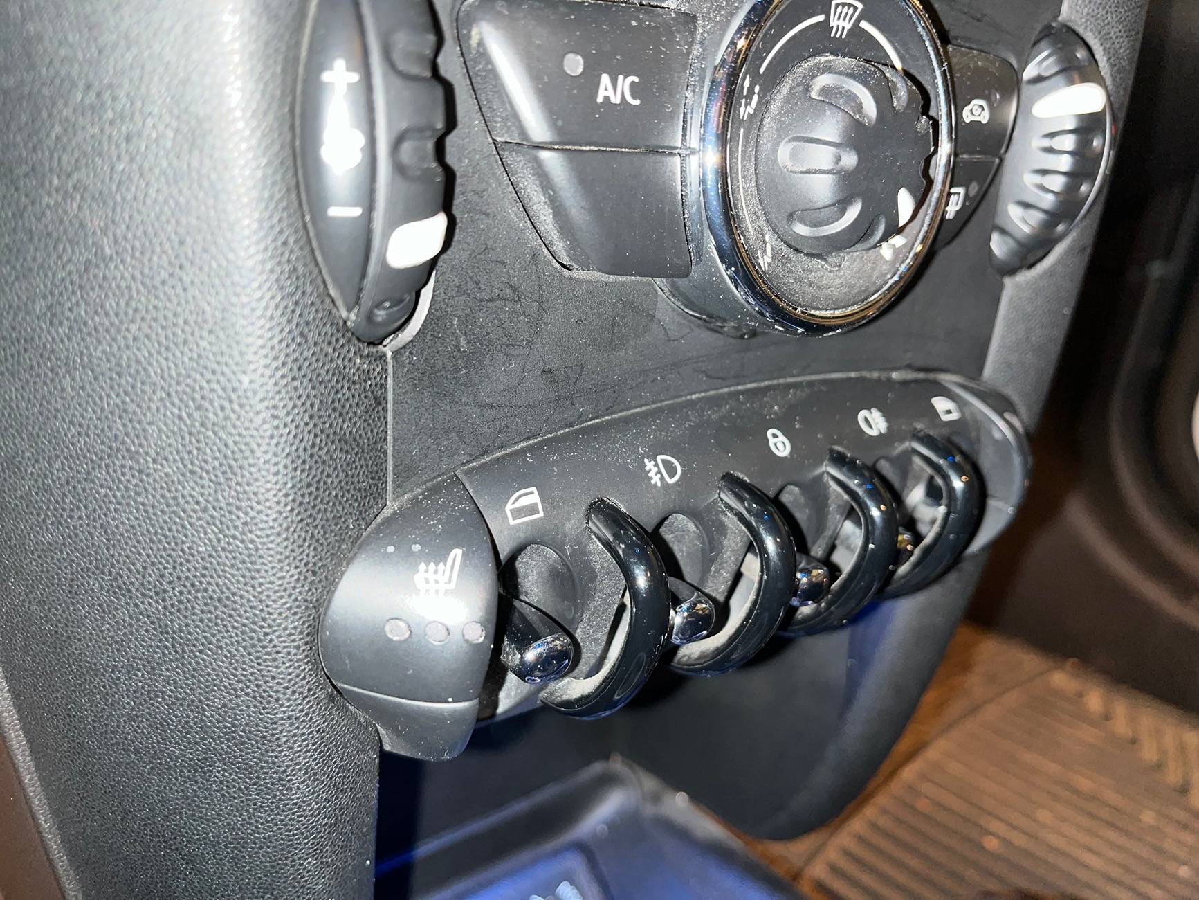

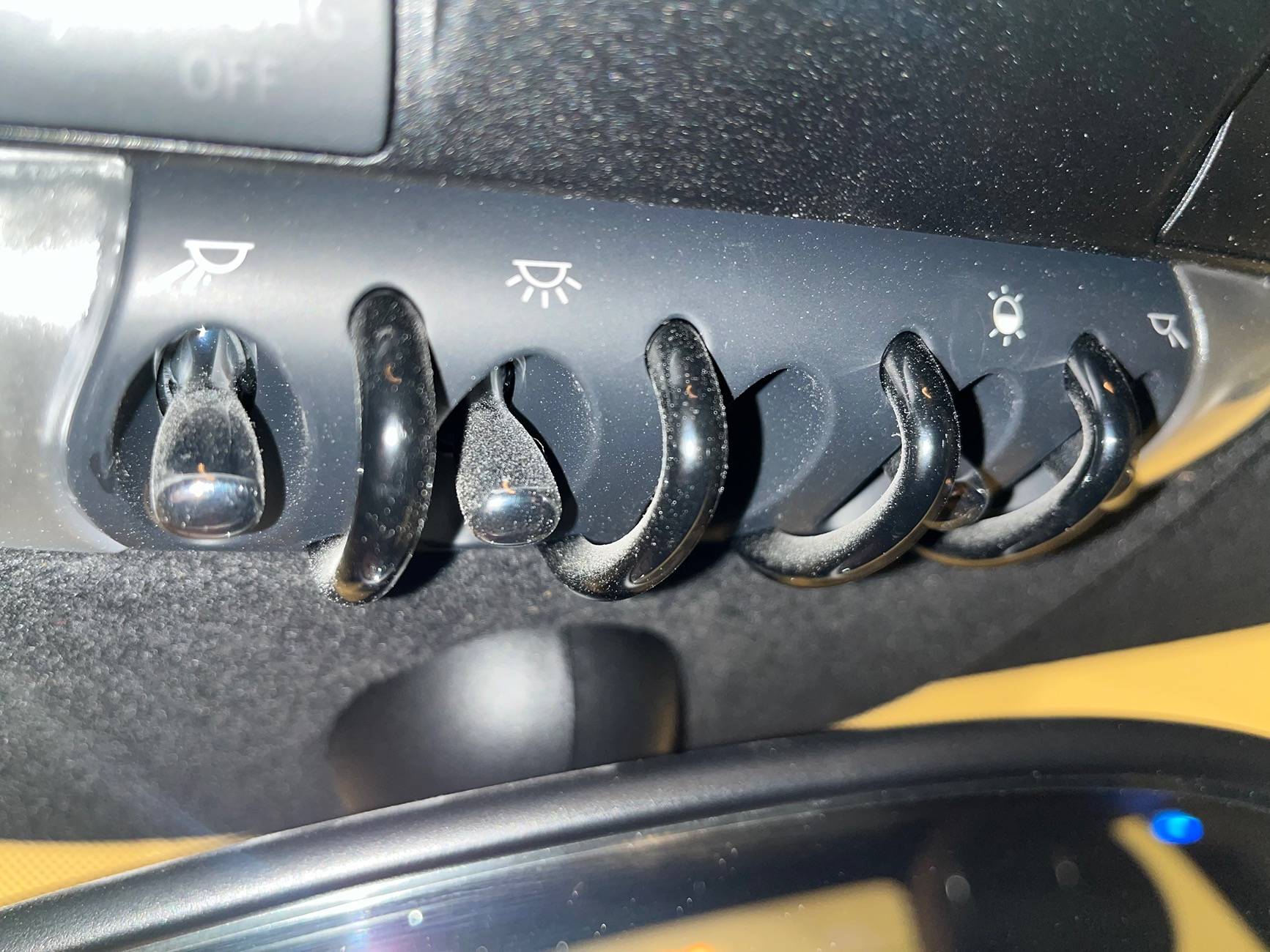

It is also the switch panel for my MINI Cooper!

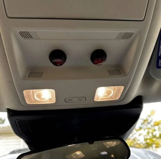

I cheated and drilled the area just b4 the sunglass holder for my ditch/fog lights

That’s also a perfect spot for it! If you’ve got a sunroof that’s where the controls for it sit, but if you DONT it’s wide open. Nice!

Thanks @Trist0n for sharing your switch panel build. I’m starting on a similar one tonight. It’ll go in the vacant moonroof control panel like @Mwittke5857 showed.
