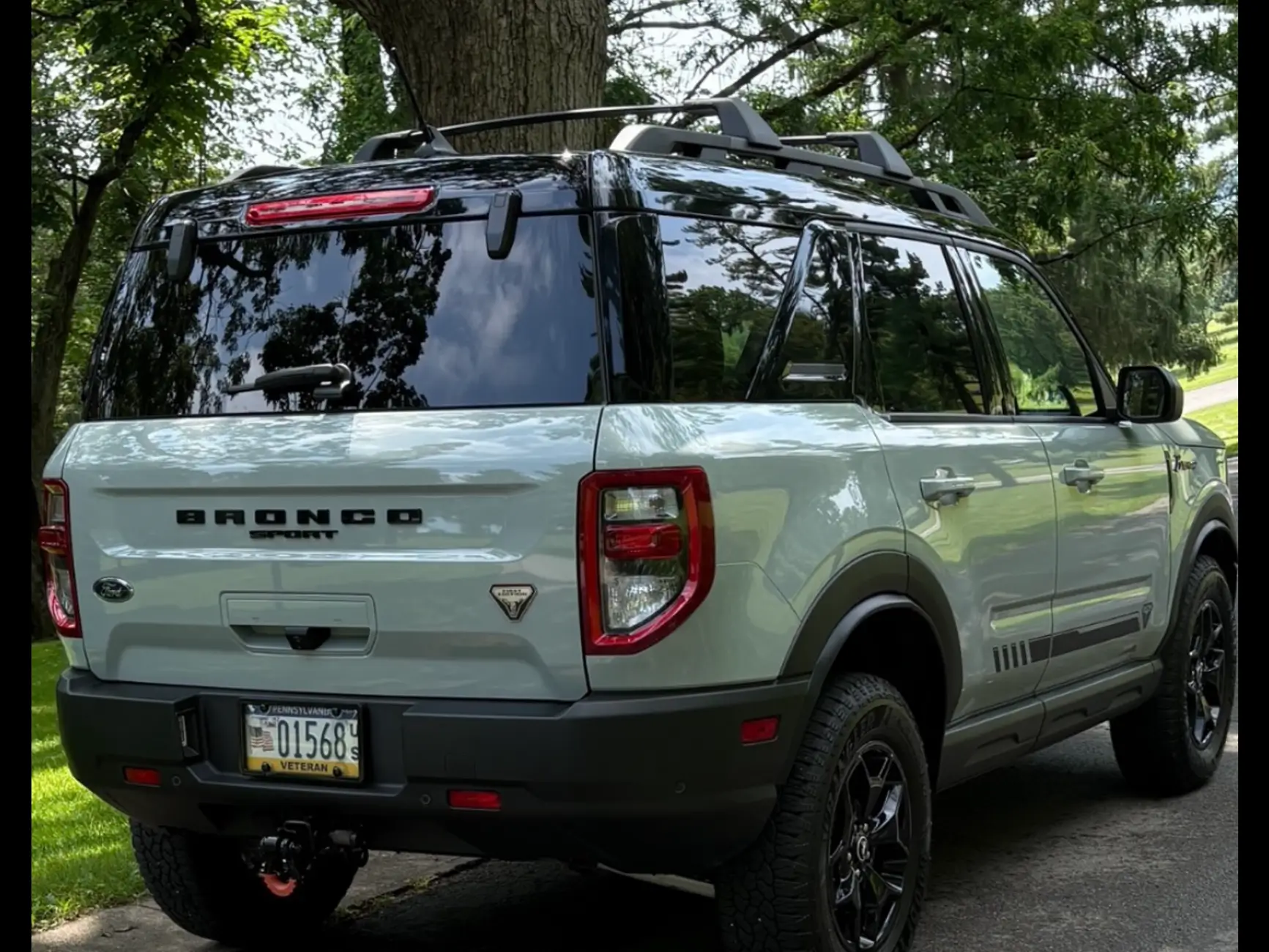

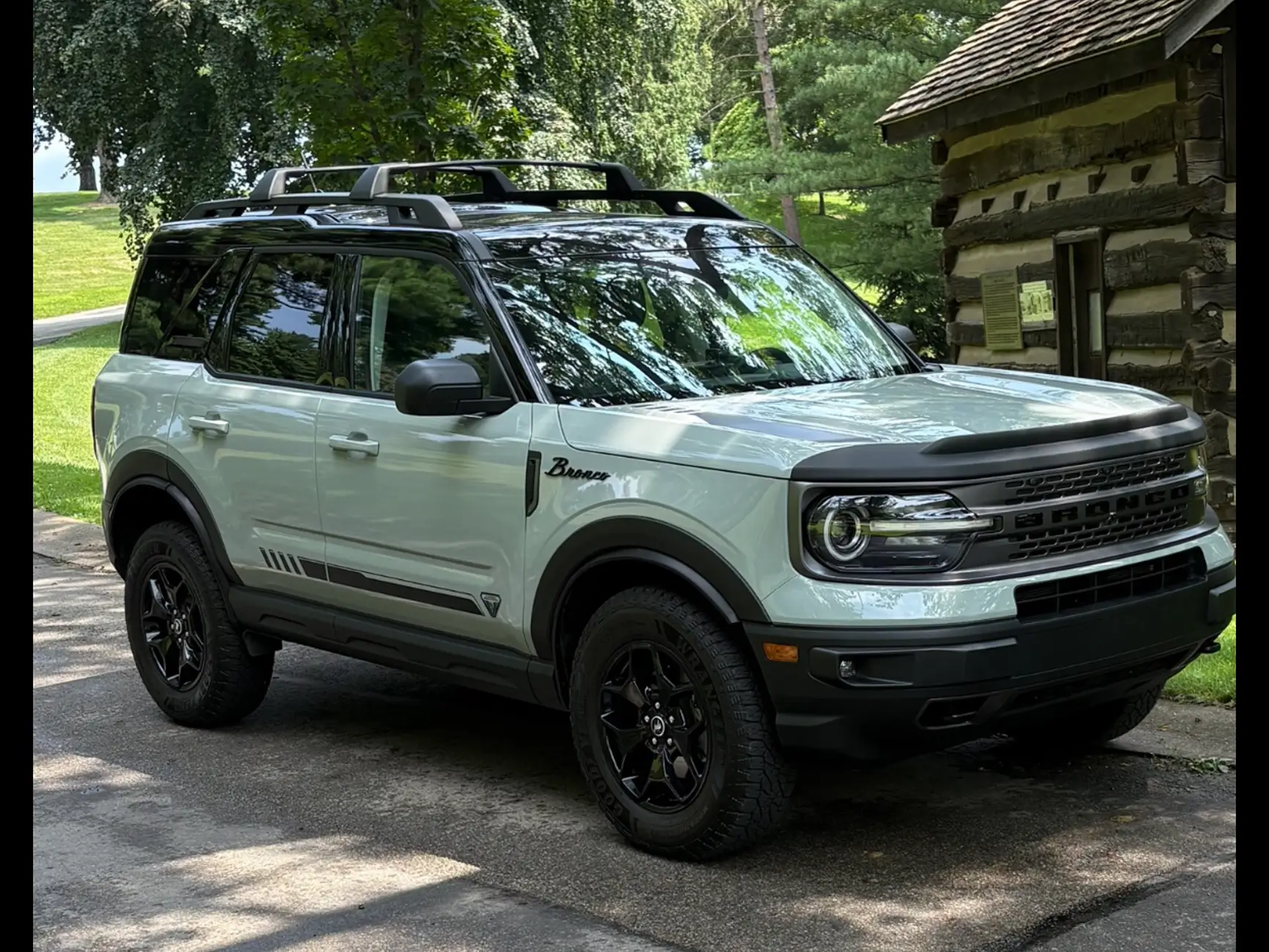

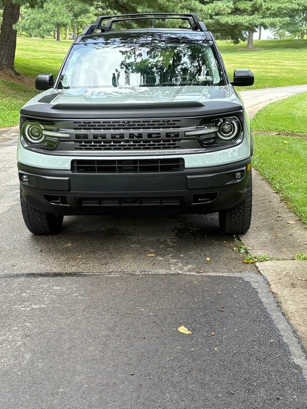

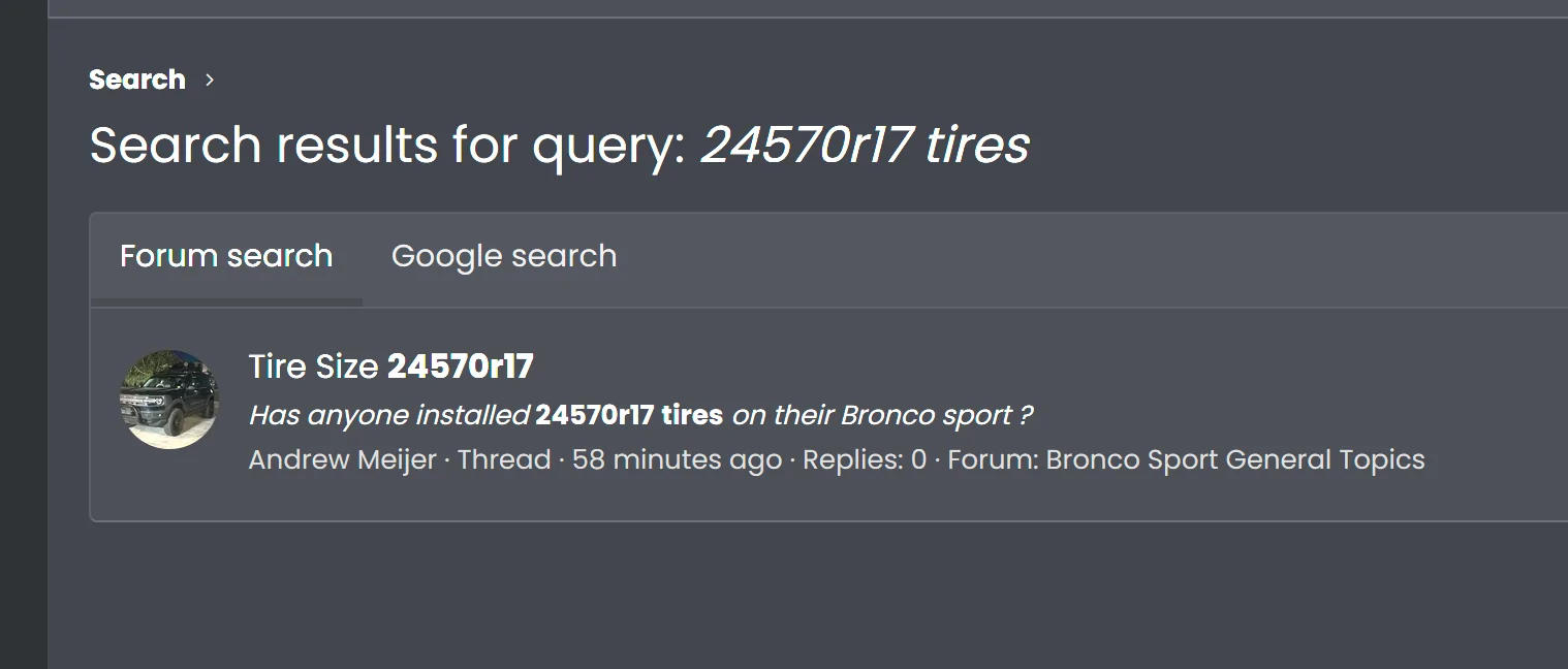

I'm really surprised that there are no hits searching that tire size, except for this thread of course.

If you put the slashes in like they should be you'll get hits. 245/70/17 will get you results

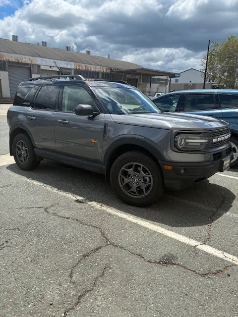

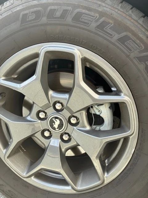

I have 245/65/17 on my Big Bend Sport with a 1.5” lift. Now if Juanchoch is fitting the exact same size tire, I have, on his stock sport as I am on my lifted one, I don’t see why you couldn’t fit the the 245/70/17’s on one with just a 1.5 lift and you shouldn’t have to bend or pinch weld. Of course that is just a theory but you are adding just under an inch in height(diameter) but not width vs my setup. Go to a reputable tire shop and see what they say.
