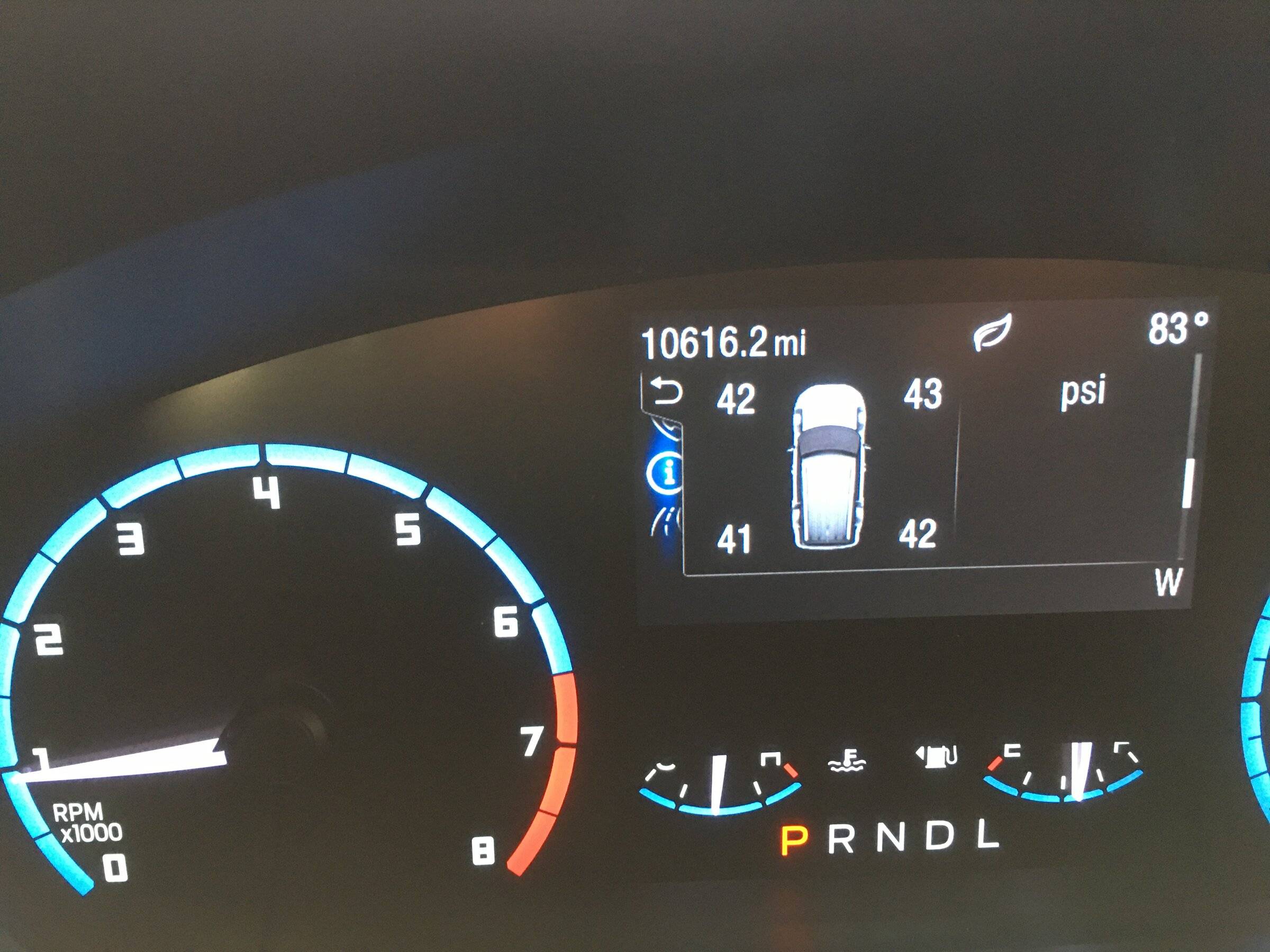

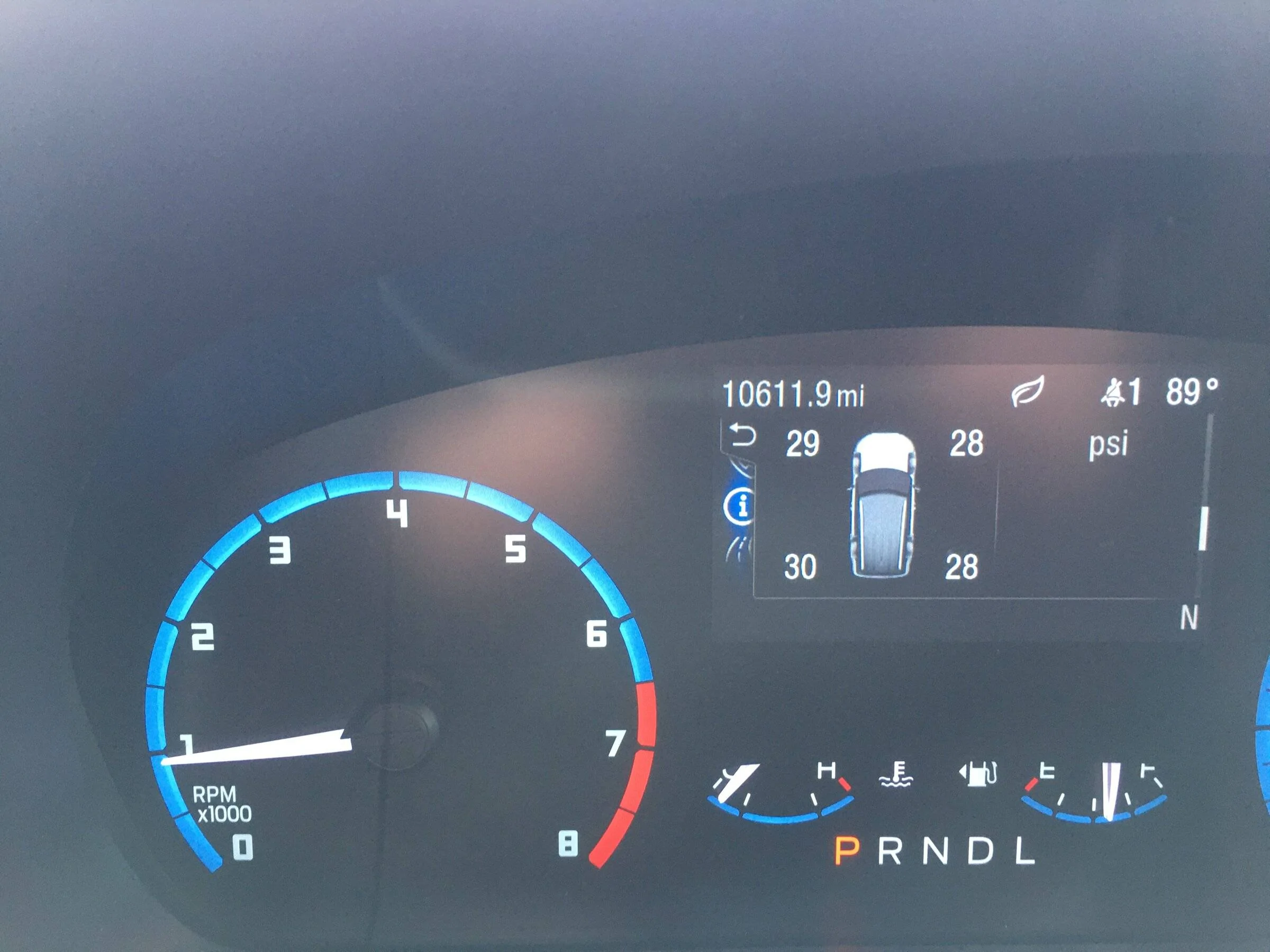

My two cents worth on the sensors. Just picked up my Sport form dealer completing 10000 mile service. A asked to have the tires looked at closely as I was getting low tire pressure warning on left rear. All sensors seemed to indicate low even after airing upon the tires to 33 PSI +/- . I say plus or minus because I don't trust the self service air pumps to be accurate. So after the service, before leaving the dealership I checked and the first picture shows the readings. After getting home (5 miles) the second picture shows the readings- avg 10 psi higher than what I was told the dealership aired my tire to. I'm checking them in the morning before a trip to Tampa and again once I reach my destination. So far I have no confidence at all in the system.

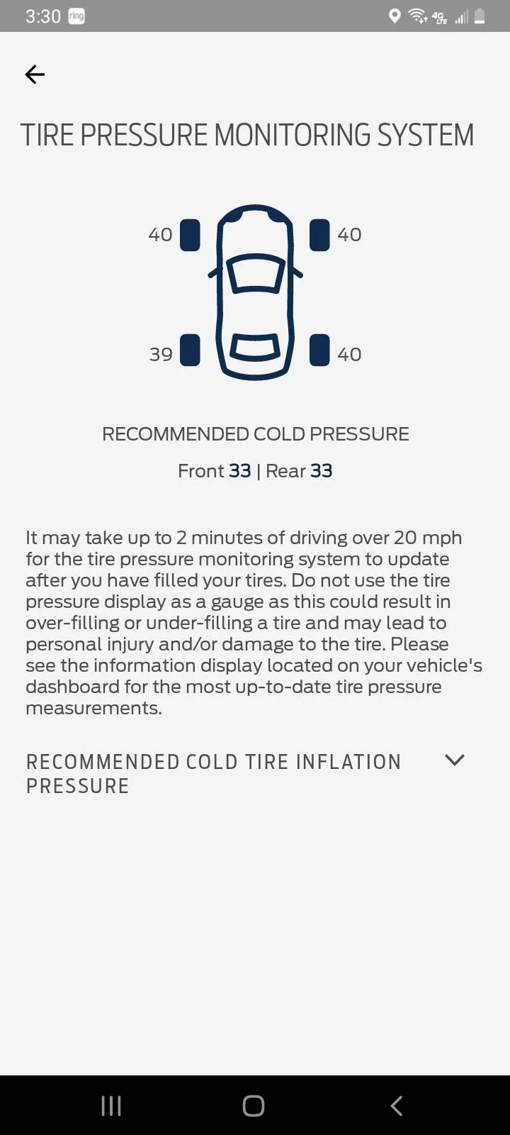

Ya 43 is to much.. but y9ur 29 isto littlle. 33 is recommended cold pressure. I put mine at 37 in summer and 40 winter. Thats today after driving
You should only be checking/setting pressure before driving. Tire pressures will increase as you drive and are irrelevant as long as the cold pressure is ~33 psi.
