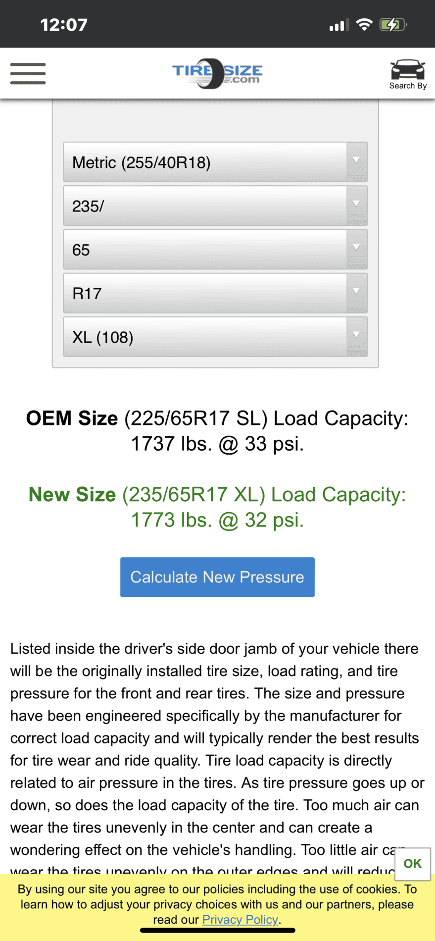

I had mentioned the other day about tire pressure for us that have installed larger tires on our BS. TireSize.com has some great info on what tire pressure you should be running for the size tire you enter. You have to enter the size that it came with and the factory tire pressure. As an example, I had 225/65/17 and put on 235/65/17 and my new tire pressure is 32 psi. Now, Toyo recommended 28 psi cold but it never reached 32 psi. It only got up to around 30 and one got to 31. I adjusted to 32 and this made a noticeable difference. I also used the chalk test based on this info and almost spot on. I’m leaving it at 32.
