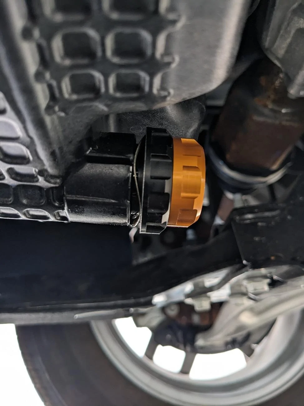

Just did an oil change at 7,551 miles on my 1.5L Badlands. It had been about 5,100 miles since the initial oil change. Pretty easy and painless. Had bought a pair of polymer ramps (which conveniently came with rubber anti skit matts and wheel chocks), drain pan, Pennzoil PZ-21 filter and 2x 5 quart w5x20. I had installed a Rival alum skidplate earlier. Only took about 6-8 minutes to take it off (10 bolts!). Yellow drain plug came out easily...I heeded earler warnings and carefully pulled it out to slow the flow of oil, so there was no splash, no mess. Installed a Ronin oil plug, replaced the old filter (needed channel locks to pull it out) and filled it up. about 50 minutes, including reinstalling the Rival skid plate. Probably could cut it down to 40 minutes next time.
Ford Bronco Sport Tips to not make a mess - diy oil change PXL_20240728_155521921
