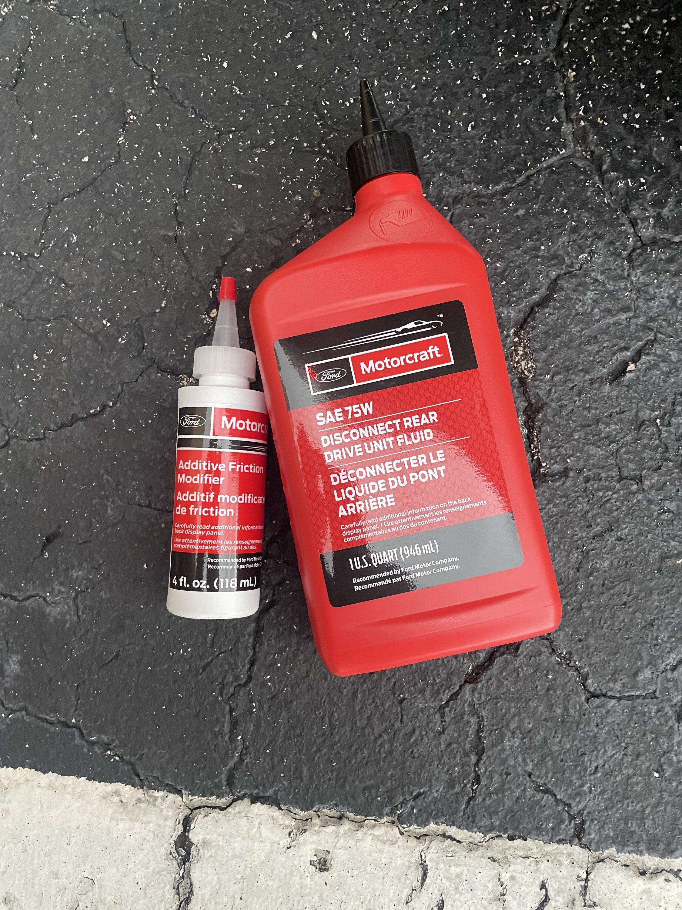

See pics and part numbers below.
Did the same on my Sport and it’s the smoothest it’s ever engaged and turned since the day I bought it new and the chatter went away within a few miles of driving.
Mix the full bottle of Friction Modifier with the full quart of RDU fluid and shake it good. Drain your RDU and fill it back up with this mixture.
The entire process took 10 mins.
1- 75 W RDU Fluid from Dealer
1-XL-3 Friction Modifier from Dealer
1- 12.99 Fluid Hand Pump from Auto Zone.
