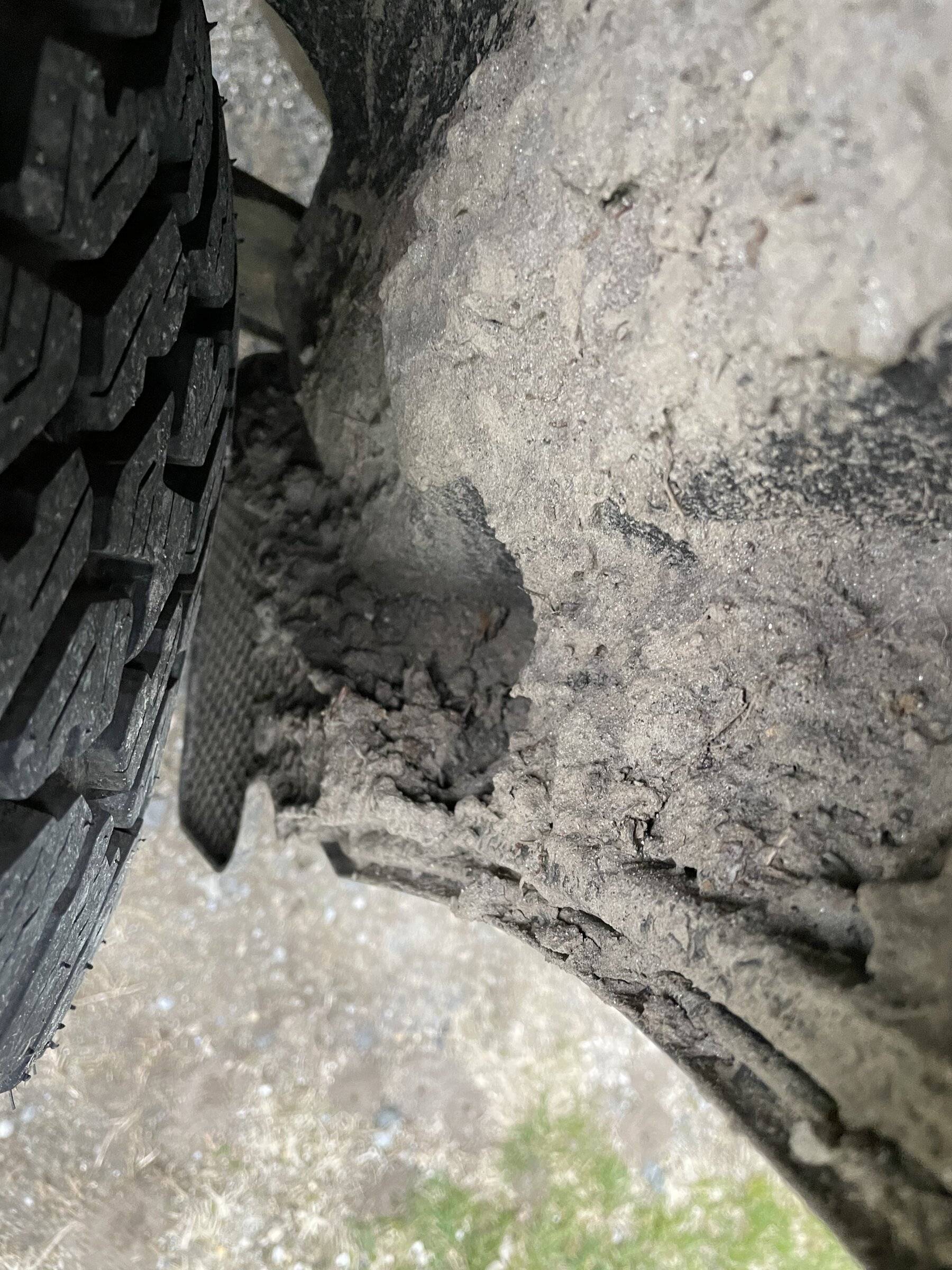

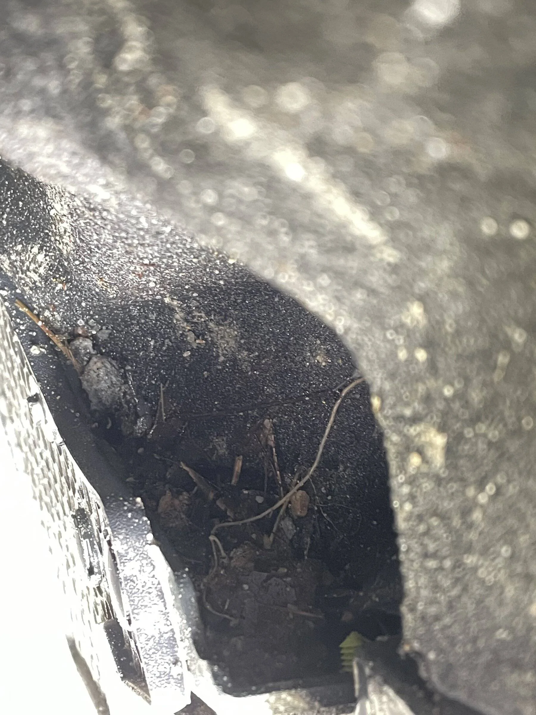

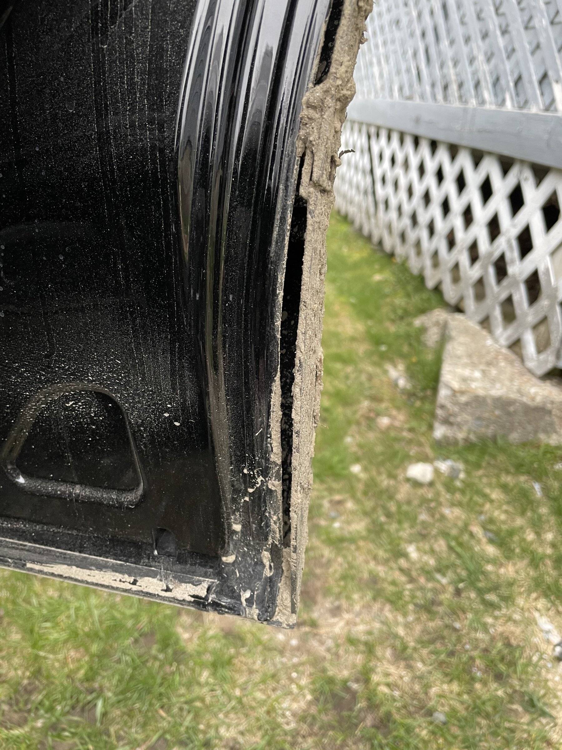

So the back wheel wells have pockets where the little stone guards attach that catches everything, and the back doors have pockets also. This is from normal driving, mud/stone is from unmaintained county crossover road.
The pockets I have to remove the stone guards to actually clean out, and the bottom of the doors fill with shit in that seam. This is gonna be brutal in the winter with ice build up North. And the salt mix that is gonna live between the panels and destroy them. I’m gonna have to spray out the rear doors with every wash. Wtf dumbass designed this setup, I’m assuming same one that put the ecu in the fender. The vibration of the door panel is gonna sand off the paint.

All of the rear doors are built this way. Saying is a dumb design. There’s a gap between the metal panels that will fill with stuff which can cause damage, especially when freezing. Open your back doors and you’ll see the gap I mean.

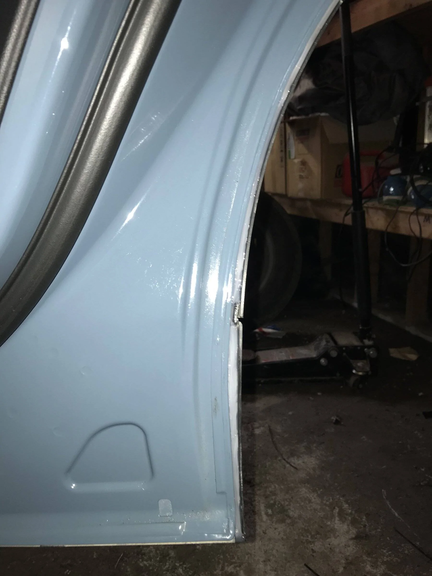

You can fill the gap with clear calk like I did. I had dirt getting flung into mine too.

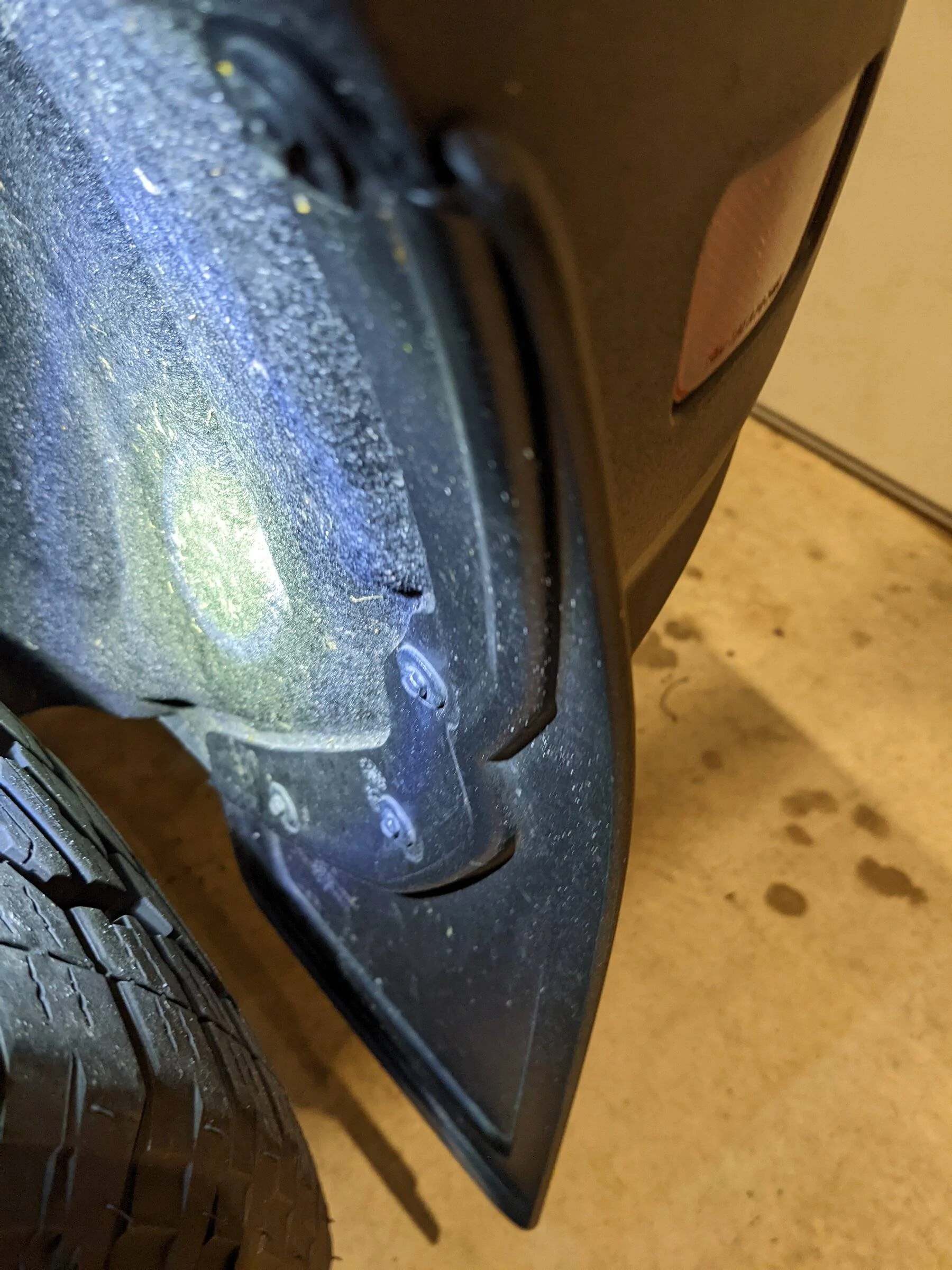

My factory installed mudd flaps sit flush no areas that can collect debris. These are the cheaper $200 option flaps. I see gap on rear door trim but I don't have any dirt built up in mine yet.

Ok in front or rear tires yes gunk can built up. Take hose squirt it out regularly or remove them. You should be squirting out wheel wells on regular basis anyway.

He’s talking about the little ones that go in front of the tires.

Yep now I see. Squirt out with hose on regular basis wont be a problem or remove them. Wheel wells should be squirted out kept clean on regular basis on all vehicles or yes they gonna rust out.

JTNEWTON7814- Yeah I saw you did that in another thread. Keep me posted as time goes on. My concern in the northeast is the water, slush, ice and constant freezing temperatures. My taco would freeze up and rub the tub on the sliders from the winter freezing mess and would have to chip it out. But the BS, no way I can get to that. It’s the freezing and expanding in there I’m concerned with. All my other vehicles had a rolled edge. Never this open area in door.

No the problem area you show is in front of rear wheels. I showed pics of flaps that go in back of wheels.
If you live in freezing climate where you can't hose out regularly you could just remove those flaps in front of rear wheels. I believe they are there to direct wind away from tire for fuel economy. Or fill that void with black RTV.
On mine I have gap between felt wheel liner and rear wheel well. So far I been hosing out when I wash it. Gaps between front wheel liners and front fenders to so those need regular cleaning too.
