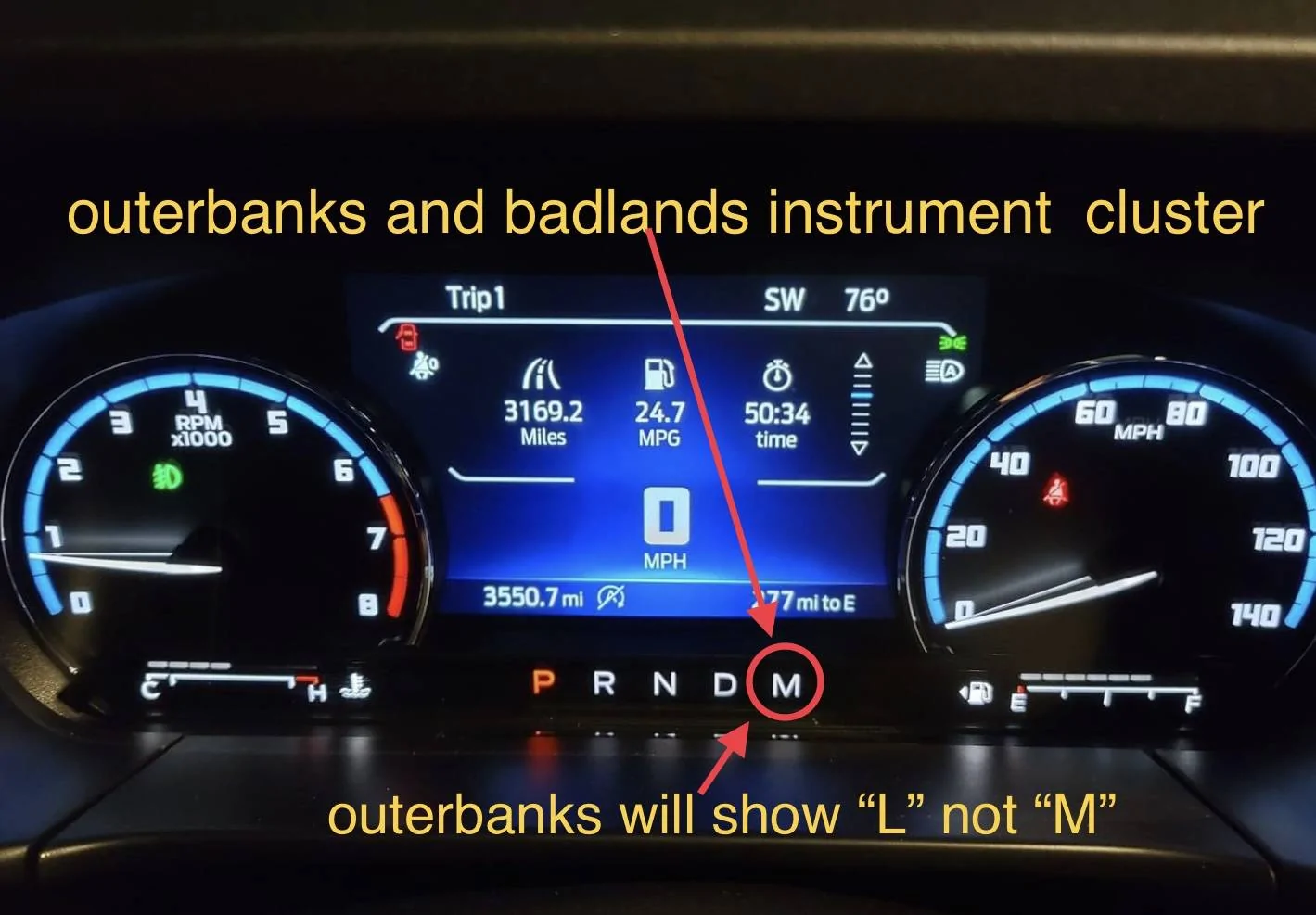

My '22 OBX was experiencing issues with gauge cluster blacking out earlier this year. I was told that they needed to update the Sync software and that would fix it. When that didn't, they replaced the APIM. When that didn't fix it, they replaced the gateway and the display. I never did have an issue with the infotainment screen through the whole thing.
Sharing as an FYI, that updating the software may not remedy the black screen.

You referred to the “gauge cluster blacking out”, I’m guessing this is the instrument cluster. The sync updates and APIM apply to the 8” Display screen and would not solve an instrument cluster blackout.
Replacing the gateway module likely was needed and replacing the instrument cluster makes sense. My guess is the dealership simply did the sync software updates first only because it’s always good to bring sync up to date then got around to replacing the instrument cluster because there are a number of possible causes for a blacked out instrument cluster.
But why they would replace the APIM is a stretch, don’t know what they were thinking on that.
