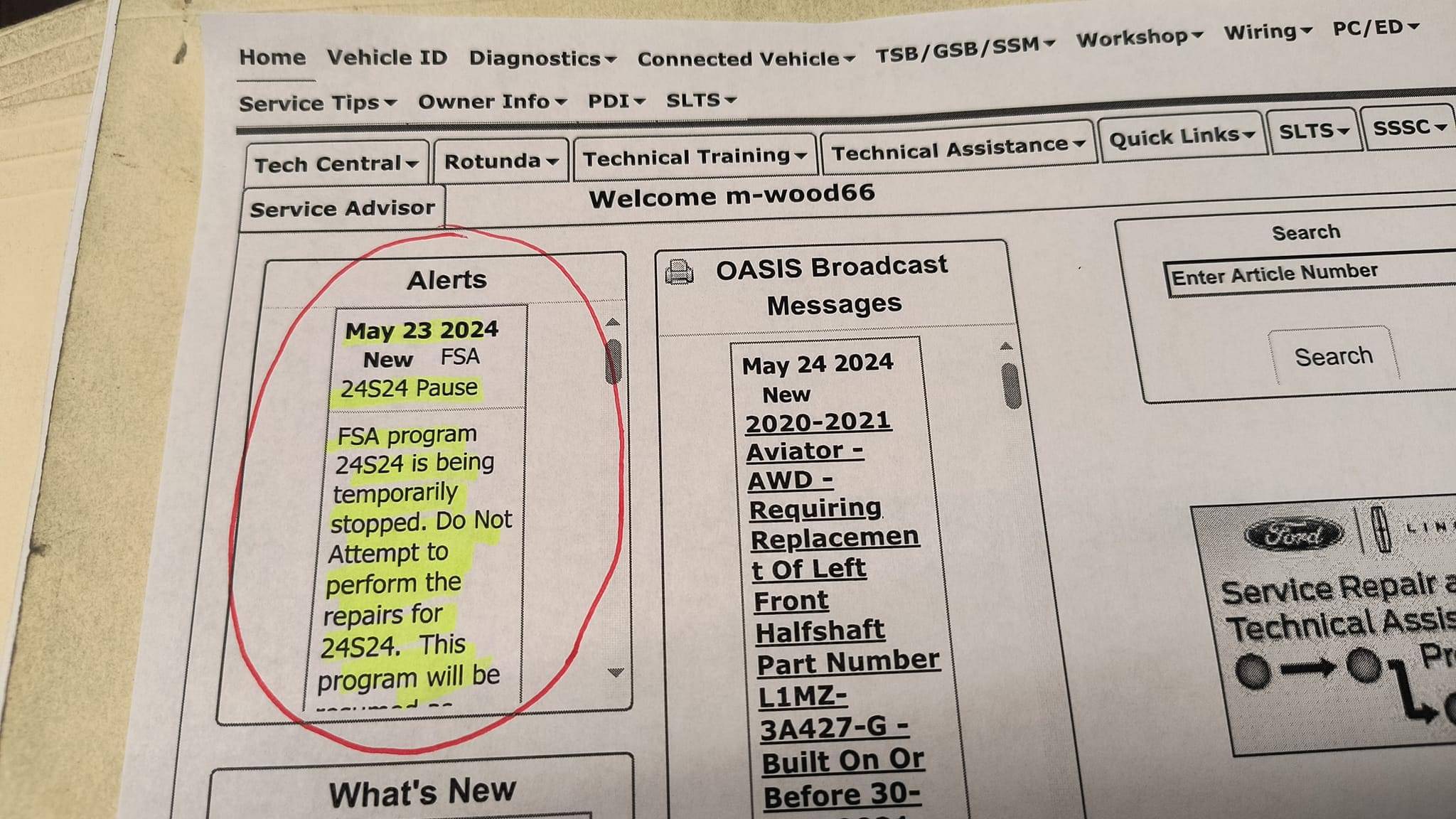

Yesterday’s update:
May 23 2024 New FSA 24S24 Pause
FSA program 24S24 is being temporarily
stopped. Do Not Attempt to perform the repairs for 24S24. This program will be…
Ford Bronco Sport The new Recall is out now. IMG_4381
