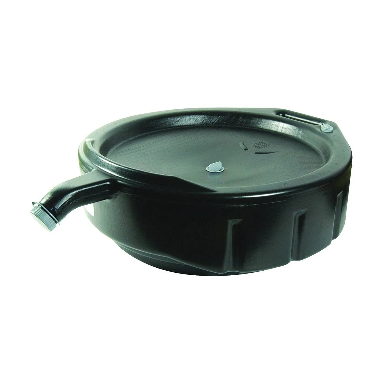

this is the oil collection pan I have been using for years. never leaves a mess. made by flo tool

That's identical to the one I use which I referred to as 'a large 15 qt. pan.' I originally bought it for our Sprinter-based RV. The V6 turbo diesel takes ~13 quarts.
The diameter is large enough that if it is positioned just right it will not have to be moved -- it will catch all of the oil, from the initial flow toward the front, to the final bit that flows backward toward the rear.
That worked well for the first 2 oil changes. This time there was some brain fade/operator error. I had the pan positioned to catch the initial flow of oil, but had it a bit too far forward. Then I let the oil drain while I did a quick brake job and tire rotation... :cool:
Anyway, even with the 15 qt. pan, it's best to just keep an eye on it and slide it back once or twice.
