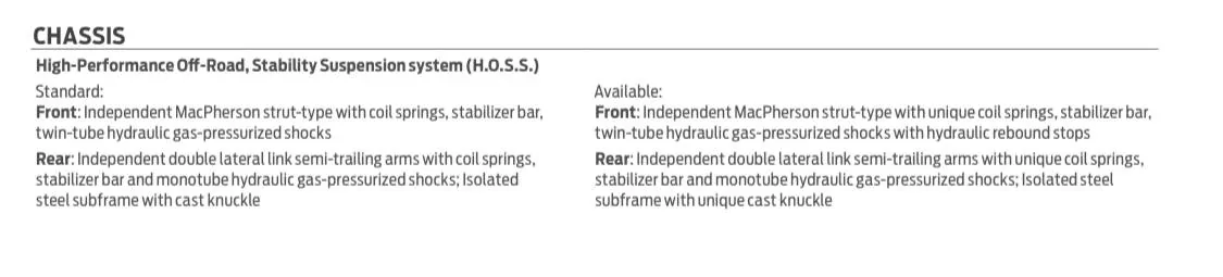

What are the technical differences between the suspension systems? It appears to have “unique coil springs” and “unique cast knuckle”
also ford doesn’t provide ground clearance numbers for the badlands without The optional 29 inch tires. Does anyone know the clearance without them?

I guess I was wondering the difference between the badlands suspension and the base/bb/OB models.

I think its about 1" more ground clearance with the BL .

So it appears that the badlands without the larger tires pretty much the same clearance as all the other models but has heavier duty shocks and knuckles?

No. The base and Big Bend have 7.8" of ground clearance. The Outer Banks has 7.9" and the Badlands has 8.8" with the optional 29" tires (I believe it's 8.6" with the stock tires). Could be 8.5" on the stock Badlands as the Falkens are showing as 29.1" tall and the stock Pirelli's at 28.5" so .3" more to get to 8.8".
And remember the Badlands also has the Advanced 4x4 with Twin-Clutch Rear Drive Unit (i.e. rear locker like the Focus RS).

the pirelli tires are .6 inches smaller so it would be 8.5 then it seems.
