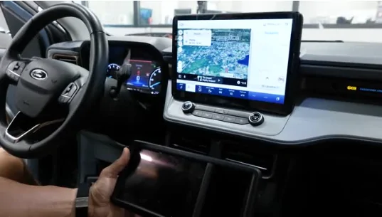

The other kit will include a large 12" touchscreen display along with the hardware needed to mount it in the existing location where the 8" screen is. I do not have pictures of the set up yet, but this is what it looks like on their Maverick Sync 4 upgrade kit:
Ford Bronco Sport Sync 4 Upgrade kit coming soon to a Bronco Sport near you from Infotainment! 1762290626878-pi
The 12" upgrade kit will allow you to enable the UnReal theme for the HVAC contols on the touchscreen if desired.

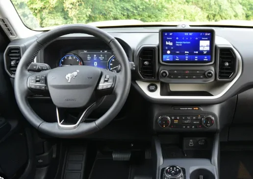

I thought the vents were on either side of the '21-'24 8 inch screen.
Having trouble visualizing how a 12 inch screen would fit in the same center console.
Agreed.....not sure how they plan on pulling that off.

The shape is exactly the same, relocate the start button and it fits perfect there - a conversion kit can easily make this happen
Way too much to do. Better if the small screen works with the change to Sync4.
I was told it will be the same screen from the Maverick kit. More than the work entailed, the price difference will be significant between the two kits. I would say the 12" kit will cost 4 times what the 8" kit costs.

Just went through the service procedure to get to the APIM. Looks like I got my work cut out for me. 😬 Dash and center console both have to be partially taken apart to get to it on these vehicles.
Found that another vendor already has a Sync 4 kit for these vehicles. This is what their 12" kit looks like. I assume these guys are going to do the same. Getting rid of the physical radio buttoms seems the be the only logical way to do it.
Ford Bronco Sport Sync 4 Upgrade kit coming soon to a Bronco Sport near you from Infotainment! 1762379691026-
Given there’s climate controls on the bottom of the screen, that does appear to be the case.
Well, for 21-24 owners, the HVAC sits lower still, so those buttons would still be there. The a/c buttons/temps on the touchscreen is part of the Unreal theme that can only be enabled with the 12" APIM. So it would only be the media control buttons that dissappear and get intergrated into the touchscreen. I am not sure how I feel about that.
It would be cool if Unreal could be enabled with the 8" system since our HVACs do not show the temp on them. We'd have to adjust the temperature to see what it is set to instead of just being able to look at the screen.
