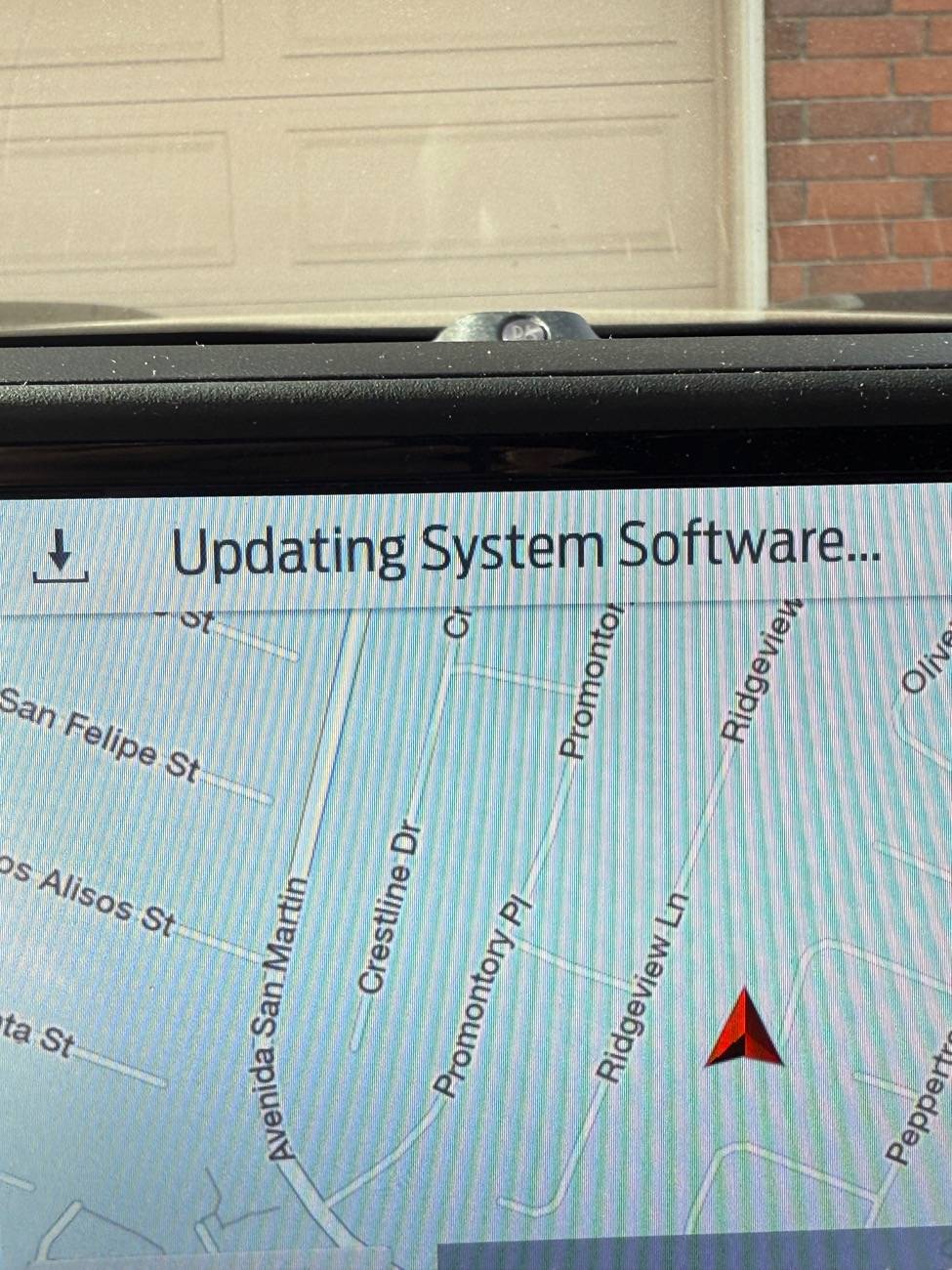

This is a large download to your Windows device or your Mac. Make sure you have a fast reliable connection. It may take over an hour to complete. My download took 7 minutes. Make sure your device does not go into sleep mode. FOLLOW INSTRUCTIONS.
You will need a USB-A or USB-C flash drive that is 16GB or larger. The flash drive will need to be reformatted to exFAT. Make sure you are using a quality USB flash drive. Ford recommends a flash drive supporting USB 3.0 or higher.
FOLLOW INSTRUCTIONS and copy files to USB flash drive. This may take up to an hour. Mine took 50 minutes.
We may now be at 2 hours.
Time to update the vehicle. This may take an additional hour. Mine took 35 minutes. Plan when taking a long drive. The vehicle must be running the entire time.
Remove any USB cables from the ports.
Insert the flash drive in the ports under the climate controls. FOLLOW ON-SCREEN INSTRUCTIONS

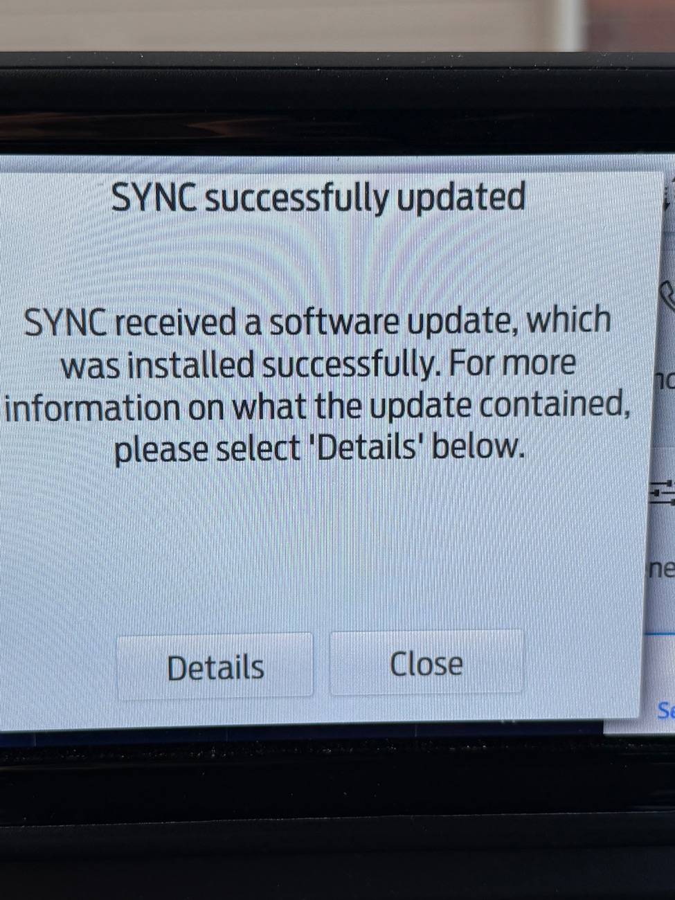

Do not remove the flash drive. Do not turn off the engine. Follow on screen instructions.
This may take around an hour to complete.
My Nav Maps are now NA 2 24
