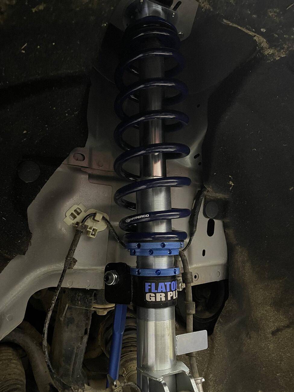

There are a number of factors that will determine the necessary end link length. The length and rate of your springs and the amount of lift you have, I’m lifted 2”.. I spec’d a 14” 212 lb spring and had to shorten the links to their shortest length but I’ve found they send different springs and different end links to different people, seemingly for no reason. When I considered going to a 16 inch 175 lb spring, I determined I would need a 1/2 to 1” short end link.
Also, they changed the end link mounts at least once after I got mine and welded them in place, where as mine are threaded and adjustable, for height, themselves.
The end links they gave me were 8" long for the Rod itself, making the shortest center of head to center of head 10".
I can't imagine you needing 12" center to center unless they sent you the 12," 175 lb springs and you had to push the spring perch way up, although I'm wondering if softer springs may be your main problem? I recommend a minimum of a 12", 200lbs spring, for all trims, in front and better, for the Badlands, is a 14", 200lbs, if you don't mind a 1.75" minimum lift, when combined with a welded in place upper end link mount, unless they have changed it's location or made it adjustable like they were originally
How about some pics of where your spring mount is and the upper end link mount.!!!!!
I went up another 3/8", in ride height, after this pic
Ford Bronco Sport Sway bar end links length. Post lift. 1734469873413-k9
The welded in place, end link mounts, I've seen, are mounted higher than where I have my adjustables, partly because I wanted to use the longest springs possible, for maximum travel.
