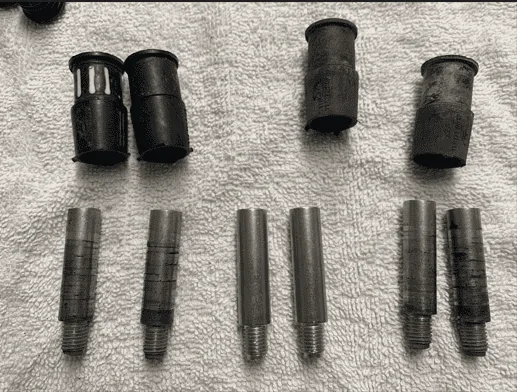

I installed the TSB this weekend (TSB 23-2308 using part number DG9Z-2C150-C). A couple of notes:
a) It did resolve my gawd awful moaning noise when backing up!
b) It was easier to install than I anticipated (the guy in the video struggled with it).
Pro tip: Get the rubber bushing started BEFORE you lube it up. Use a flat head screwdriver to get the lip of the bushing inserted into the caliper. Once it's started then lube up the bushing and caliper - it will slide right in. But if you lube it first, it will be too slippery and will be a b*tch to get that lip started.
c) The TSB kit was actually cheaper than replacing the OEM part.
OEM part = $15 per kit, TSB = $10 per kit.
I say this because if you can't get the TSB kit just replace it with the OEM parts. It will resolve your problem. Just depends on how long the bushing will last.
d) Going forward, I recommend just replacing the bushings & pins when doing a break job. Consider them a consumable.
e) Lastly, photo below showing the condition of the pins (and bushings) vs the replacement pins. You can see why they were making such noise. Don't know why the bushings are wearing out prematurely. But again, just replace them with whatever you can get (the TSB or OEM parts).
