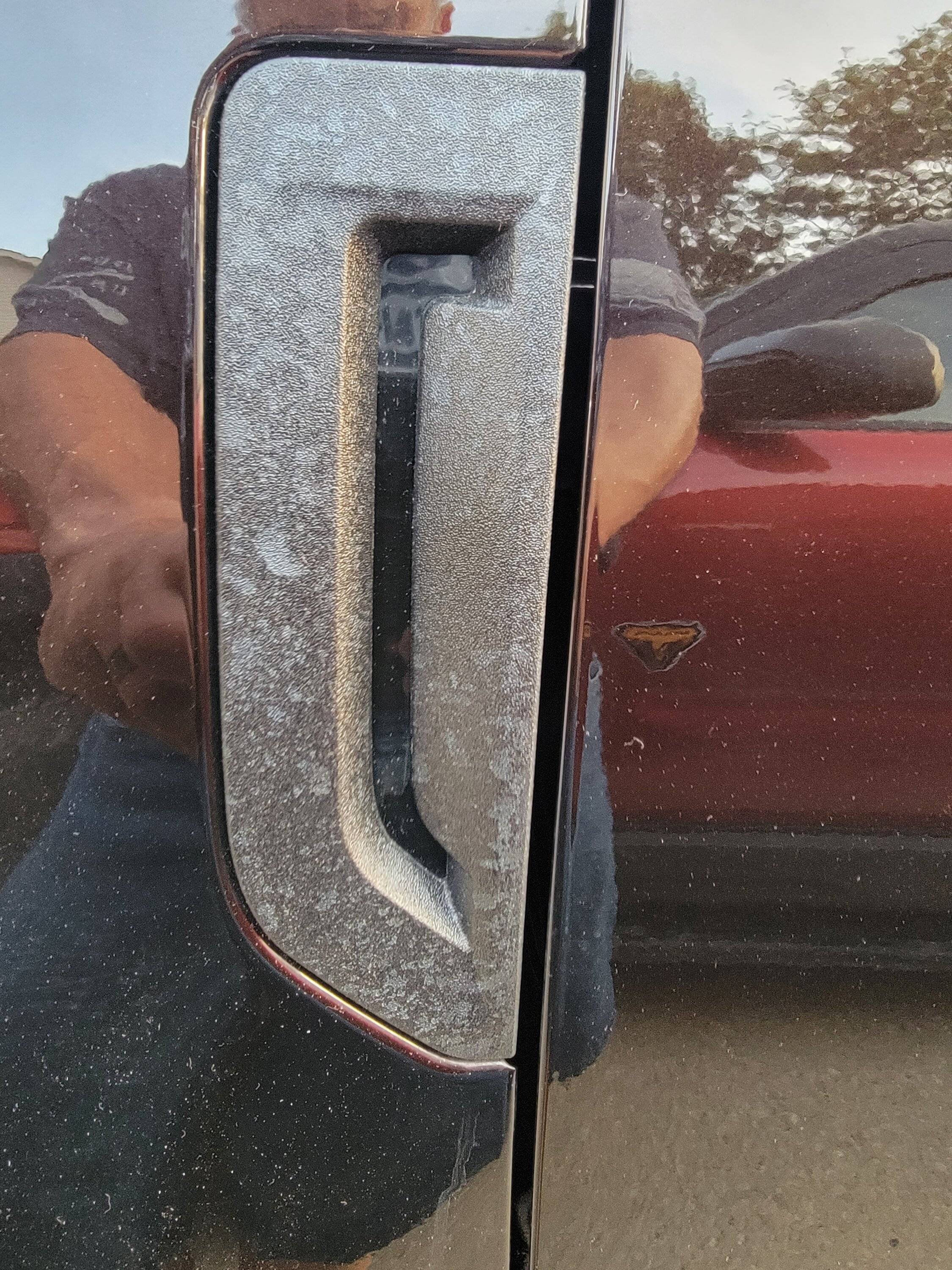

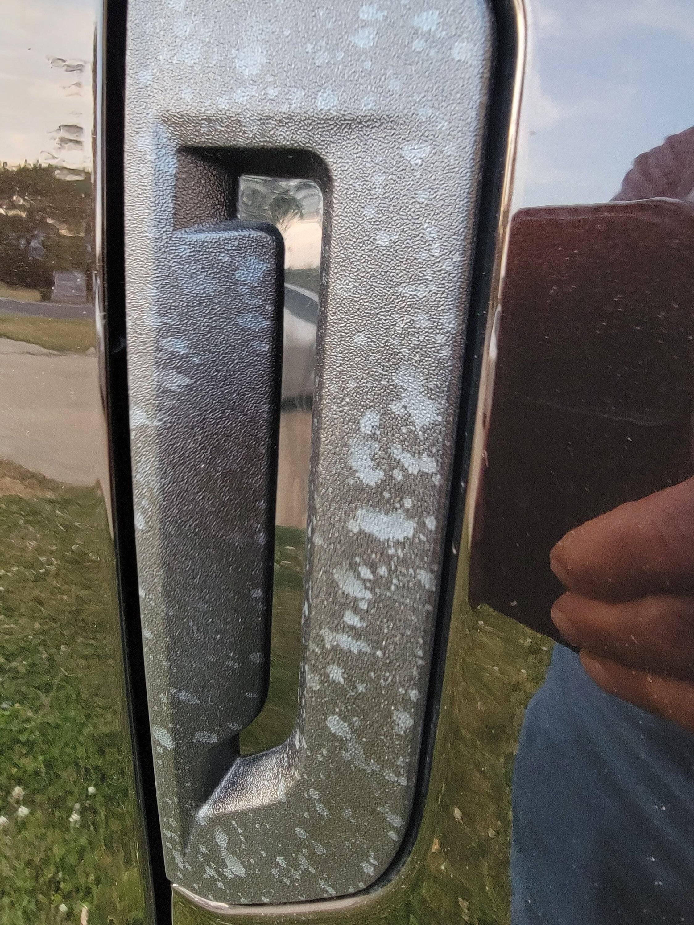

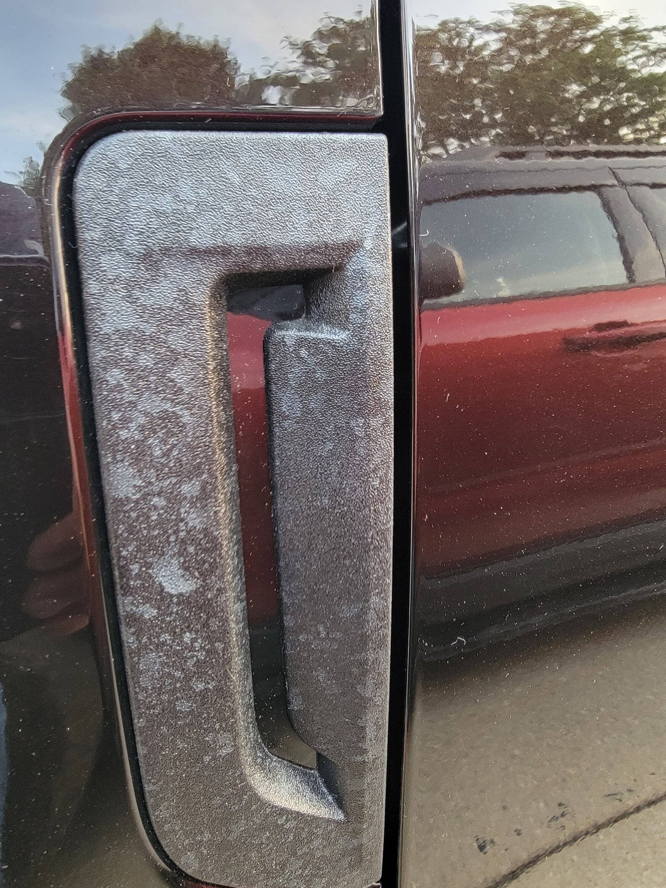

Has anyone else had this happen? Both sides. It only goes to a car wash. My other sport has no issues with the stock pieces.

Someone had something similar on the grille after going to a car wash.
Edit: I put the CeraKote plastic stuff on my trim and it seems to be working pretty well 6 months later.

It that's only the Tectico/DGE/whatever plastic doing it, I would say the item uses inferior plastic. I have had pretty good luck with Turtle Wax ICE and McGuire's Hybrid Ceramic spray on plastic pieces restoring the sheen and not leaving a wax haze. But that looks chemically altered. Probably SOL unless you want to paint or replace it.

That's the 'eventual' state of that ABS plastic for all of us. It just looks like the process was expedited on yours. You can revive it with some Turtle Wax trim restorer, but it'll probably end up right where it is again if you don't seal it somehow like @Meanderthal

Also, FWIW, there are TWO types of 'plastic trim side vents' for the Bronco Sport. IMO, you lucked out and got the one that you can completely cover in a vinyl decal in your choice color. The other version of the side trim, the vinyl decal will only cover a portion.

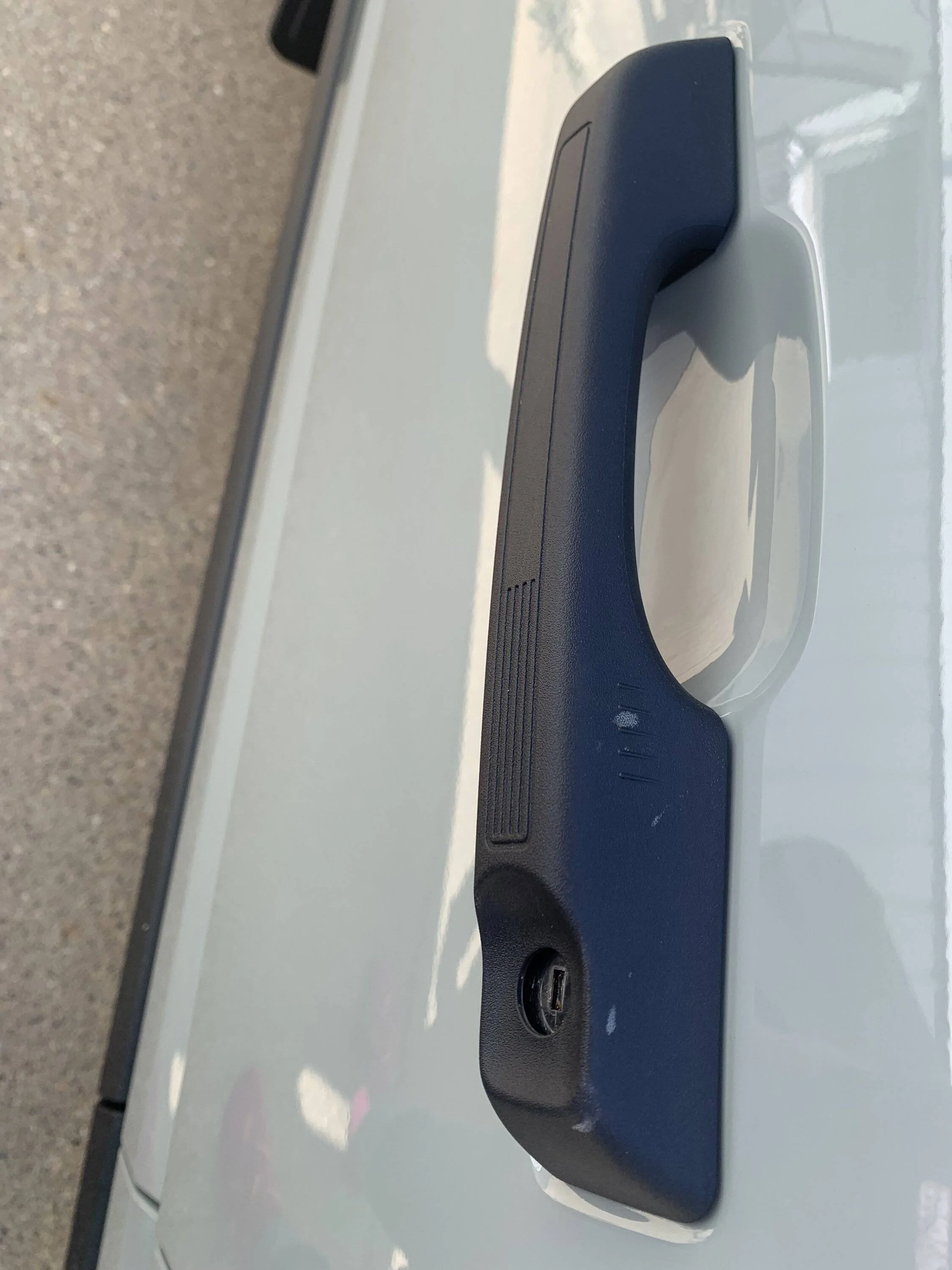

I *think* I have this starting on my drivers door handle - I got my BB BS last Tuesday, only taken it through the car wash (wand) once a few days ago.

My OE on the other sport is fine. This is the Tectico marker lights.

Have you tried using trim restorer? I personally use AutoGlym but there are many other brands makes trim restorer for ABS trims.

I treat all my black plastics with Griots 3 in 1 ceramic spray. Stays clean, black and no greasy residue. Vinegar works well at removing mineral stains off of vehicle surfaces. Rinse then use the Griots one r a month or two.

You can easily repaint that with some SEM Satin Black Color Coat vinyl paint and it will look like new. SEM is what the professionals use. You want to clean with alcohol, spray it with SEM prep, then spray with SEM vinyl paint. The SEM prep is called a vinyl paint promoter and will make the surface a little sticky until you paint it. The paint is very forgiving and minor runs will be absorbed into the plastic and unnoticeable. The paint dries in 15 minutes but I always wait 24 hours before handing the pieces. Never sand the plastic pieces because that will remove the surface texture.

weird.... was going to say that perhaps there wasn't a UV inhibitor added to the resin before the material was molded... resulting in the fading but, then again, the lack of consistent fading in the part make it look more like a chemical reaction... Hmmm... interesting. Wonder how it will react over time.
