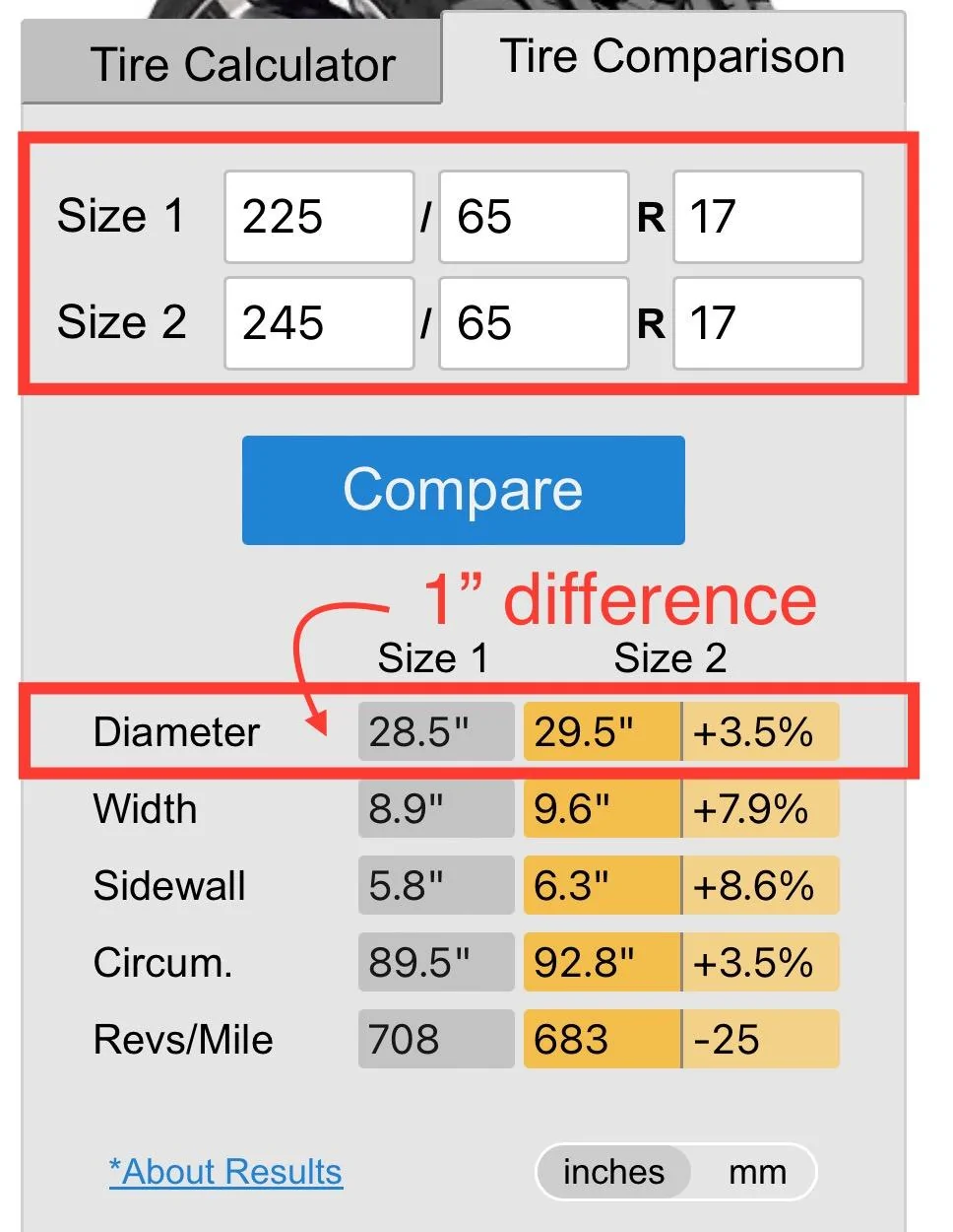

225 and 245 are the width profile of the tire. They're effectively the same diameter at 65R17.
The difference between 225/65 and 245/65 tires is a full inch. That is pretty significant.

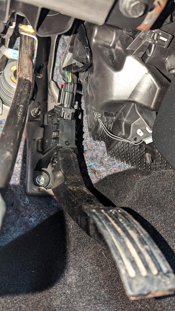

It could also have an aftermarket Throttle Controller on it like a JMS Pedal Max or Banks Pedal Monster or a Pedal Commander. I have the JMS Pedal Max on my BB BS with the 1.5 Eco Boost and it made a huge improvement in Throttle Response compared to how it was stock. It made it much more enjoyable to drive.
I'll get down there and check it out. Should be easy to see if anything is plugged in.

As mentioned above there is about an inch difference in tire size which may not significantly throw off the speedo but my concern was the long term difference it would cause the odometer.
When I added BFG KO2’s in 245/65/17 I had my speedo recalibrated to make sure it was reading properly to avoid losing track of the actual mileage of the car.

The difference in tire diameter from 225 65R 17 to 245 65R 17 tires in speed works out to 1 mph at 25 mph and 3 mph at 90 mph. I've had 245 65R 17"s for over 30k miles, for me, its not a problem to be concerned about.
