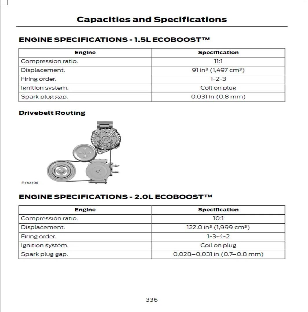

I like to stick with Ford Motorcraft, so the SP550X it is, but can anyone confirm for me the manufacturer's gap and has anyone had any success in shortening it?? Google has a variety of answers on the SP550x "factory gap", but since my Mustangs plugs always come plus .30, Im guessing the same for these?
And on the Mustang, I'd bring it down to .27 and had zero problems. I see some online shops advertising a .29 for the 2.0 engine. But I'd like to hear from people who've done it with the Badlands. Anyone here do this or have you replaced your plugs and can offer some insight on your experience?

Thank you sir. That is much appreciated. Excuse my laziness in pulling it up.
Now, has anyone here actually gapped these plugs at .28? 🤔

I checked the gap suggested by the NGKs I used (to replace the Fords that were in there) and as usual with NGKs, they were spot on at 32. Runs like a champ
Thank you. These are the types of experiences I was hoping to draw out. People who've swapped them out already by themselves. I'm getting a set of Motorcrafts on order soon. The gaps are usually fairly solid from factory, but its always worth checking.
However, I did have SOLID success in shortening the gap on my Motorcraft plugs for my Mustang 2.3, and was wondering if maybe someone else has tried shortening them all to the low level of .28 as indicated by the screenshot that @cprcubed so nicely put up??

I would probably just go with the .028.
For what it’s worth with my focus ST calls for .026 can’t remember if that from the manual or from my tuner. So
.028 sounds reasonable to me
It does. I just like to hear success stories that give my insides warm and fuzzies before I play with something as benign, yet as critical as the spark plug gap. 😂
